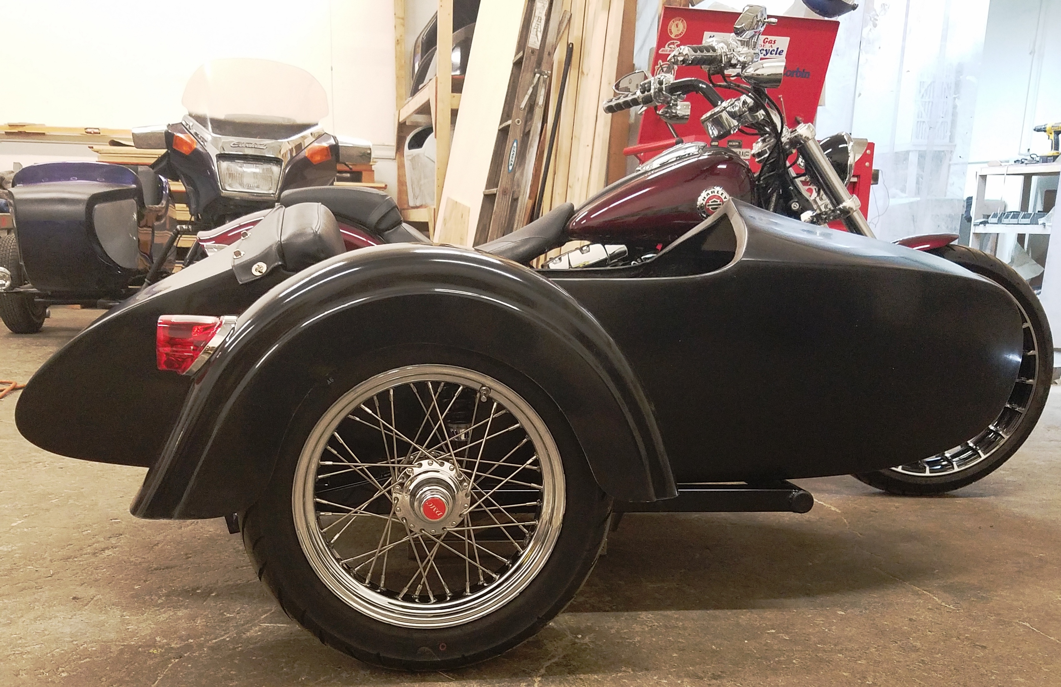

We make our frames out of 1.75 .012 tubing. This allows us to slip 1.5 .012 tubing into it which allows us to make the mounts fully adjustable. No need for it to be DOM, welded seam is less money.
On our web site are DYI frame kits which is another way you could go, they also would show you how our simpler frames are made.
You could just buy our Classic sidecar.
