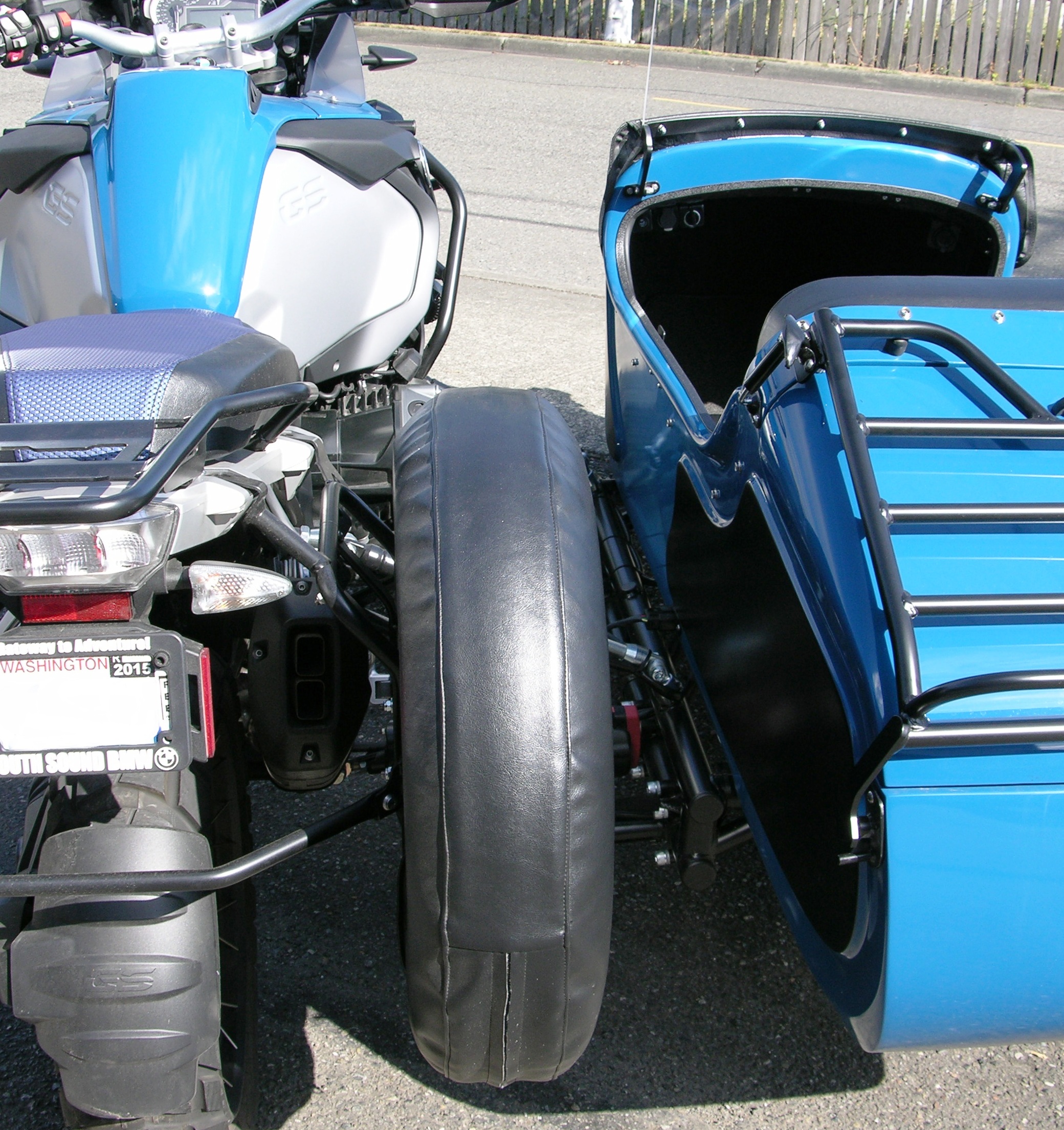

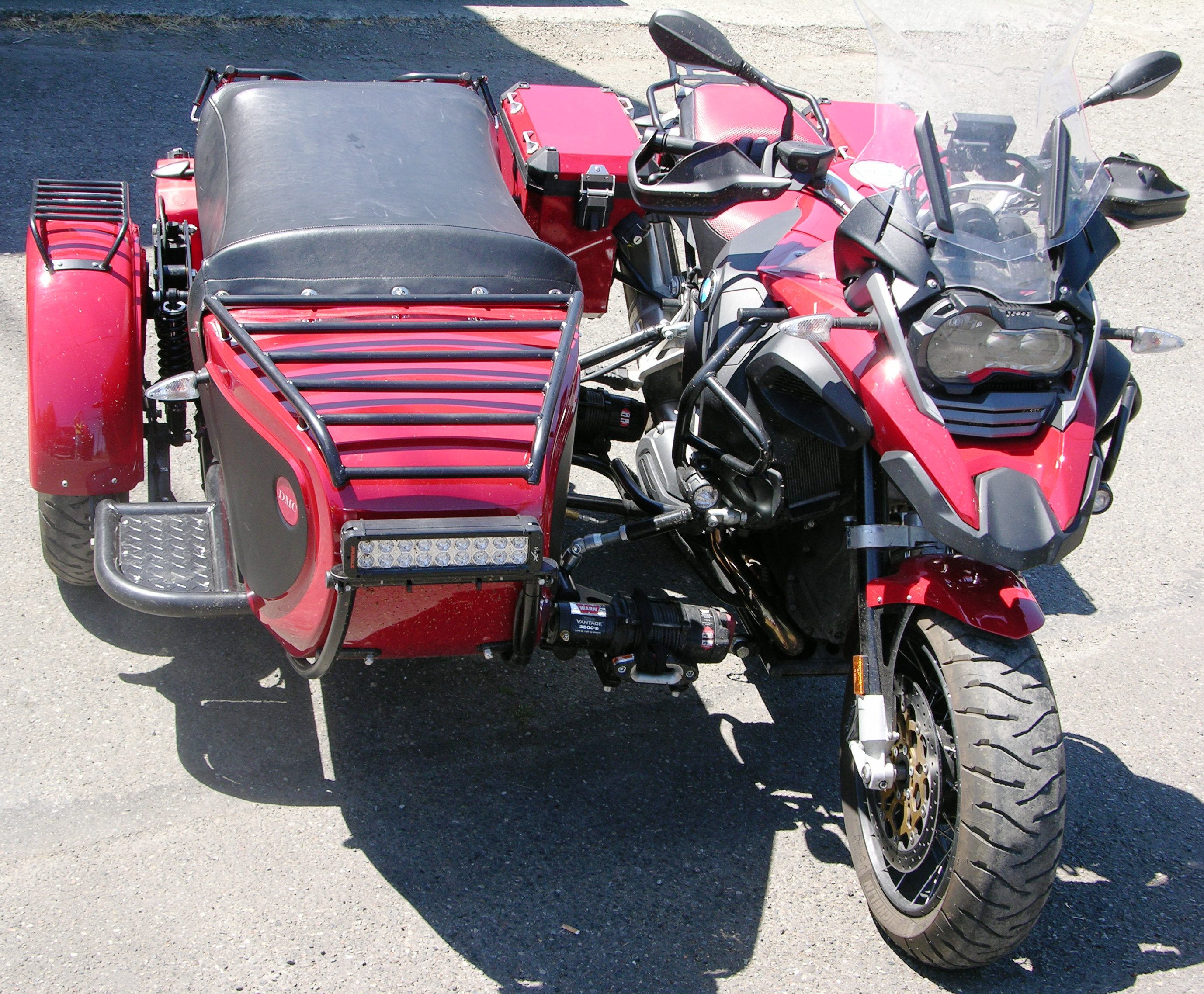

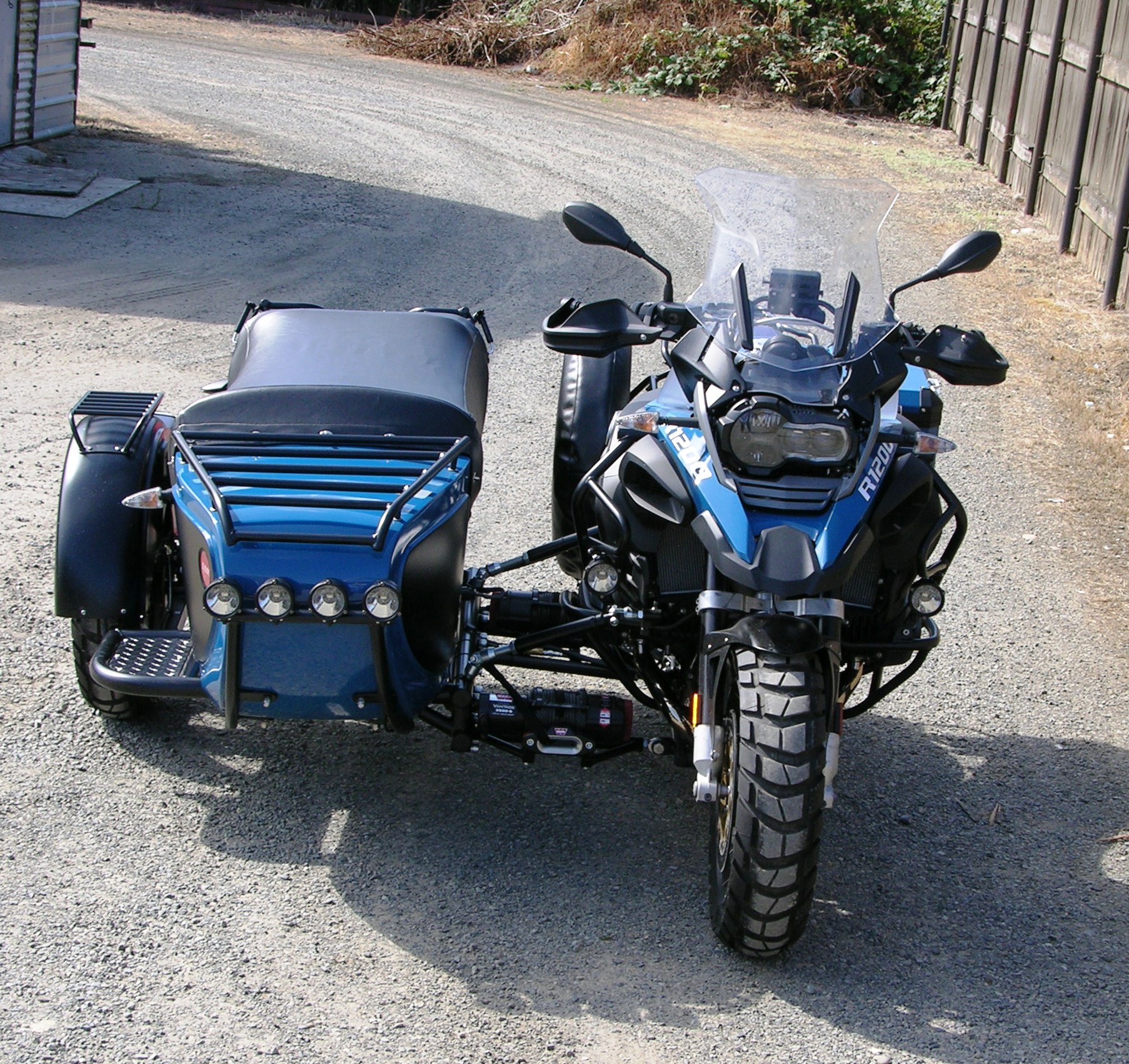

I think you will find that 2wd have little real world use on your rig. It adds a lot of weight and complexity for very little gain. We can add it to the R1200GS or the water cooled R1200GS but do not have a set up for the R1150GS. What you really get with 2wd is bragging rights, a lighter wallet and stuck about 50 feet further on then if you did not have it. For me going around the world I would not want the complexity of the system. On the Ural 2wd makes some sense as the bike is over weight for its power on very skinny tires with limited ground clearance and suspension travel. On the Black Dog Enduro several years back I was on an R1100GS with one of our 72D sidecars, at the end of the event the sidecarists were discussing the event, one after another Ural owner spoke of a bad section on the course that they needed 2wd, After a few people spoke I finally figured out where the bad section was so that when it came my time all I had to say was, "more throttle" One thing I did do on my own bike that we can only do on the water cooled GSA is make all three wheels interchange such that a spare wheel will fit all three positions, I feel this is worth doing on a RTW bike much less so on a bike that stays in the first world. On my bike and many customers bikes we have added front and rear winches, I come along would also serve well for much less money.
