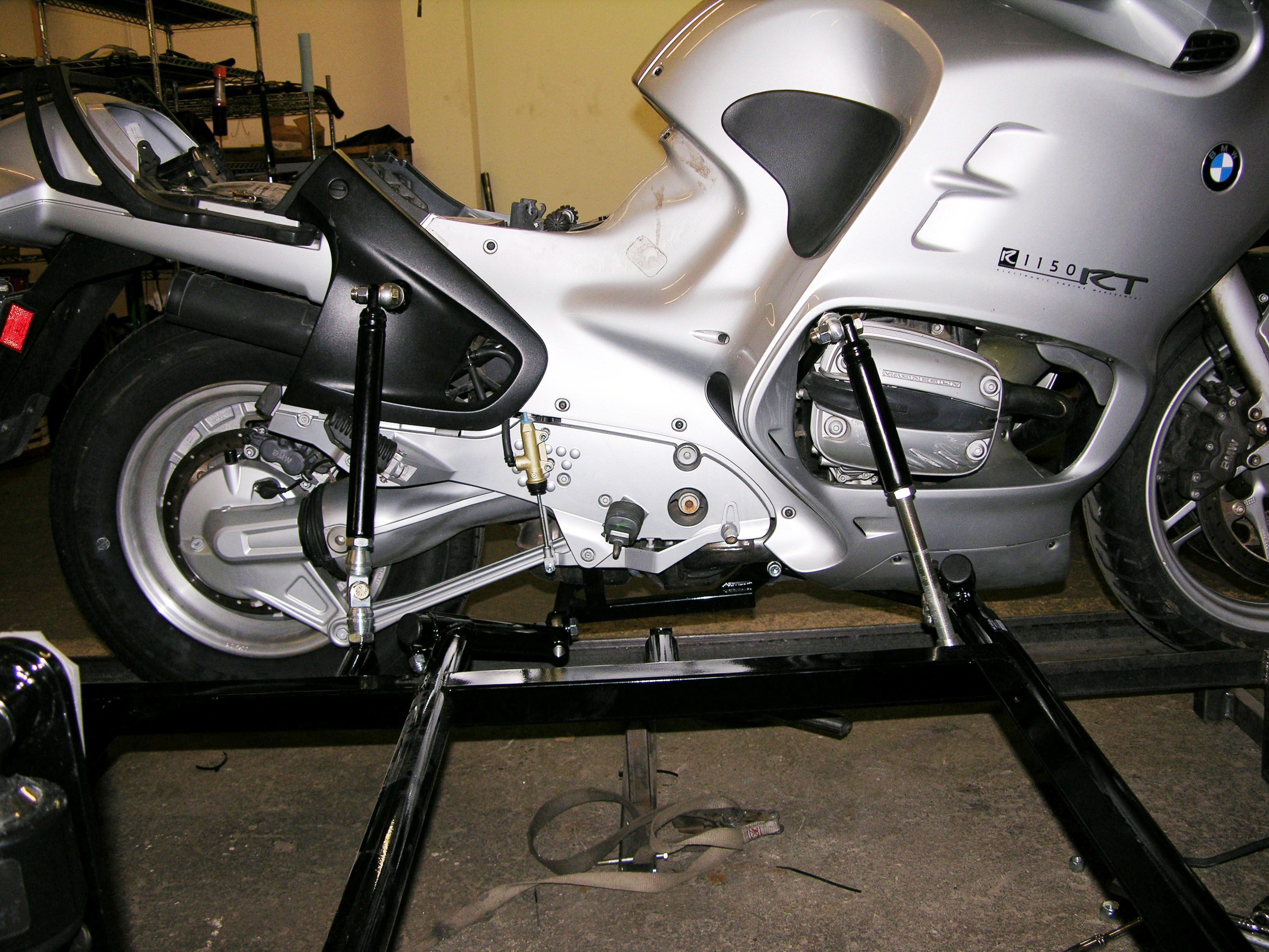

We have mounted many sidecars to bike similar to your, plenty of power and works well. We offer bike specific mounts that come with our sidecars. For your bike the mounting system is very clean with very little trimming of plastic. We would need to know that the bike is an RTP not a RT as the mounts are slightly different due to the police crash bars. For your bike we also offer steering modification for lighter steering. Your bike is one of the least expensive bikes to modify the steering at only $350 for the parts. If you are going to put a lot of miles on the bike we also offer an automotive rear wheel for the bike $1295. While I have never owned an RT I have owned several R1100GS's and have found that they work out very well as a sidecar bike, power is not an issue, we even set one up with a sidecar to also tow a tent trailer on a long trip, for that bike we changed the final drive out to one from an R850R. Nice to do but unless you are pulling a trailer I would not change the final drive out unless yours fails.
The last photo is of a Kenna double frame being installed. For some reason I could not find photo's of it finished with the body on it.
