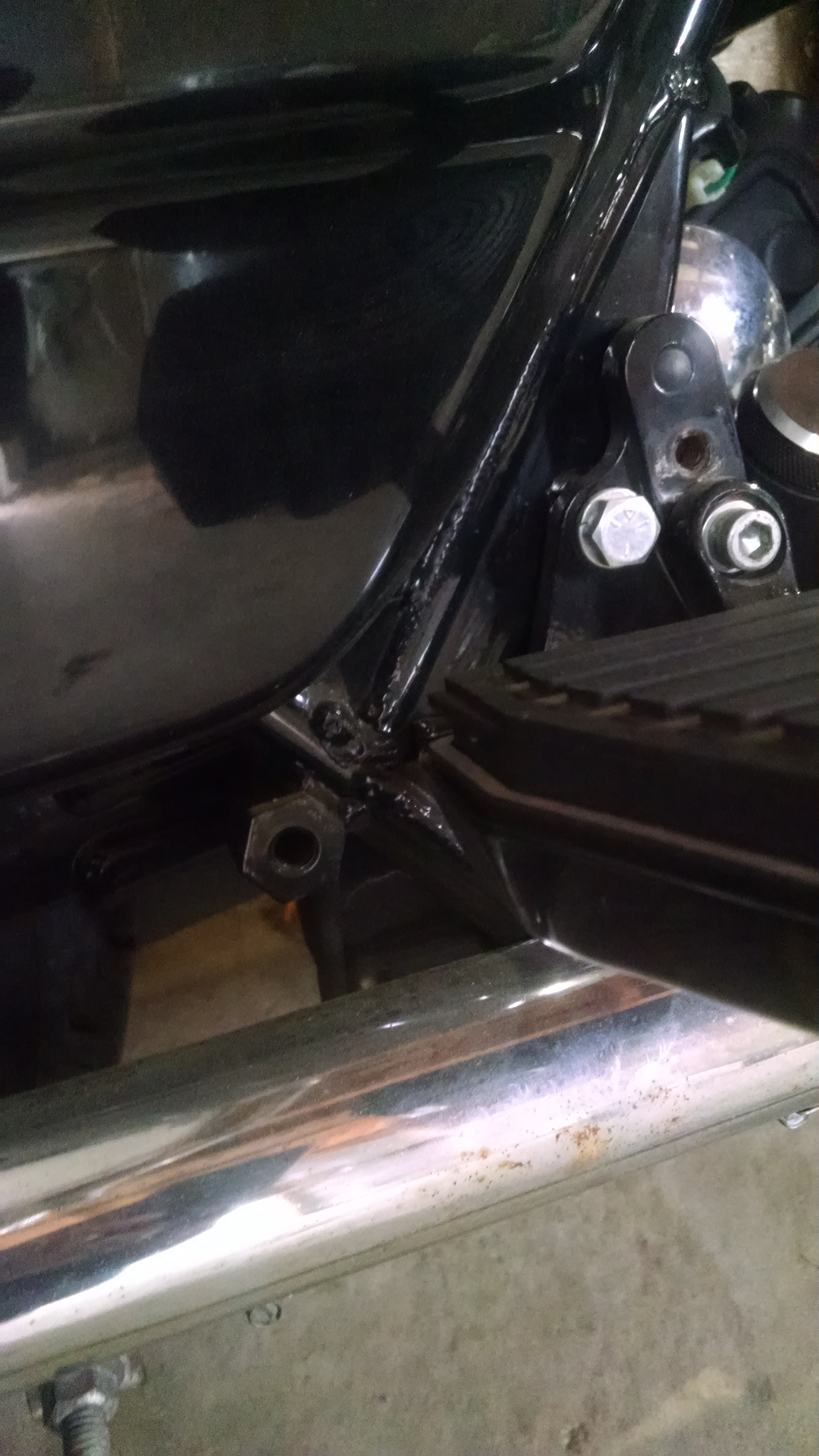

I am not an expert on HD sidecars however in 2003 Harley dropped a fitting on the side of the frame on the bike. This fitting looks like a large nut welded to the frame. This was for the sidecar to attach. So the sidecar from the 1998 would have been set up to attach to this mount while the newer bike will not have it.

(@davet)
Posts: 196
The newer rear mount does not use this additional bolt hole. The older rear mount uses three bolts, the newer one uses two. There are pictures of the newer rear mount in the PDF files above. The attached picture shows the fitting Jay is talking about. This picture is of my 2000 FLHTP (no sidecar attached).

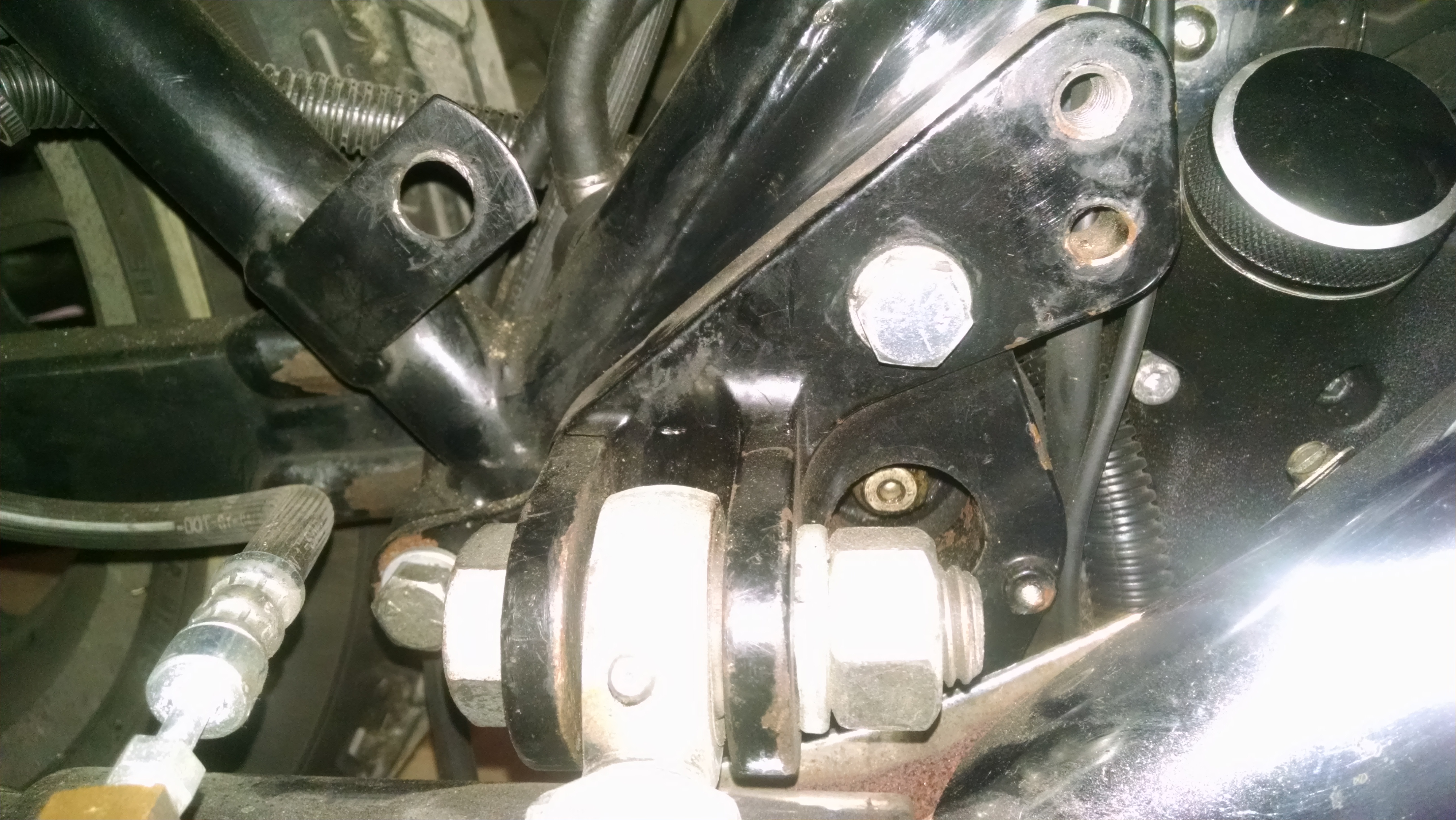

(@davet)
Posts: 196
Here is a picture of the older style mount with three bolts. The third bolt is down low behind the exhaust pipe so you can't see it. The passenger footboard is removed to make it a little clearer. The bolt to the left of the clevis and rod end is the bolt that goes into the tapped hex fitting welded to the frame. The sidecar rear mount replaces the existing passenger footboard mount. This is my 1993 Tour Glide with a 1996 TLE sidecar.
