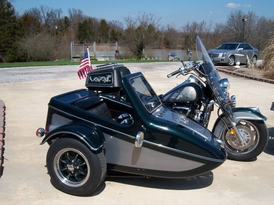

I am running a car tire on the rear of both of my 1500 Intruders the hack and the solo bike.....ride is much smoother and braking too...
Posted : July 27, 2008 6:17 am
hey Wally, Beth,..what I was noting was that tire pressures with car tires, should be checked as closely, or more so then the bike tires,..the tire is designed for a car,...not a bike, so as mentioned earlier here, the bead and set may leak/seep air more then a bike tire, also the side wall is not designed for the stresses of tilt cornering the same way a bike tire is, a bike tire is thicker and curved for a specific load and repeat stress forces,..I find that with 30-32psi in the car tire, as car tire recommended,.. the bike handles like it is on ice as the wall doesn't give and the tire slides excessively,..drop the pressure to 8-14psi, and the tire grips the road without tread slip, or peel off,...your rig may react very differently,...also I remove my car often, and pulling on the bars is very heavy to crest the edge of the tire to corner at an angle, and the bike is rather loose through the apex ..just be advised that your handeling and general bike dynamics will change from what you are used to,..a "sweet spot set-up" will have to be found for your comfort level, and to maintain firm feedback through the bars. with or without a car in place, the dollar value, tread life, and livable short comings made it a good choice for me,..others will disagree, but it was better for my rig with or without the car, hope it helps, cheers, crawf. ps. I have over 25000kms on mine and still looks new,
