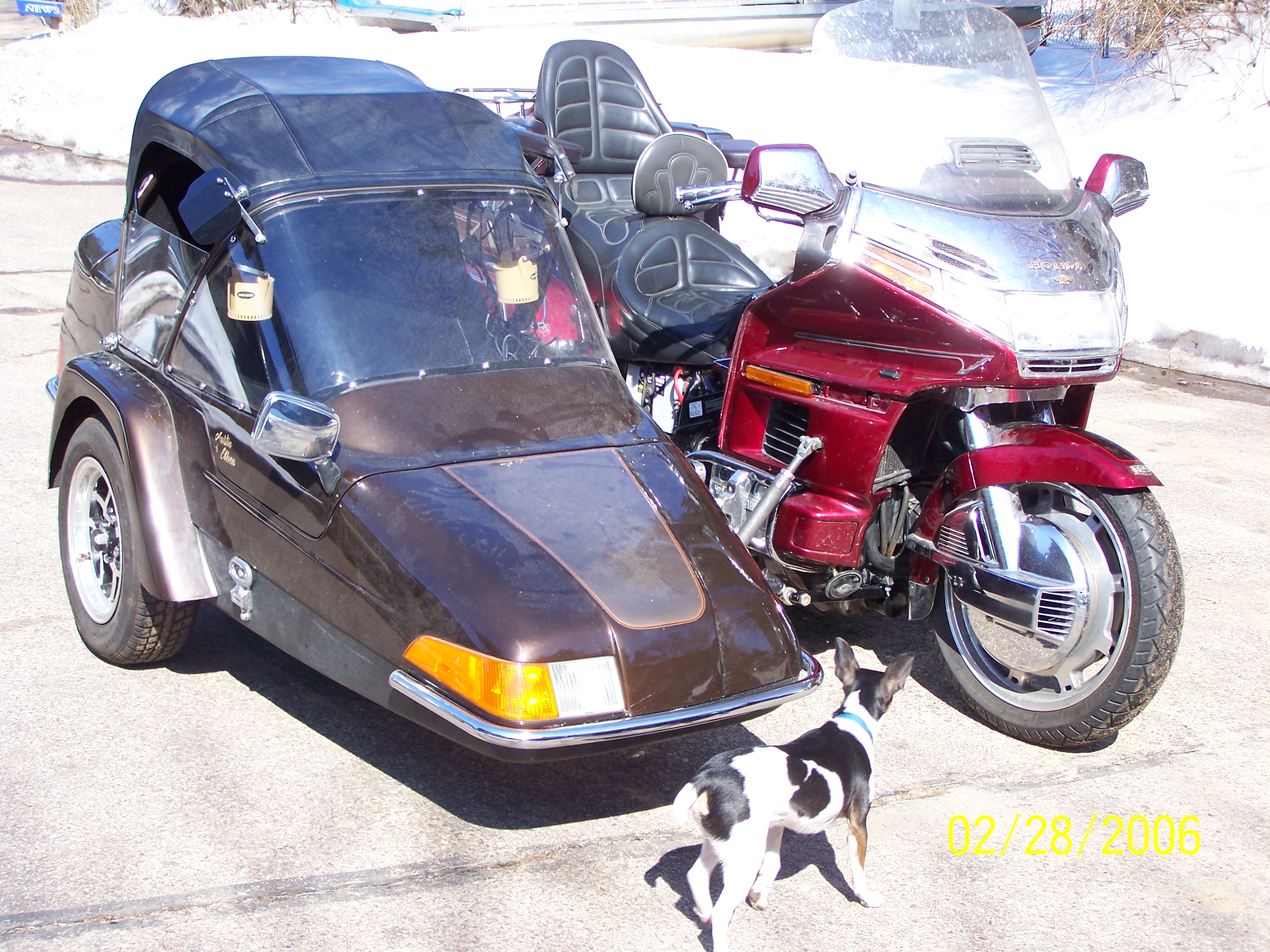

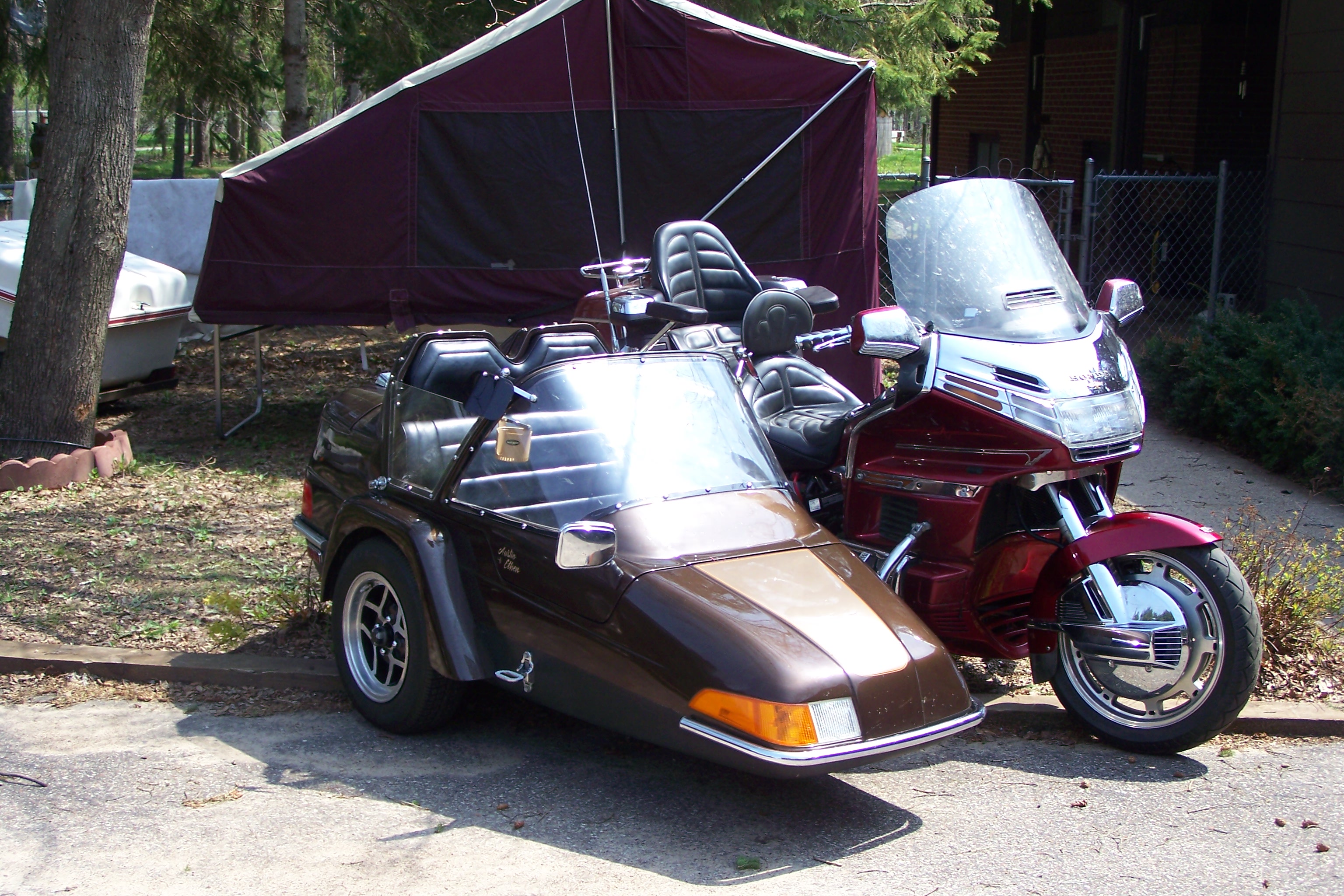

Often when told it is a "Factory Installed" outfit, they mean the manufacturer installed it. If that is the case, CSC would have installed one of the Power Trak systems if something was done to the front forks. The power trak forks are about 6 inches longer than a stock 1500 would have.
Original forks in first photo
PowerTrak in second
