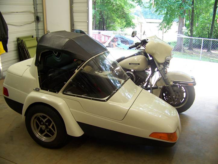

Thanks Sven! A WHOLE lot more to setting up this sidecar then my Harley sidecar but I have no fear I will get it. He lives 35 miles from me and once I get it drivable I will bring it up to do more on it. I do not like going to others house as they never have all the tools I need and here I do. Here is a picture of his rig that I did list in another thread. Old police bike.

Space for the foot! good point, reminds me to the Ural. You adjust your body to the bike, not other way round...At least that seems to be russian philosophy.
