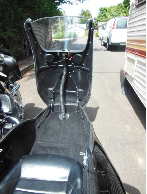

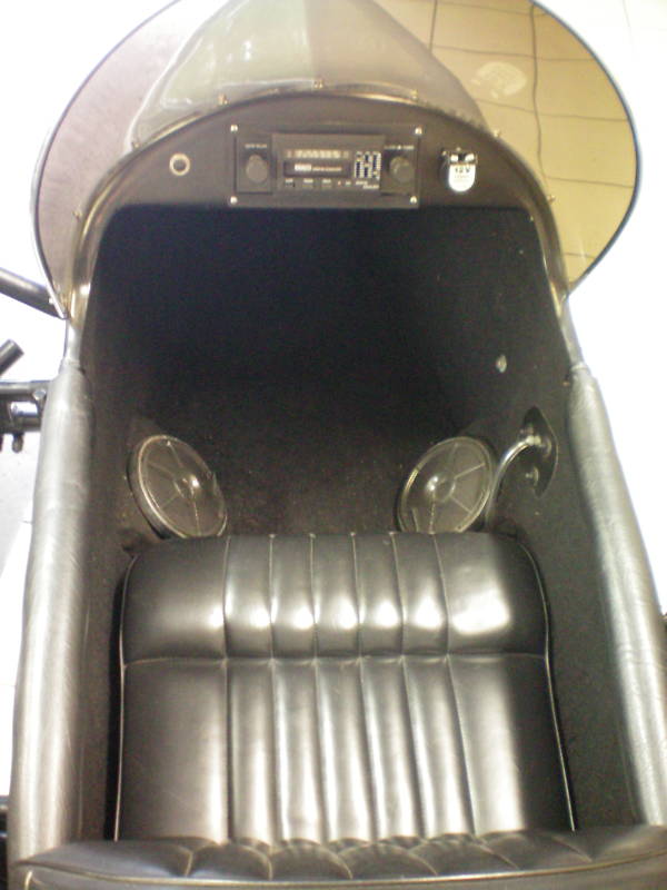

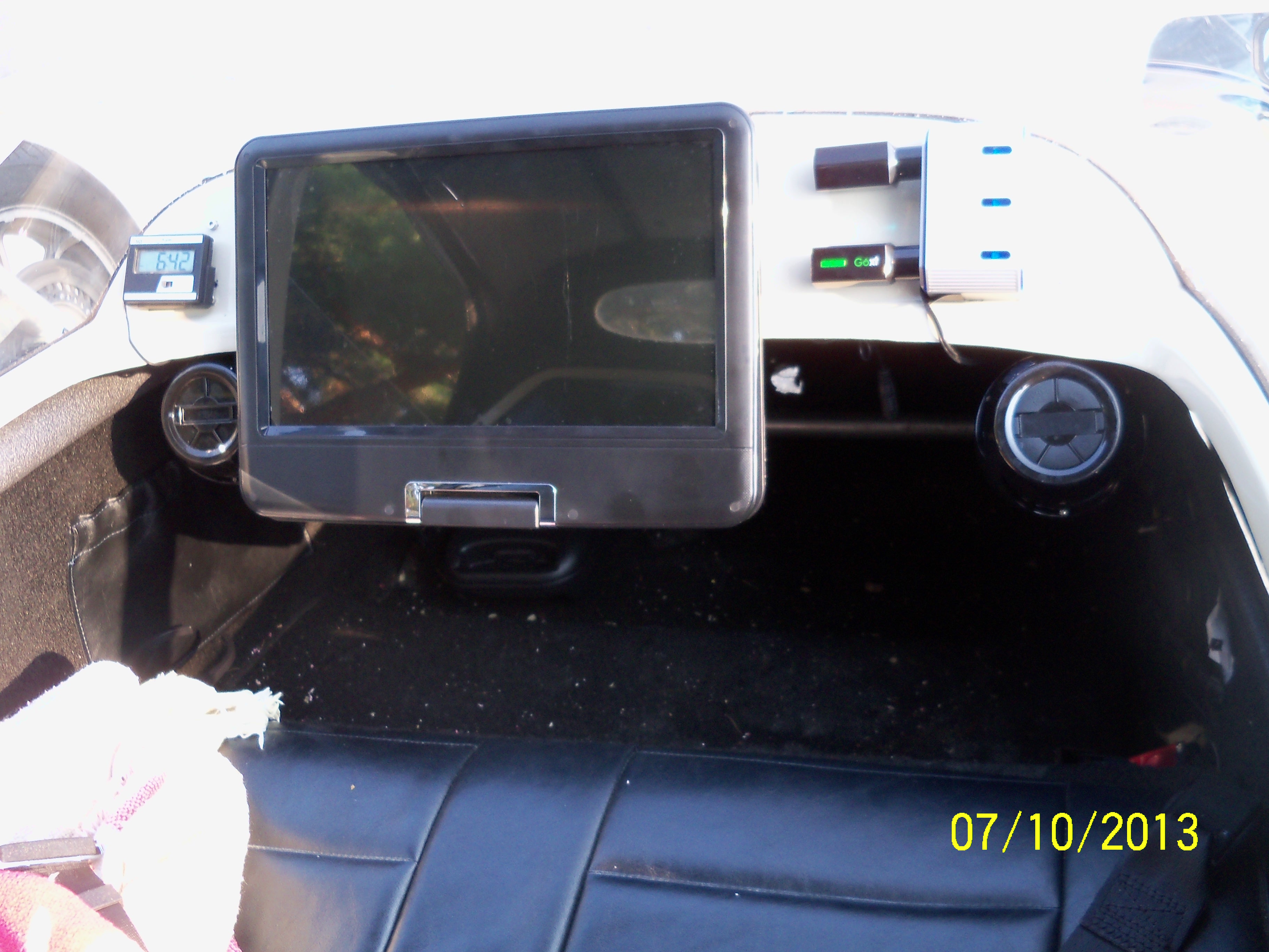

The CSC FS II speakers go on each side of the top of the dash, same as on the FS I. Hope these pictures post.
Posted : July 18, 2013 6:07 pm
yes they do. Thanks .do you have Pic from bottom ? that is what I was confused about. those cup looking things . is that just to hide speaker bottom from inside ? again Thanks for all the help..

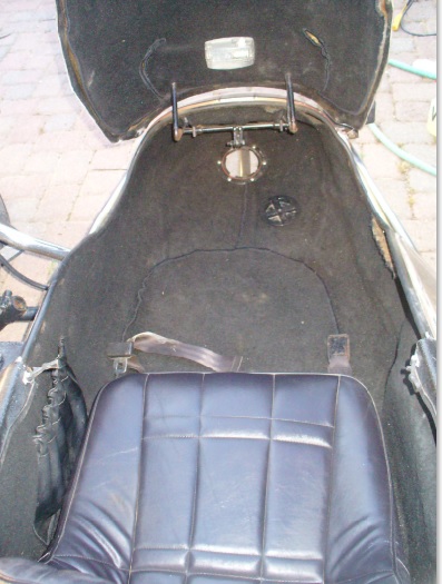

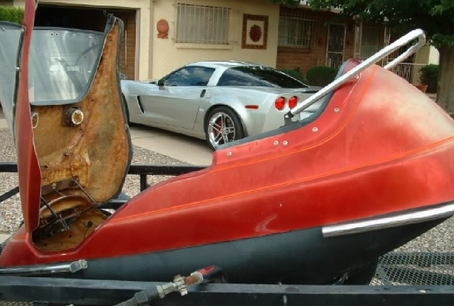

Here is a picture of the under side of the FS II speakers & hatch. The other picture shows how Champion mounts their speakers on the floor of the Legend Sidecar. The last picture shows the FS II SE speaker bottom cover.

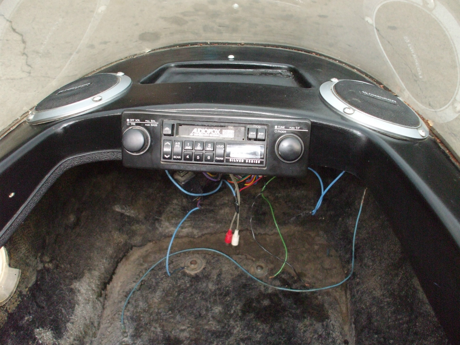

I did not mount the speakers or radio. I believe the picture shows how the CSC factory installed the radio in the dash as every FS I & FS II I have seen has it mounted there. The air vent tube on the FS II SE goes up to a vent on the dash to blow on the passenger. On the FS I & FS II the air vent is just on the floor in the nose.
