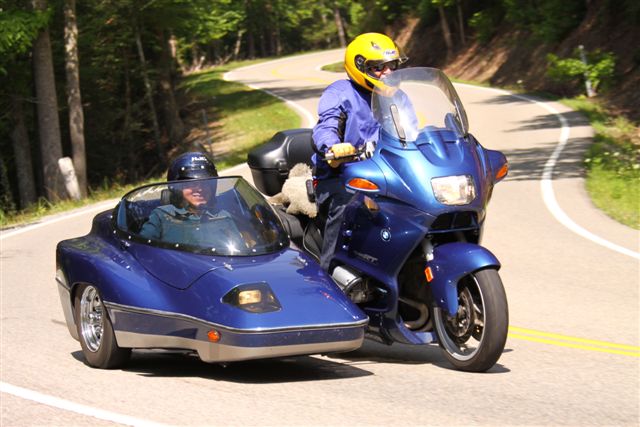

(@fhunteman)
Posts: 15
I also have an R1100RT with sidecar. It came with a steering conversion when I bought it used. I will attach a picture, but it looks like all it requires is fabricating a couple of extensions to move the lower mounting point forward at the ball joint mount. I think the previous owner also replaced the shock as well. I do not know what conversion this is, but I think Hannigan did the rigging of this rig. It handles great.

(@jrapose)
Posts: 96
Wow...my bike looks like yours...same color...I have a Armec Tramola 1 on mine...
I wrote to that Danish company that makes the adaptors to move the ball joint back.... looks just like the one on your rig....perfect...
it looks like the ball joint is further back on yours than just swaping out the mount with a R1100GS mount....
