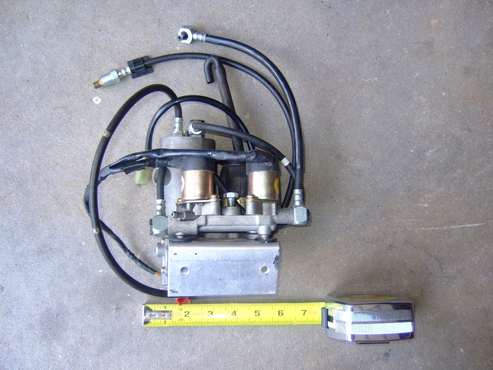

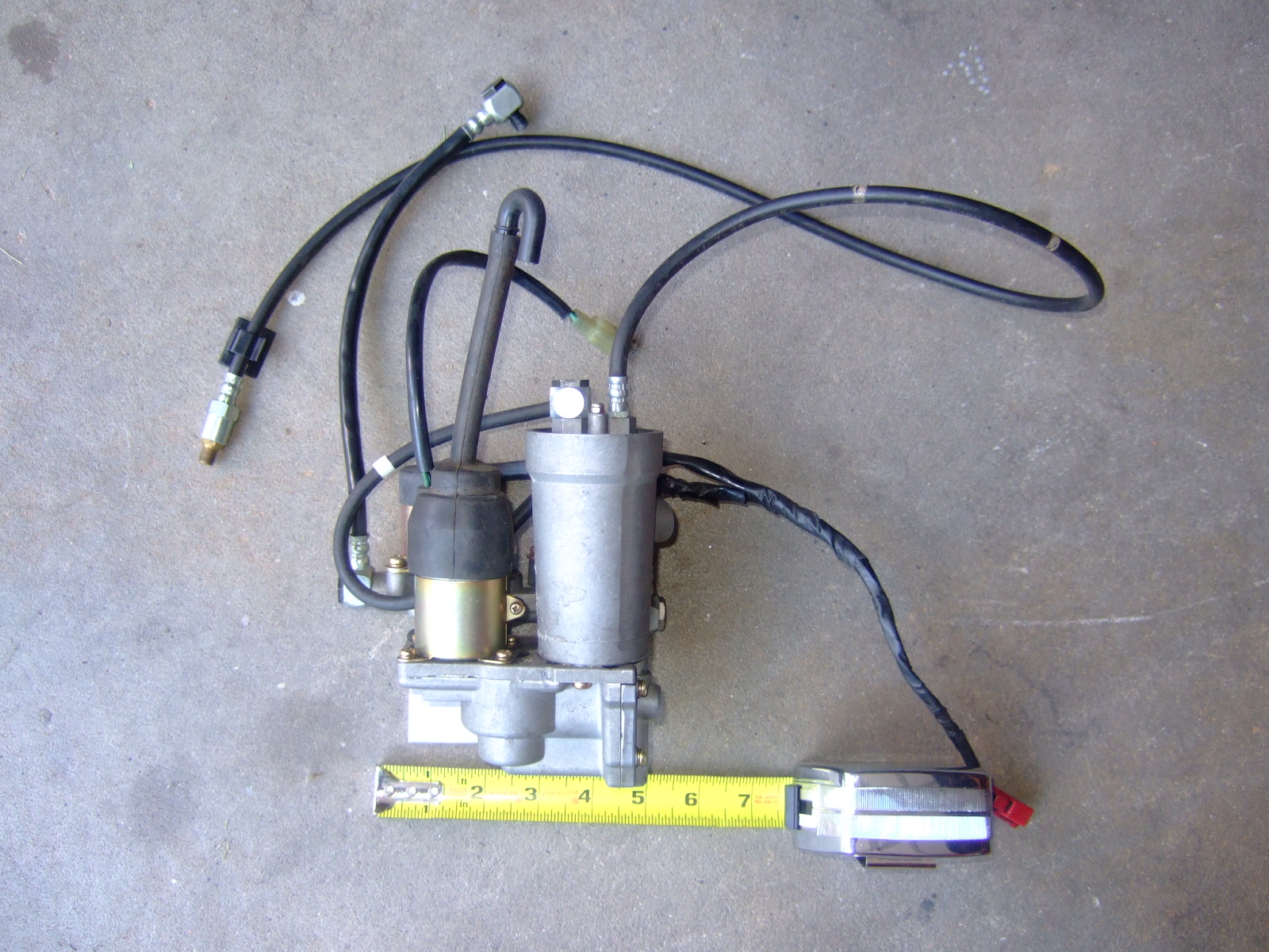

I have a Showa compressor for sale. Ideal for suspension. $50. plus shpg.
nwsidecar@aol.com
208-629-8409
Posted : April 18, 2013 6:57 am

Hey, Lonnie, I'm interested in that Showa compressor! Wondering what max psi and is it rotary vane type?
If it's enough pressure for my needs I'll buy it beginning of next month, like the 3rd or later? Thanks...
[If psi is good for my needs I'd send you a deposit in the meantime if agreeable, had some unexpected expenses this month so a little lean right now]
Posted : April 19, 2013 7:24 pm
I know little about the Showa compressors except it was installed on a restored Terraplane sidecar I purchased from a Boeing engineer. It was going on his Harley but it got wrecked before the sidecar was installed.
Posted : April 20, 2013 4:37 am
Okay, thanks, I'll see what I can find out.
Posted : April 20, 2013 5:45 am
Hope I didn't cut anubody off on Lonnie's compressor? I had thought everybody else that posted was already good to go on their systems but apologies if someone else was interested first.
I couldn't find info on it. It looks rotary vane, rather than piston or axial. Industrial rotary vane are capable of very high pressure but with that intended for an air shock system it probably won't work for my needs. Thanks, Lonnie, might holler at ya later on it.
Posted : April 20, 2013 3:24 pm
