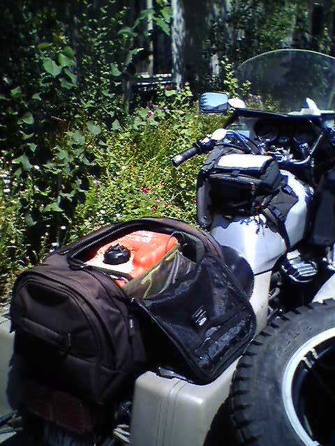

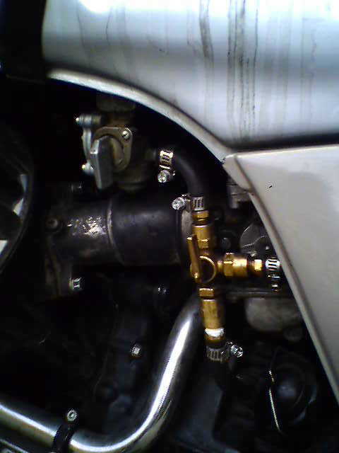

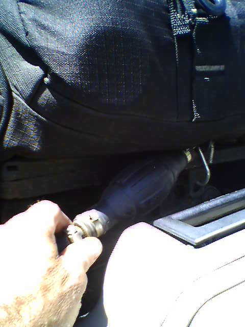

I did mine a little like Bob in Wisconsin. I bought a plastic 3 gallon marine fuel tank for about $25. I put a "T" with a shut off valve in the stock fuel line between the main tank petcock and the carbs. I added an external siphon bulb to the outside that I can reach and activate on the fly. I tried painting it to match the bike, but it immediately peeled off. I then found a gym bag that was big enough to fit the tank and hid the crummy paint job.
The bag gives me back some of the lost storage for things I don't mind smelling like gas. I also modified my main tank to hold 1 more gallon. I carry 9 gallons of fuel now. It used to be 5 gallons. I recently did a 150 mile back country ride without stopping for gas. I drove around doing local errands for a couple more days before filling it back up.

Here's an attempt at posting my tank pic.

With the tank behind the seat, gravity does all the work. If I put the tank anywhere else, I would have to run a fuel pump. As it is set up now, I can remove the tank and put on the passenger seat in about 3 minutes.And as I mentioned before, it cost under $30 for parts. Of course my time is never a factor, this is my therapy.
