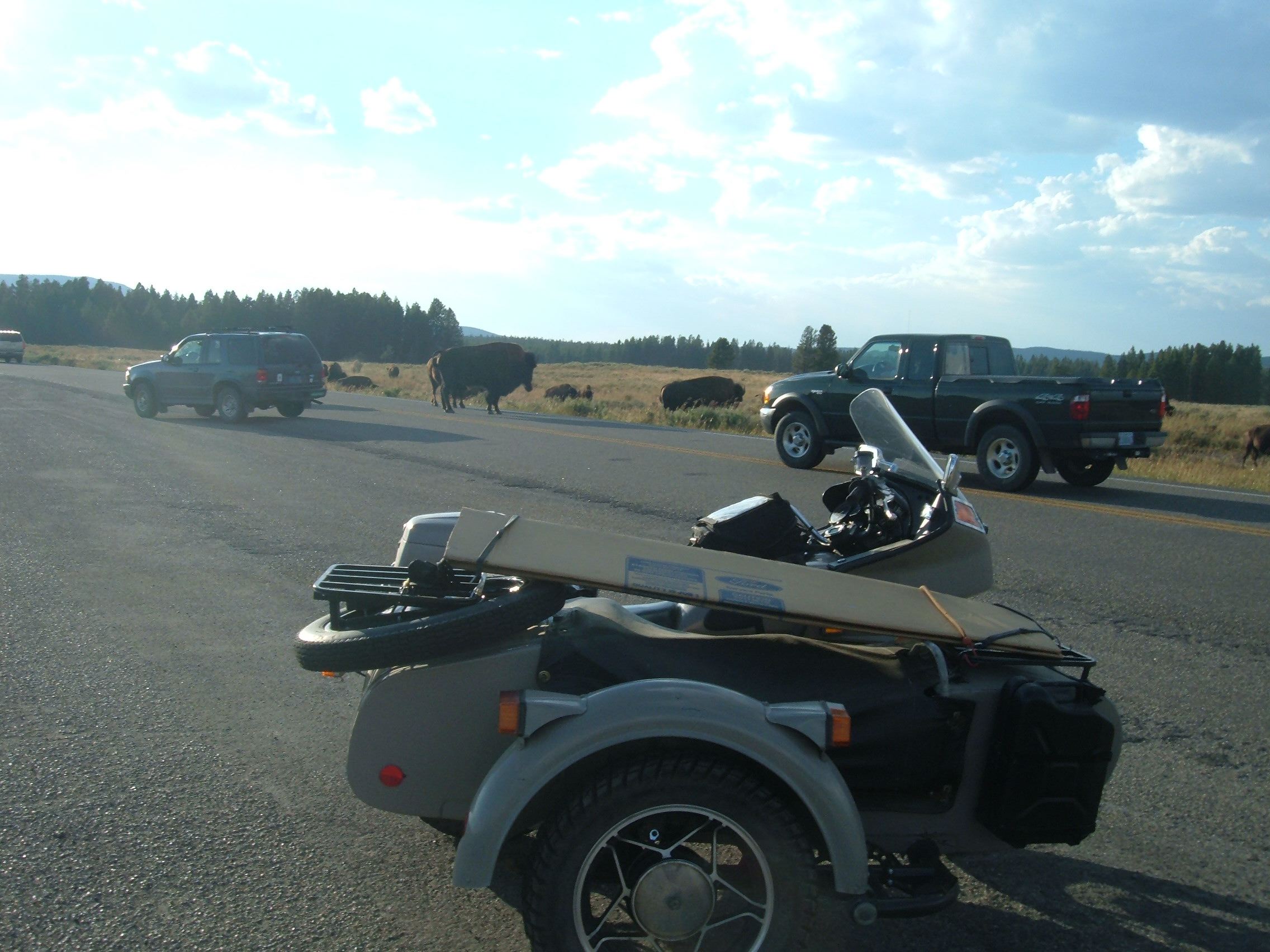

I have used my sidecar for skiing before, thats easy. I also use it to install custom fire screens. This rack could easily handle a kayak with a mountain bike beside it.

wow, that looks like it would go anywhere! I like the older military-ish look. maybe a dedicated rig would be worthwhile. it might be a decent way to make my 850 safer too, and skiing would be fun 😉
but I think what I'm thinking about would be a vastly trimmed down version of a sidecar. maybe even just that rack on a wheel!
how much could one get away with, maybe a beam perpendicular to the bike that has the wheel and a supporting member or two fore and aft? what sort of stability problems do you encounter with a flexible sidecar? would they be less if it were very light, sub 150 lbs? does anyone have a good explanation of how they articulate?
like I said I wouldn't intend to use it for people and would probably want to be able to remove it relatively easily.
