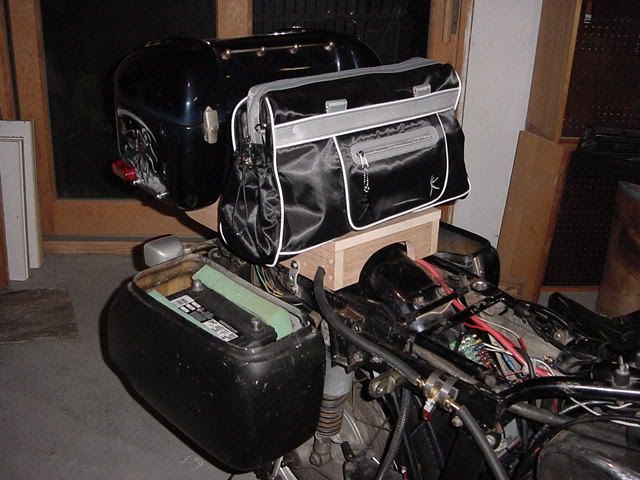

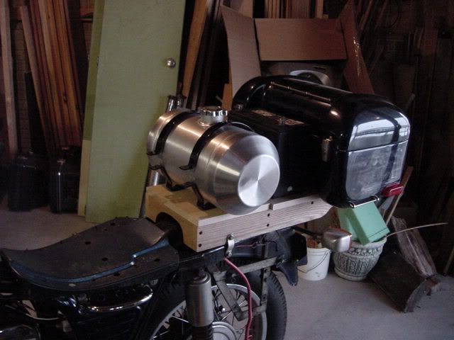

I cut my seat short to make a solo saddle , As I dont ride passengers on it. Then I made a new rack that extended to the back of the solo saddle ,and mounted the tank there, between my seat and the trunk on the bike. fuel lined go forward right into my original fuel lines. just open a valve below the seat there to allow the extra gas to go to carbs.If the bikw is parked with all valves open, I can fill my bike tank from the tourTank if I want.gravity feeds the gas into the bike tank.
then I put a tote bag over it to conceal it. looks like I have a pack on the back seat ! :o)
I also put my auto battery in my right saddlebag.
