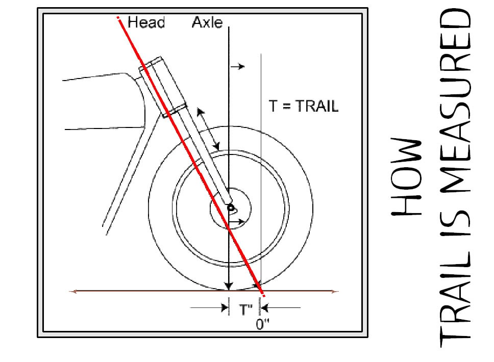

Originally written by Uncle Ernie on 2/11/2008 10:24 AM
I've been hearing about these triple trees for a long time, but never asked;
Does this make the wheel base longer or shorter?
Longer Ernie. See attached picture on how trail is measured and it will make sense.
These discussions can create some confusion due to the use of the word 'rake'.
There is 'rake ' which applies to the steering head angle and there is 'trail' that more or less equates to what caster is on a car. The two work together.
On a sidecar rig 99.9% of the time we do not change the rake but the trail to get easier steering. To do this we may go to a leading link or to modified triple trees amoung other things. The modified trees are many times referred to as 'raked trees' which has nothing to do with changing the actual true 'rake' of the steering head.
Then of course there is the rake that is used to move leaves around but that is another story.
See atatched picture
Posted : February 11, 2008 2:07 pm

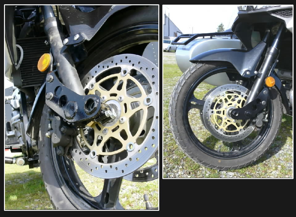

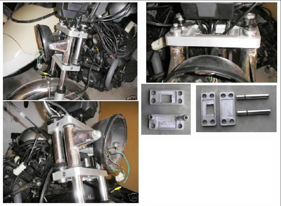

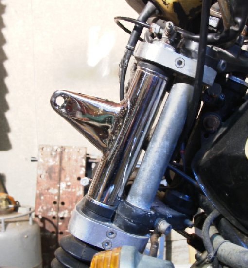

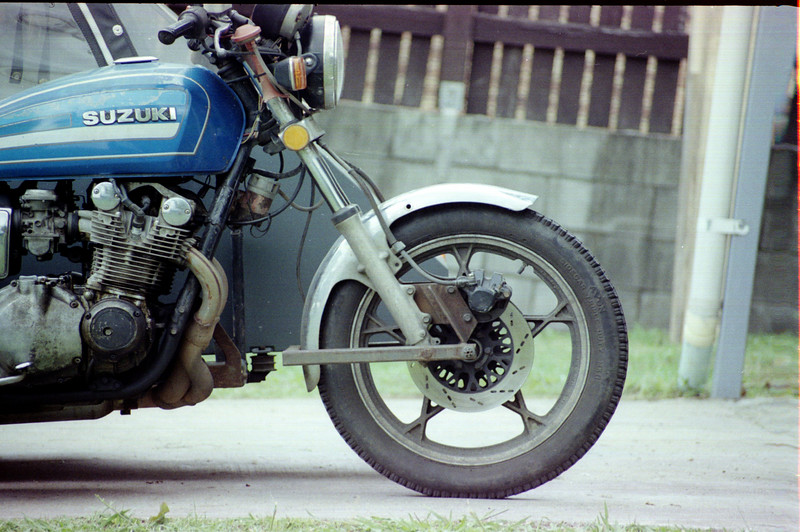

Other ways to ease steering:
* Lower profile front tire (reduces trail)
* Sliding fork tubes up farther through trees (reduces trail)
* Raising rear of bike (Reduces trail)
* Wider handlebars (more leverage)
* Move fork assemble forward with bracketry(reduces trail)(SEE ATTACHED)
* Move front axle forward with bracketry(reduces trail)(SEE ATTACHED)
* Workout a little
Posted : February 11, 2008 2:18 pm
Claude, that are great ideas and easy to do in my machine shop....

Originally written by Peter Pan on 2/11/2008 9:47 PM
The first version needs more calculation.
the second one might bend the tubes, and is a little ugly.
Both are easier then design and build a new stearing head or leading link fork.
I'll analyze that when my wife is out of reach....
Good night for now.
Sven,
When you speak of 'the first one' and 'the second one' you are speaking of the pictures and not the post itself.
Yes, some calculations are in order. I have see twop folks this year who have built leading links that did no calcs ahead of time. Both had issues because the trail was reduced too much.
If building from scratch off of a stock bike one can get by without actually getting to invloved if they know what the stock trail is. Knowing this it is not that hard to figure how far the wheel will be moved and thus how much the trail will be reduced etc.
The system that moves the front axle out in fron tof th efork tubes has been marketed under various names. Dauntless calls it 'leadeing legs'. See this link for a picture of one of theirs. It is much cleaner than th epicture posted earlier which was a home meade version.
http://tinyurl.com/2x2kv4
Note that to do any steering mods such as these at home, so to speak, can get invloved and can cause problems if not done properly. It is best to go with a manufactured system for most folks. But then again we are sidecarists right? LOL.
SEE ATTACHED FOR MORE PICS.
