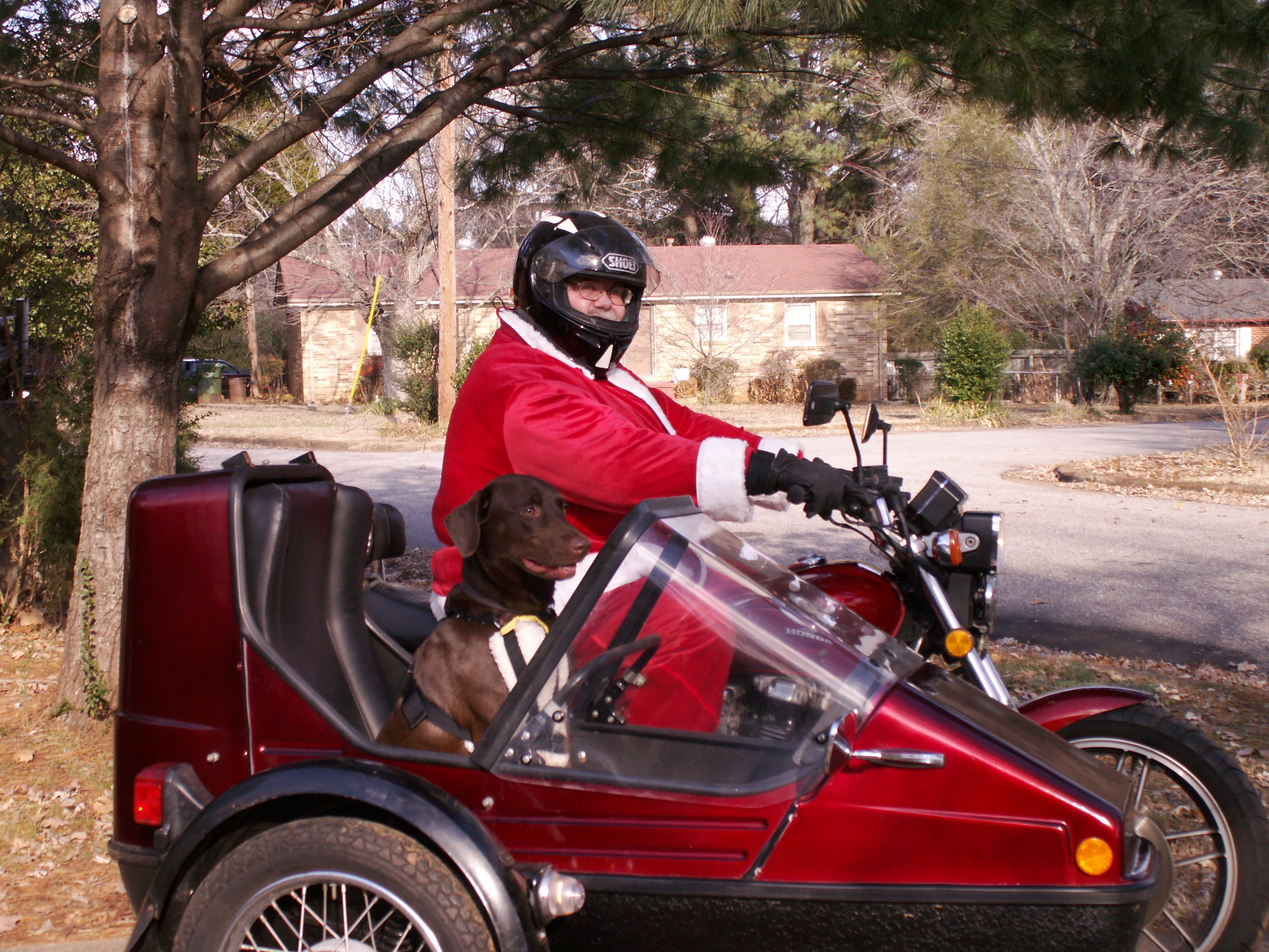

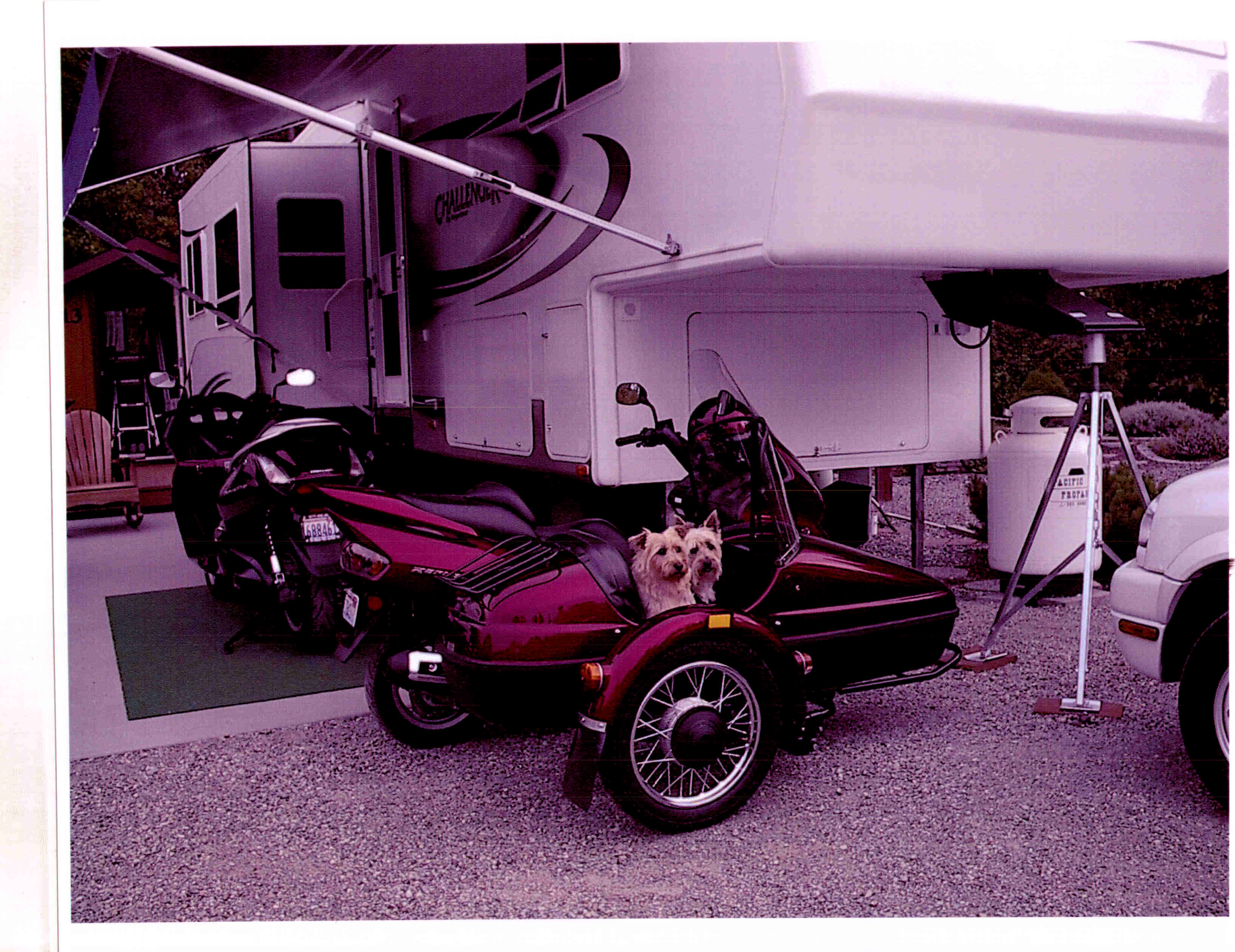

Anyone cart a dog in sidecar safely?
Posted : December 28, 2009 3:49 pm
Many take their dogs along. About 1/4 of our clients but so their dogs can come with them.
Most use a harness with short straps so the dog cannot jump out if they get excited (usually due to another passing dog). Some use two straps; one hooked to the footrest so the dog can lie down in the nose out of the weather and one connected to a handgrip or luggage rack to limit travel.
Dogs usually take over the sidecar before they are out of the driveway.
Many owners also buy "Doggles" for their pooch, goggles made for eye protection.
