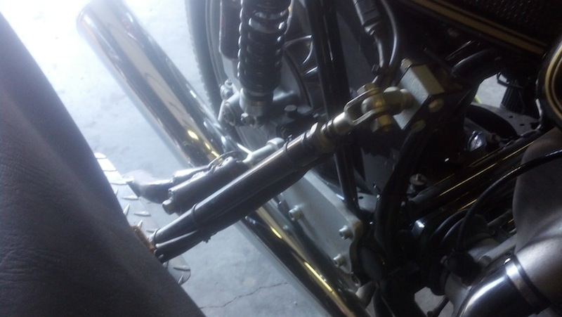

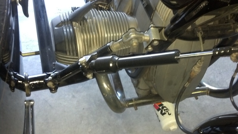

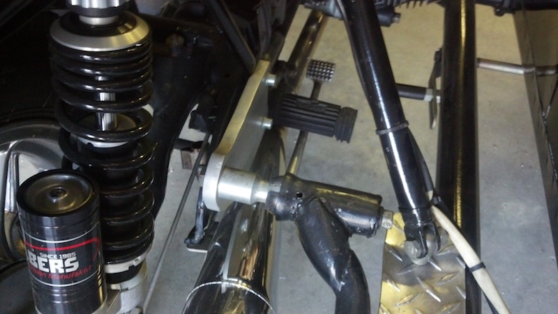

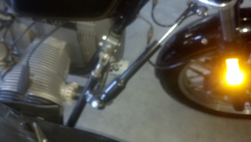

Here is a picture of the sub frame that Jay is talking about;
It is on a 1979 R80 that was upgraded to a R100S.
If you need more photos send me an email
don _ Rich @ Sbcglobal.net
Posted : January 21, 2015 7:18 am

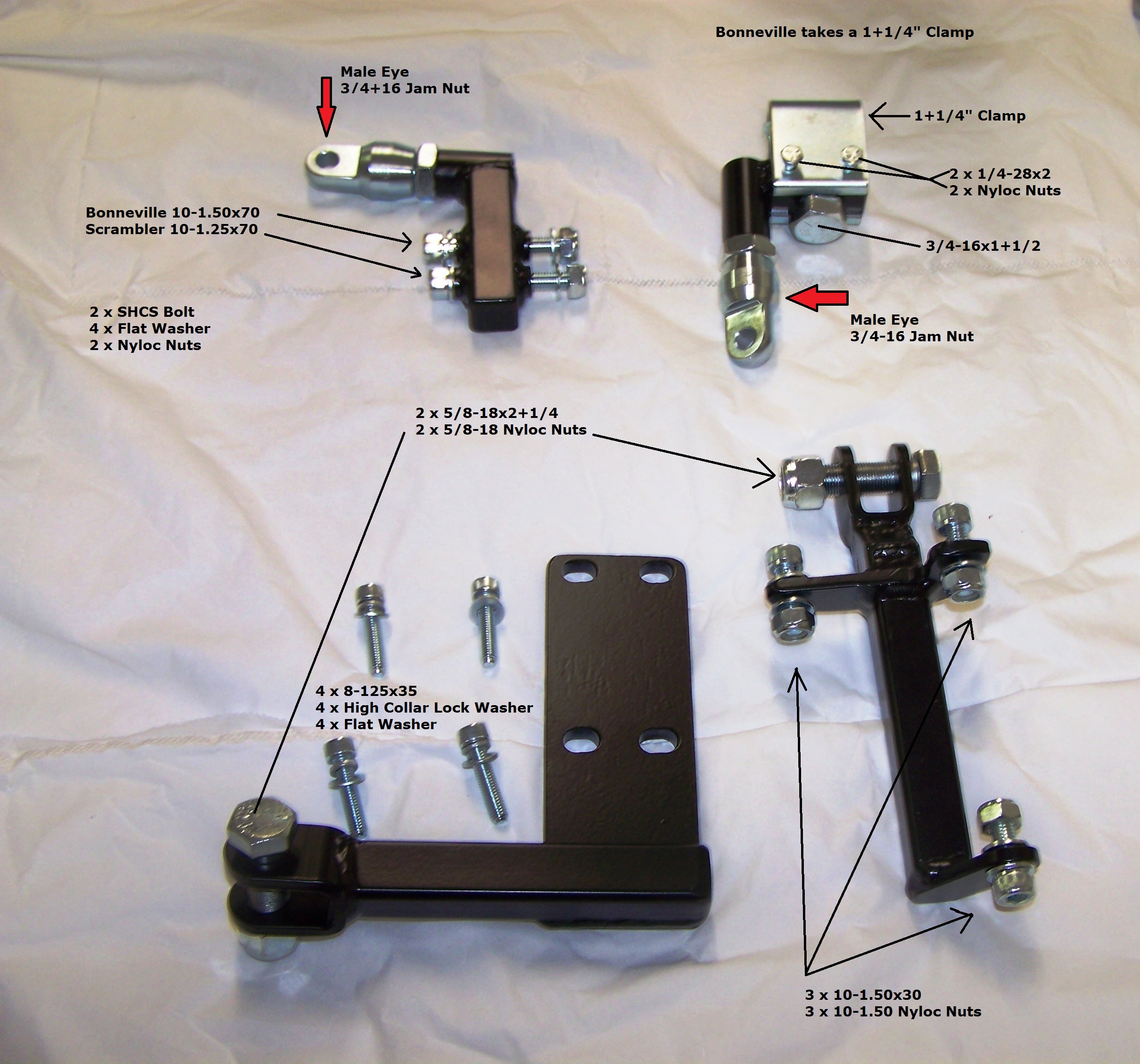

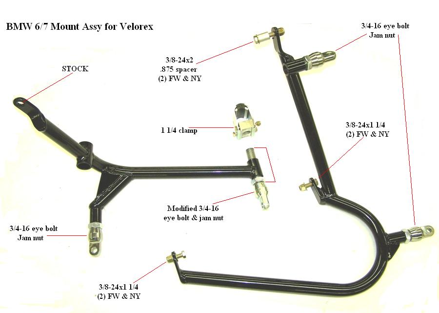

This is not our sub frame! Here is a photo of our sub frames for the BMW /6 and /7. As you can see our sub frames tie both sides of the bike together and also move the lower rear mount aft and even from the ground with the lower front mount. In the photo is also one of our frame clamps that we use for the upper front. Just going with frame clamps tends to damage the frame. In the case of the Velorex type frame clamp shown in the earlier post stating that it was one of our clamps if you look at the clamp you will see that the cross bolts are taking the load and as such the bolt holes tend to stretch over time. In the case of our clamps the strap is folded over the block such that the cross bolts are not taking the load just keeping the clamp from spreading. With the Velorex type clamps the eye bolt comes to a point and goes into a dimple on the slipper. Our eye bolts the bottoms are flat and go into a machined flats spot in our much thicker slipper. The Velorex frame clamps tend to bend the slipper and tighten down to a single point on the frame often damaging the frame. The BMW frames are also known to fail next to the clamp. In the case of our sub frame you will see that the eye bolt on the clamp is extra long and passes through the sub frame anchoring the top of the sub frame such that the sub frame can not slip nor can the frame clamp slip.
I am also attaching a photo of our Triumph Bonneville sub frame. The triumph sub frame is much more about mount placement then making sure that the bikes frame does not fail as the Triumphs frame is much more robust then the BMW frame.
Posted : January 21, 2015 8:43 am
