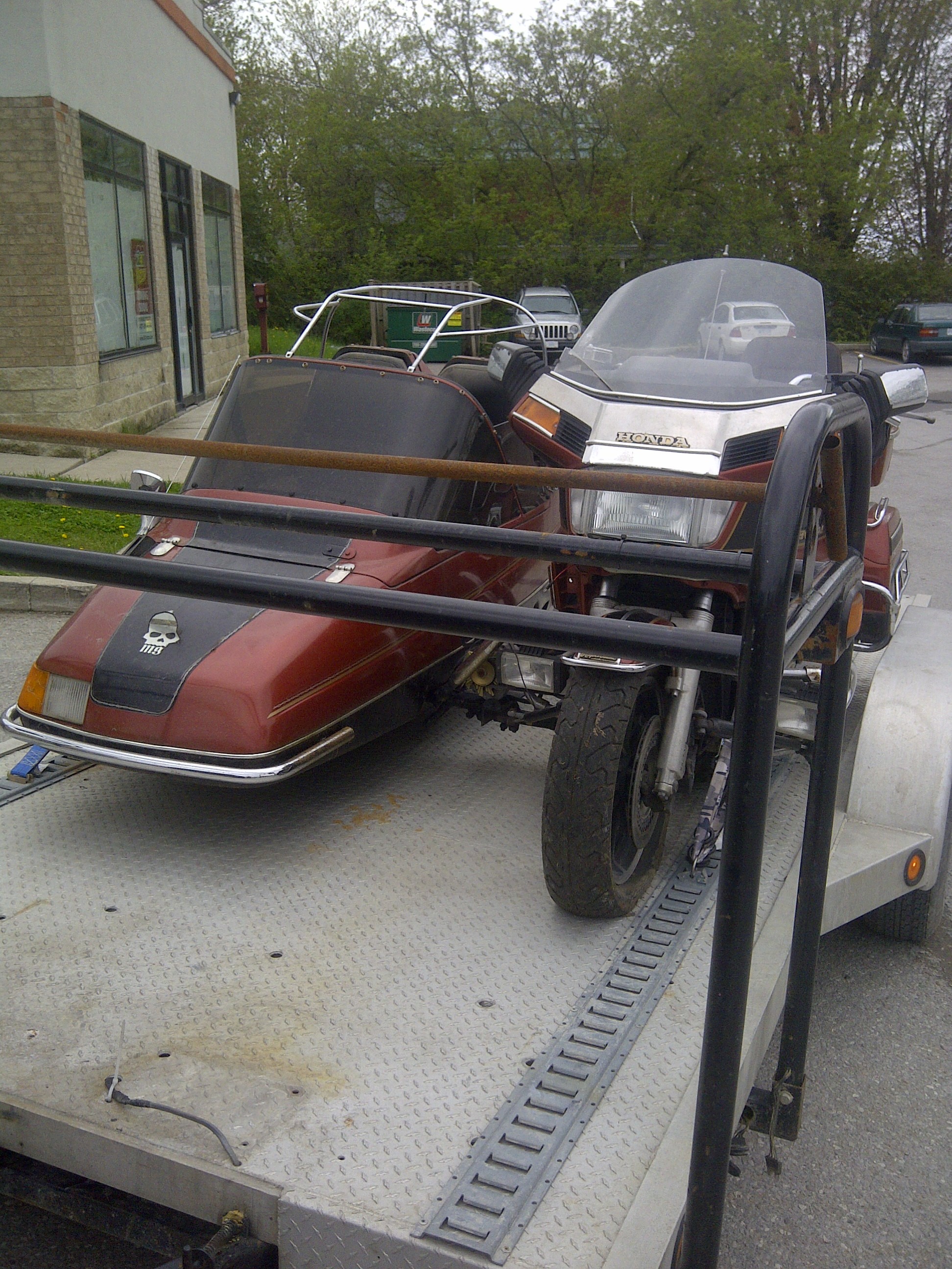

So, the car is now separated from the Goldwing. I got it all apart at the shop today. Gave everything a good thorough cleaning before taking it apart. I got all of the mounts off the GW frame. They seem to be very simple mounts. Will they not work? The EG has a tubular frame just the same. I will take some pictures and measurements of the mounting setup, and perhaps some of you can chime in. There were two lower heim-joints on sliding mounts. Two upper mounts connected to the adjustable threaded chrome struts. And one more mount from the back of the lower rear slider to the rear luggage bar. I think this last one was an add on, but I could be wrong. The rig also had a really hokey looking Alternator setup on the front lower mount. It was driven by the right side timing gear. It can be seen in the first picture if you look closely. I would love to see the mounts or subframe that stay attached to the Harley.
A couple of questions I have is whether its possible to run the FSIII on two lower heim-joint mounts, and one rear strut only. Or is there any way to mount the front strut without having to remove the right lower fairing? Thanks again for your inputs and help. I will try to get in touch with DMC to see their offerings in the way of mounts.
Lastly, does the car have to be mounted so far away from the bike? (as seen in the first pic)
