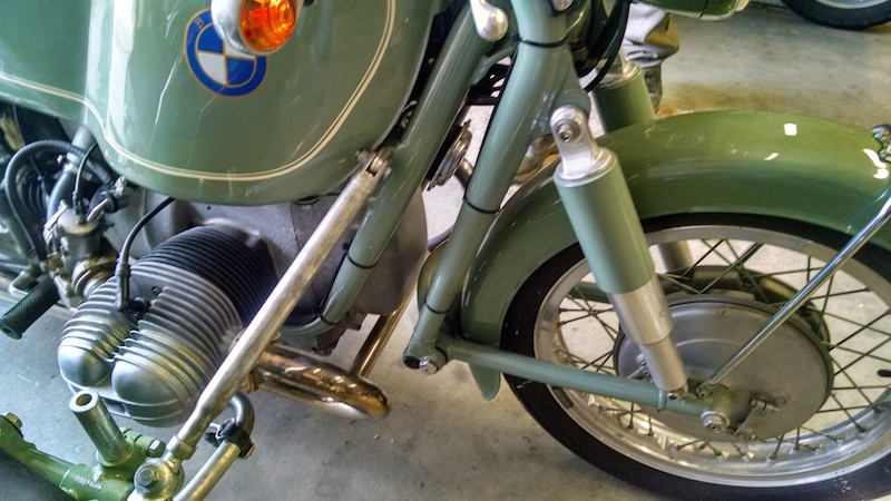

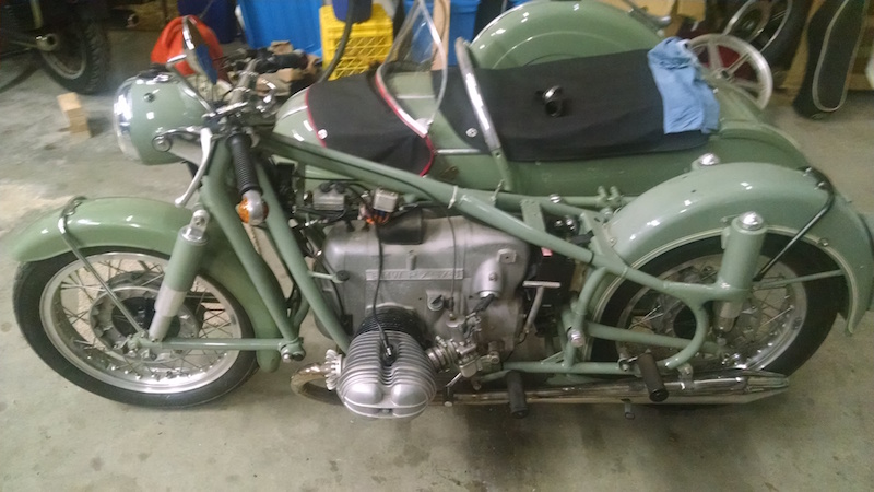

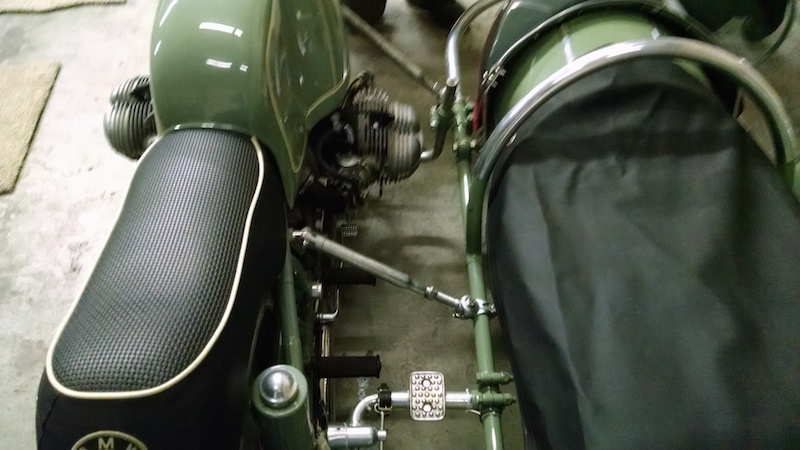

Here is a picture of my 1965 R50/2 with a Steib S 500 attached. The R50 has a 1970 R75/5 motor and transmission

Looks really nice, especially when one considers it's 50 years old.

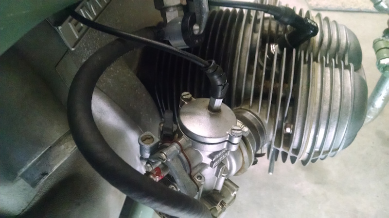

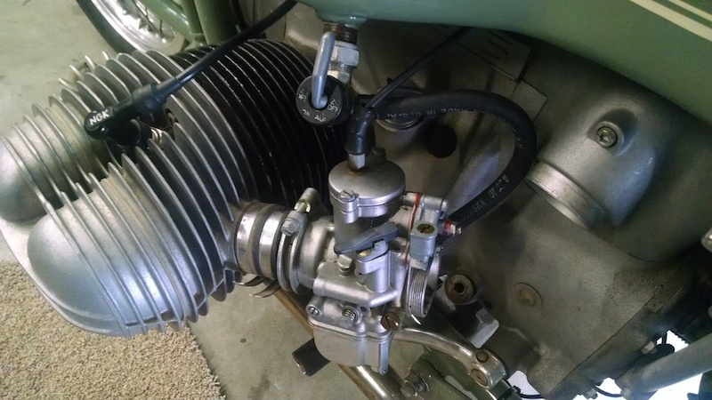

My R50/2 has the R75/5 engine and Dell Orto 32 mm carbs. I have been told that the Dell Orto 36 mm would be perfect.
For now I will stick with the 32's.
Posted : February 13, 2015 1:35 am
(@Claus)
Posts: 54
Don´t you have any connector tubes to the airfilter? Or do you run the engine w/o airfilters at all?
The original carbs were 32mm Bing CV. From that view your 32mm Dellorto with pump are not that wrong, I reckon.
Posted : February 13, 2015 11:17 am
(@donmystic1)
Posts: 66
I have been working on setting up the DellOrto's. So I have the air tubes from the filter off.
The previous owner had too sharp of an angle on the throttle cables so that they were hanging up.
I have been working on a solution for a more " fair " route to the cables.
It is not easy with that big tank.
I think that the 32 mm Dell Orto's are just fine, but my carburator "Garu's" say that 36's would be better.
