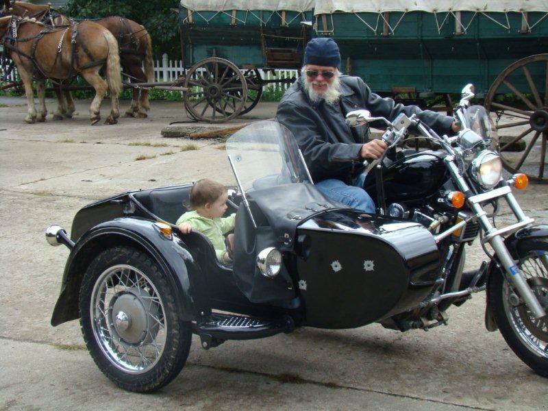

Here is a picture of the '90.
Posted : May 25, 2009 6:44 am
thanks for the picture, would you happen to have a picture of how you mounted it to the Intruder?
