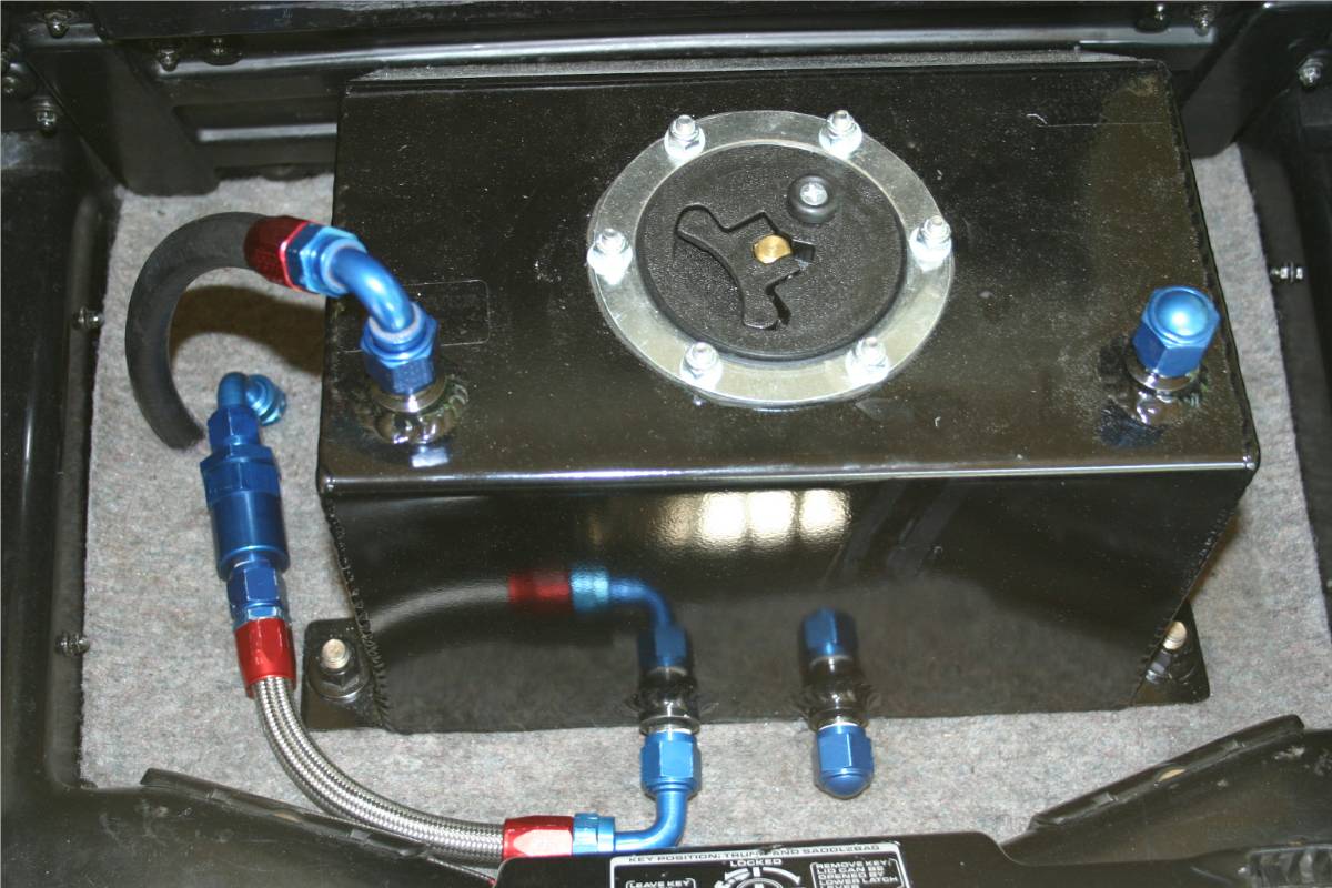

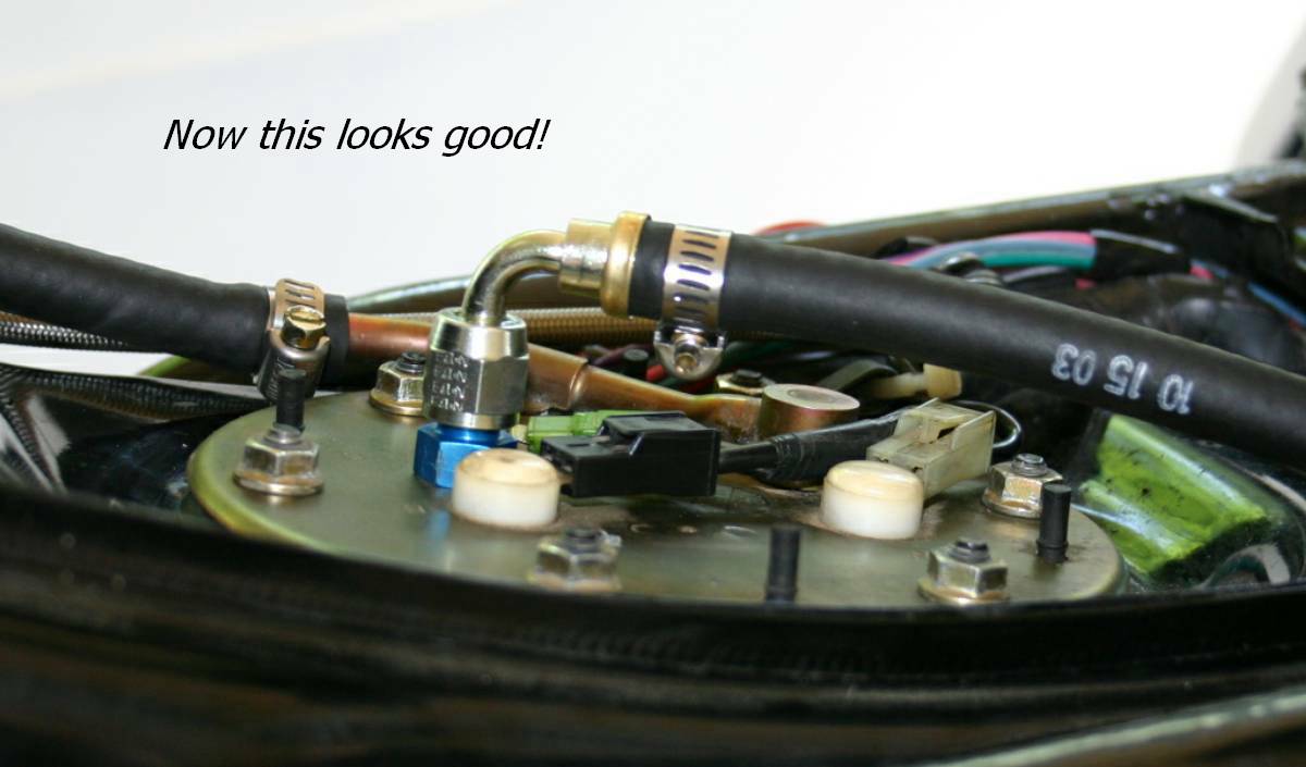

I have a '97 GL1500 with a CSC FII. I mounted a Summit Racing 4 gallon fuel cell in the bike trunk with a gravity feed to the bike fuel pump cover. Problem is, the bike's tank cap is not vented. This prevents the fuel from the trunk cell from draining in to the main when the main gets low enough to expose the opening in the fuel pump cover.
Does anyone know where I can get a vented cap for the factory Wing tank? I'm hoping this will solve the problem, as for now I have to ride with the cap slightly loose to provide the venting.

Thanks CCjon! To clarify, I do have an OEM cap on the Wing tank. The problem may be the plumbing for the Aux.
When I fill-up, I fill the Aux first, so I can see it running into the Main. Then I fill the main to the bottom of the filler neck, at which point I install the Main OEM cap. Then I go back and top off the Aux. The problem that is occurring is that as the gas is being used, it runs from the main first, and isn't automatically draining from the Aux. The gas level will go down in the main and when the bottom of the Aux line is exposed, nothing happens. It's as though there's a tension holding the fuel back. If I slightly turn the Main cap, allowing for passive venting, the fuel will then drain from the Aux into the Main.
As the upper photo shows, I have a vent line coming from the top of the Aux, but that doesn't appear to be assisting with the problem.
Once I get the carb rebuild finished, I'll go at it again and see if I can figure this out.

It appears that you have three (3) vents on the aux tank, right? the top hose, the blue vent on the right and the small vent on the fill cap itself. Should not be a problem on that side.

Yes, the Aux is in the 1500's trunk, significantly higher than the Main. The only vent in the Aux is the hose on the left. The right side only has a cap. I considered that the hose vent on the Aux would be enough to allow pressure venting for the flow from the Aux, but I guess not. The whole idea of this location was so I wouldn't need to employ another fuel pump.
