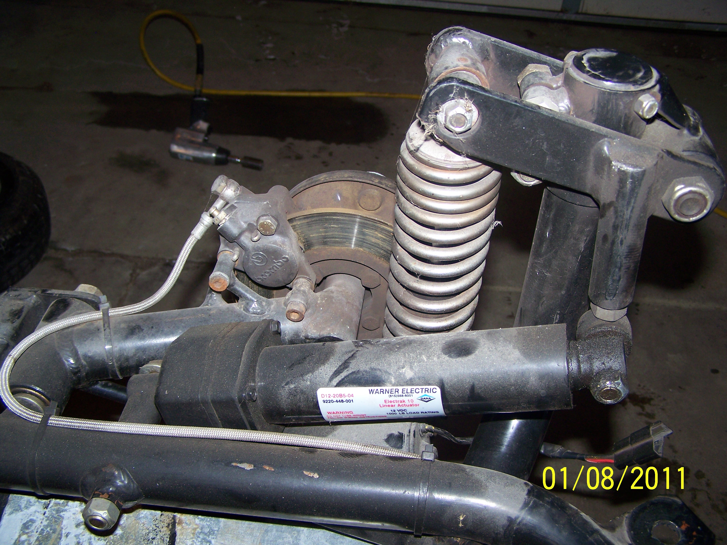

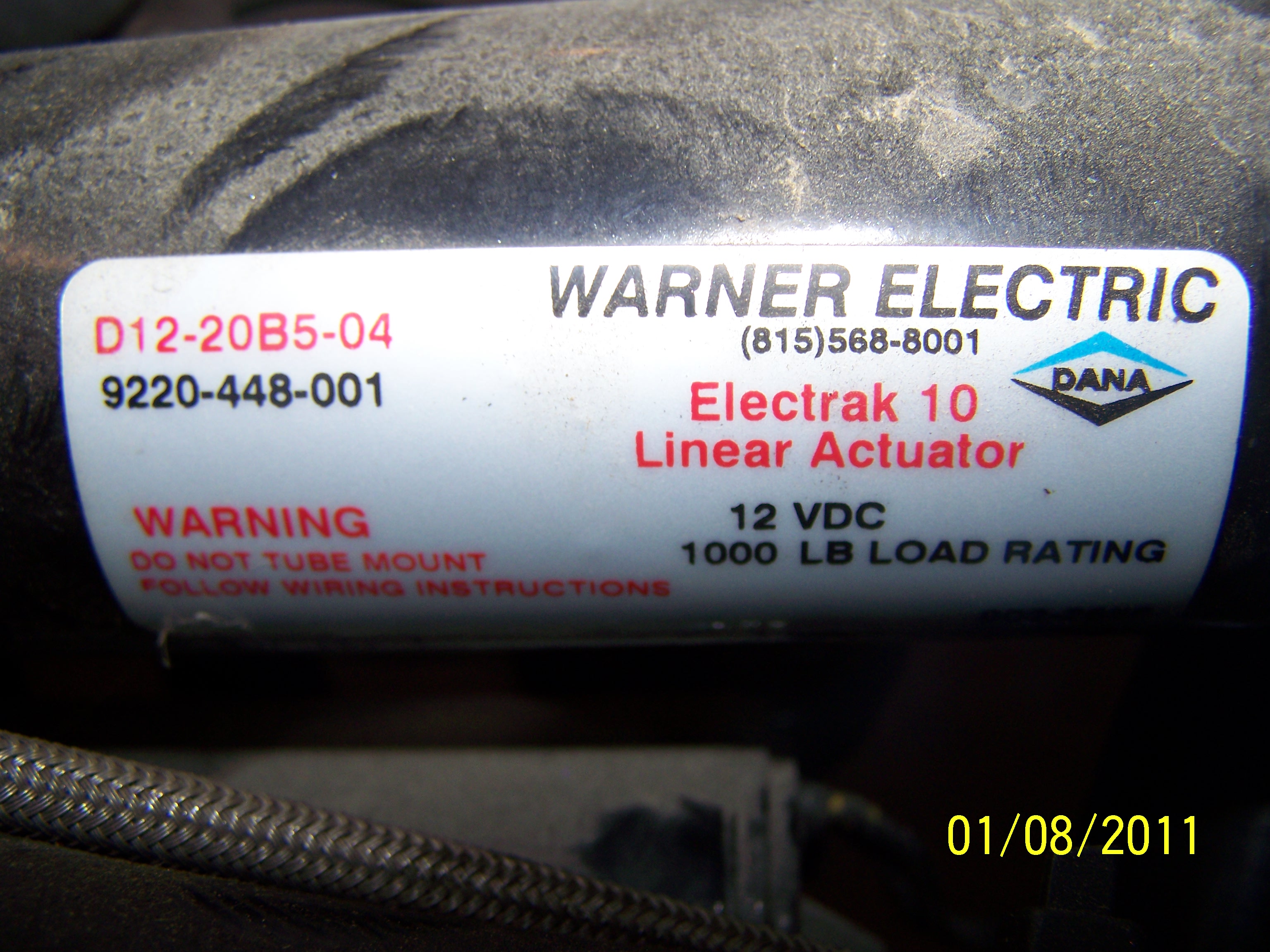

Here is the sticker of of mine, and a pdf file that has a bunch of part numbers and blow ups.
Maybe these will help.
Electrak_10_Repair_Kits_Manual_mnen.pdf (568.1 KB)
