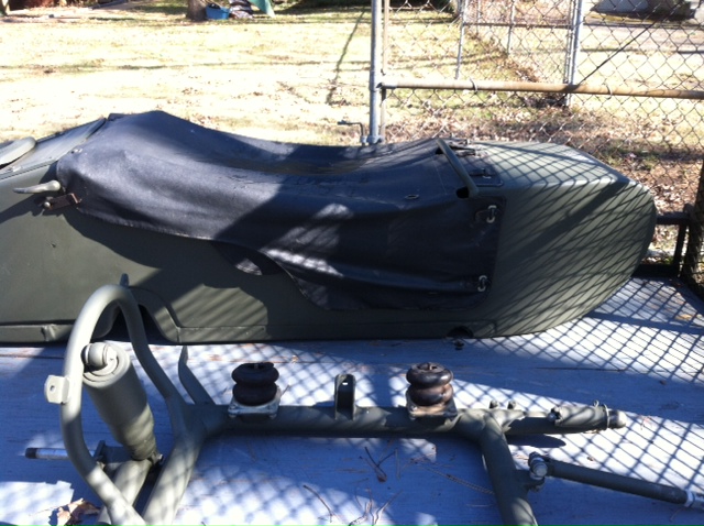

New Sputniks and URAL sidecars (only) haven't been imported for some time. The URAL is only available new attached to a motorcycle. Sputnik, not at all.
The URAL and Dnepr cars are heavier than the Sputnik. Quality wise for the /2 BMW clones it is Late URAL, Early URAL, Dnepr, Chang Jiang. The Sputnik is a cheap aftermarket replacement for the /2 Beemers (List price in 1995 was $800.00).
(ex URAL/Dnepr/Sputnik dealer)
