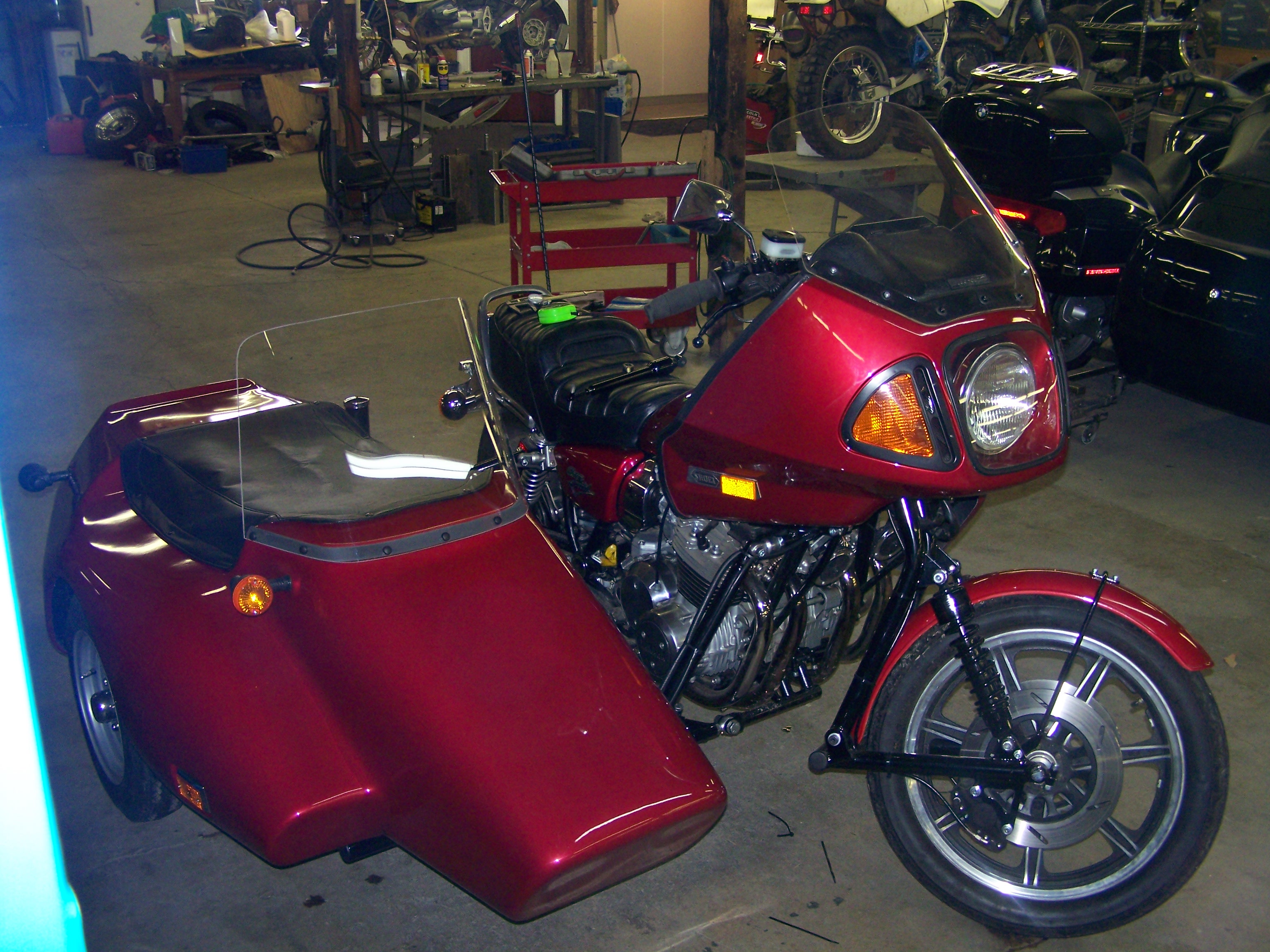

We put one of our Kenna sidecars on an XS1100 2-3 years ago. My customer found the bike as NOS at a dealer with only 12 miles on it when he brought it to us to install the sidecar.
