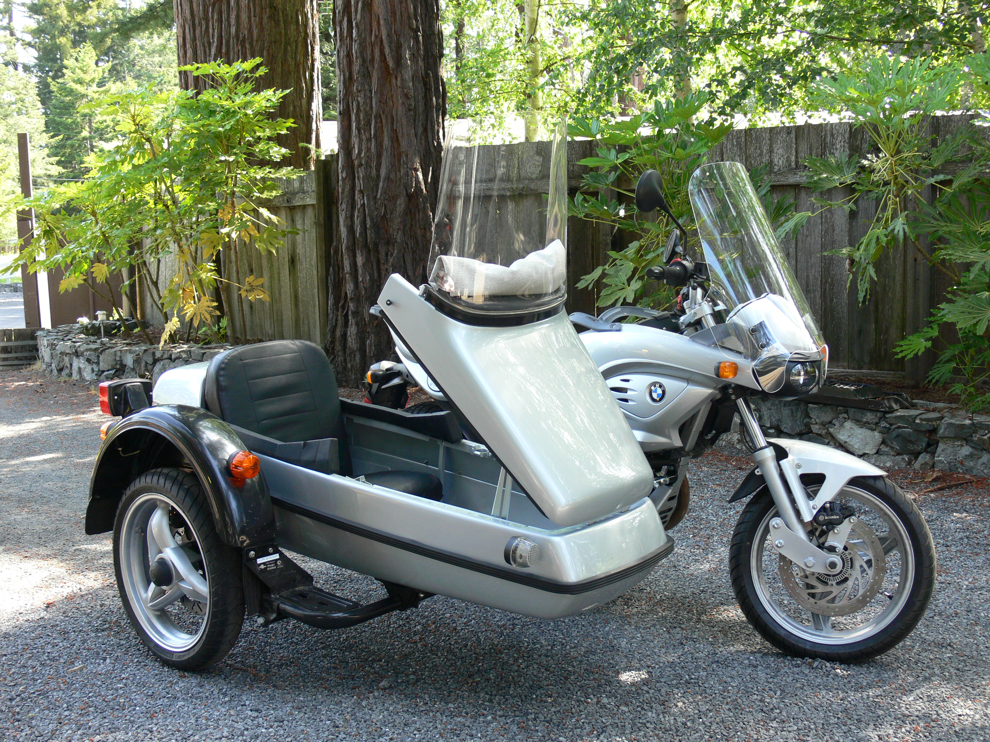

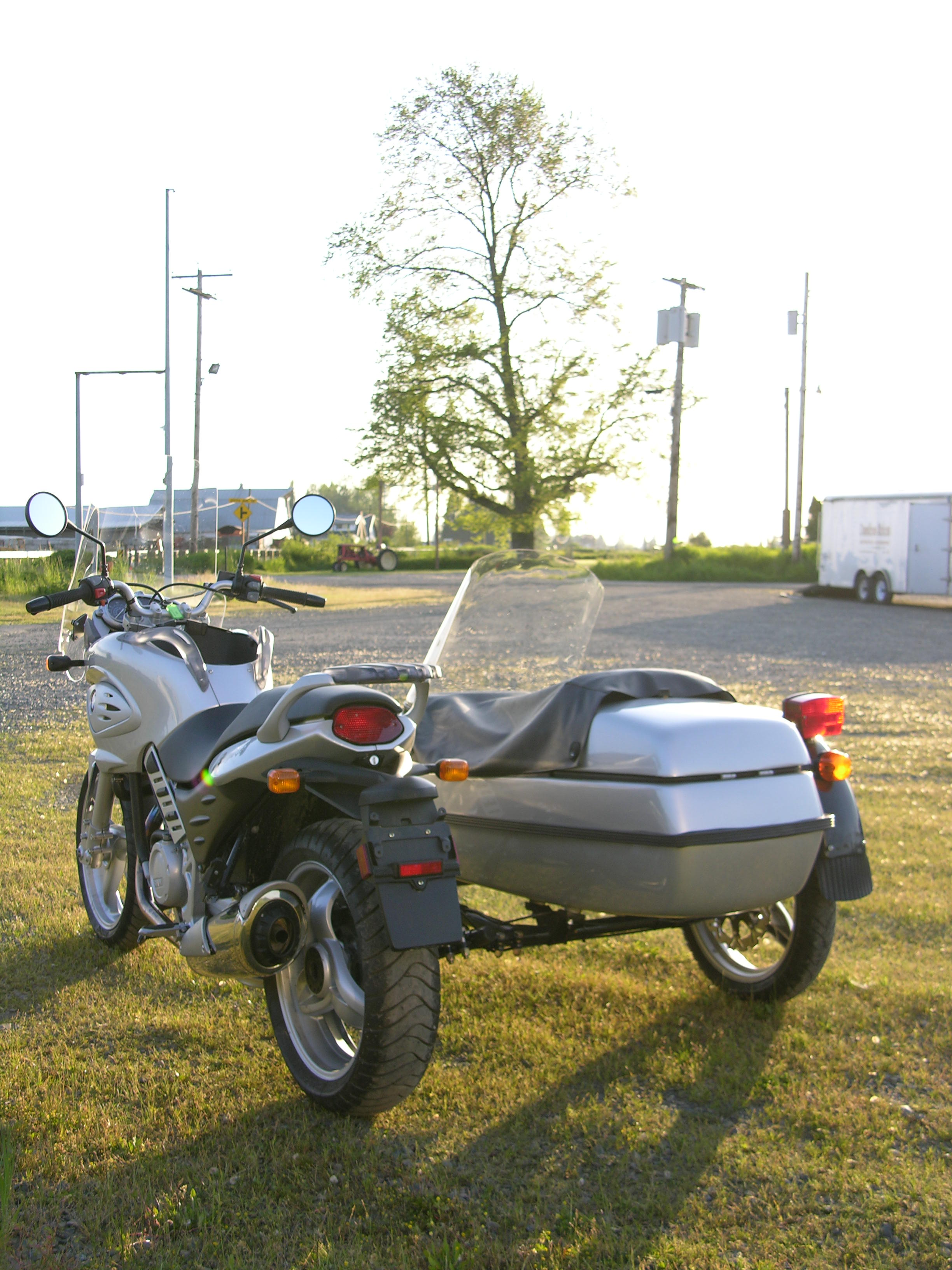

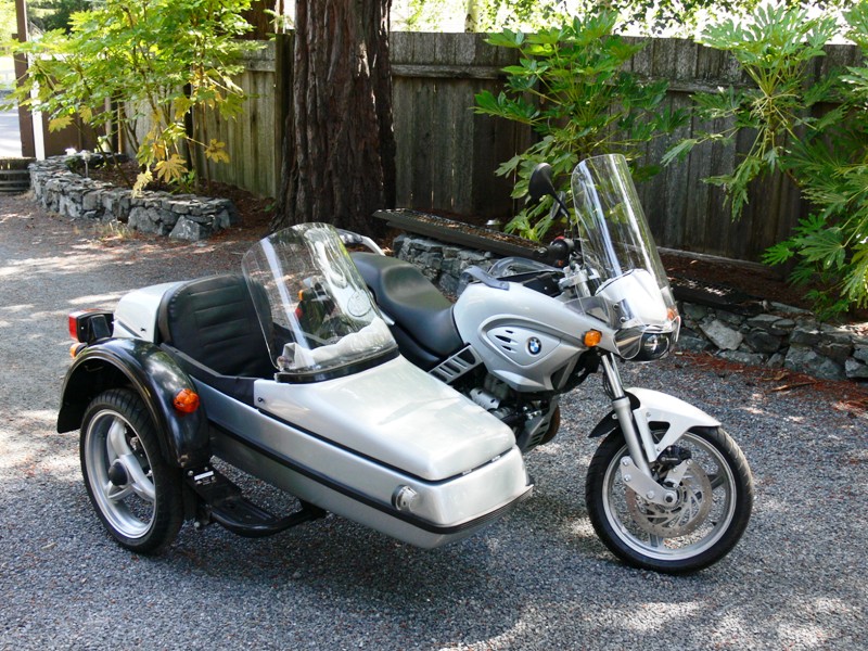

I know of only 2 F650cs with sidecars, there could be more, one has a Velorex, I always am concerned with Velorex mounting even when done by a professional as the Velorex company will let pretty much any one become a dealer at which point even if it is their first install ever, they are the "professional"
The second we did for a customer who has since passed away. He sold it to some one in Washington state who sold it to another person in Washington state who was located less then 10 miles from us. My wife always really liked the bike and so I purchased it for her, then we purchased a different bike for her and sold the F650CS to some on in Oregon who had or has it for sale. We mounted a Sputnik sidecar on it that we color matched, we also added a BMW CS wheel with disk brake and made "leading legs" for the bike to lower the steering effort. This is a well sorted bike that I would not hesitate to ride cross county on. I have attached photo's of the bike.
As to the R1200C, if Perry set it up, it was done right, If it has not had the steering modified we do make a new from billet ball joint mount to lower the steering effort.

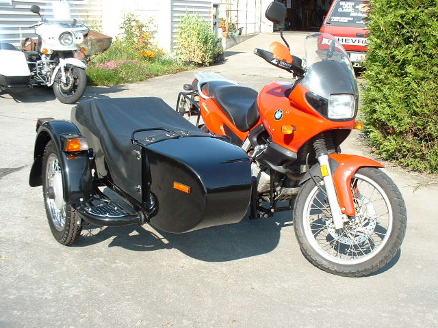

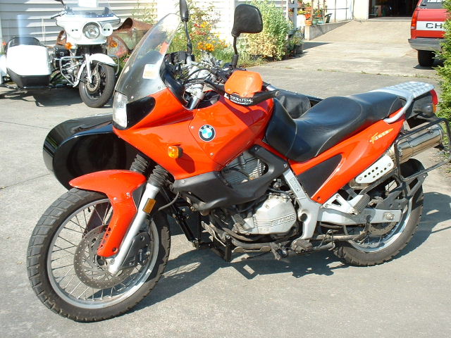

Twowheelgal " Here is the picture of the F650GS. I do not know what kind of sidecar it is or who mounted it."
The sidecar is a Velorex 563 Tour.
The bike isn't a 650GS.b
Here is a 650GS Dakar rig we built that has really been to Africa.
Posted : June 6, 2015 9:12 am
