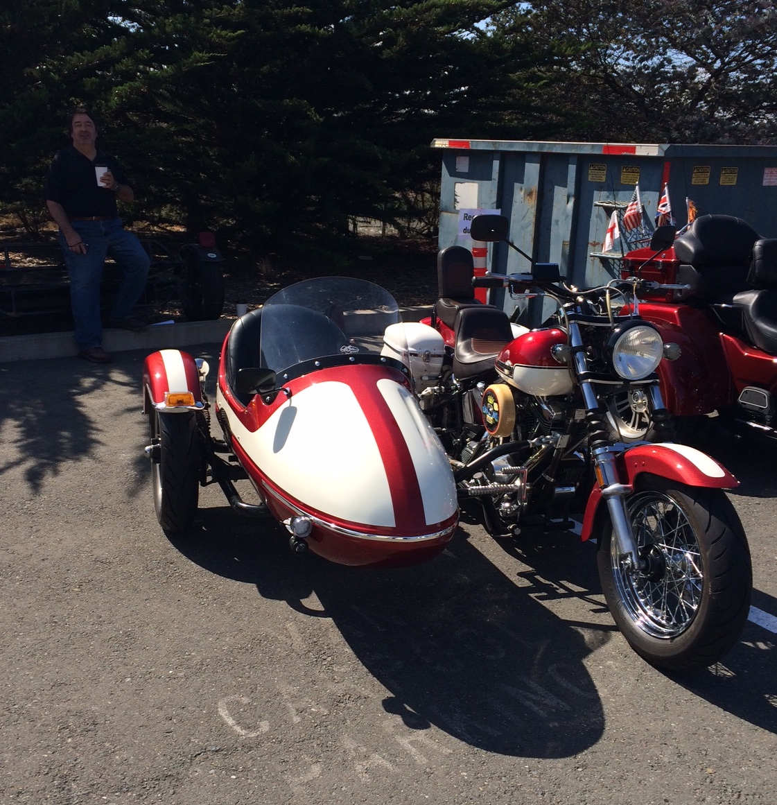

DMC has mounts for Softail... I used them on my Custom -89 to mount a California Companion which should be about the same, for mounting, as a TLE.

Very Nice rig you have there! Softails in my mind make a perfect retro style bike for a side car mule.
Your front mount looks very similar to the hook up on the factory set up.
Do you have any views of the rear? I can see 1 mount from the top of the frame under the seat.
Couldn't tell on the other. Any more pictures would be great. I contacted DMC per your advice as well.

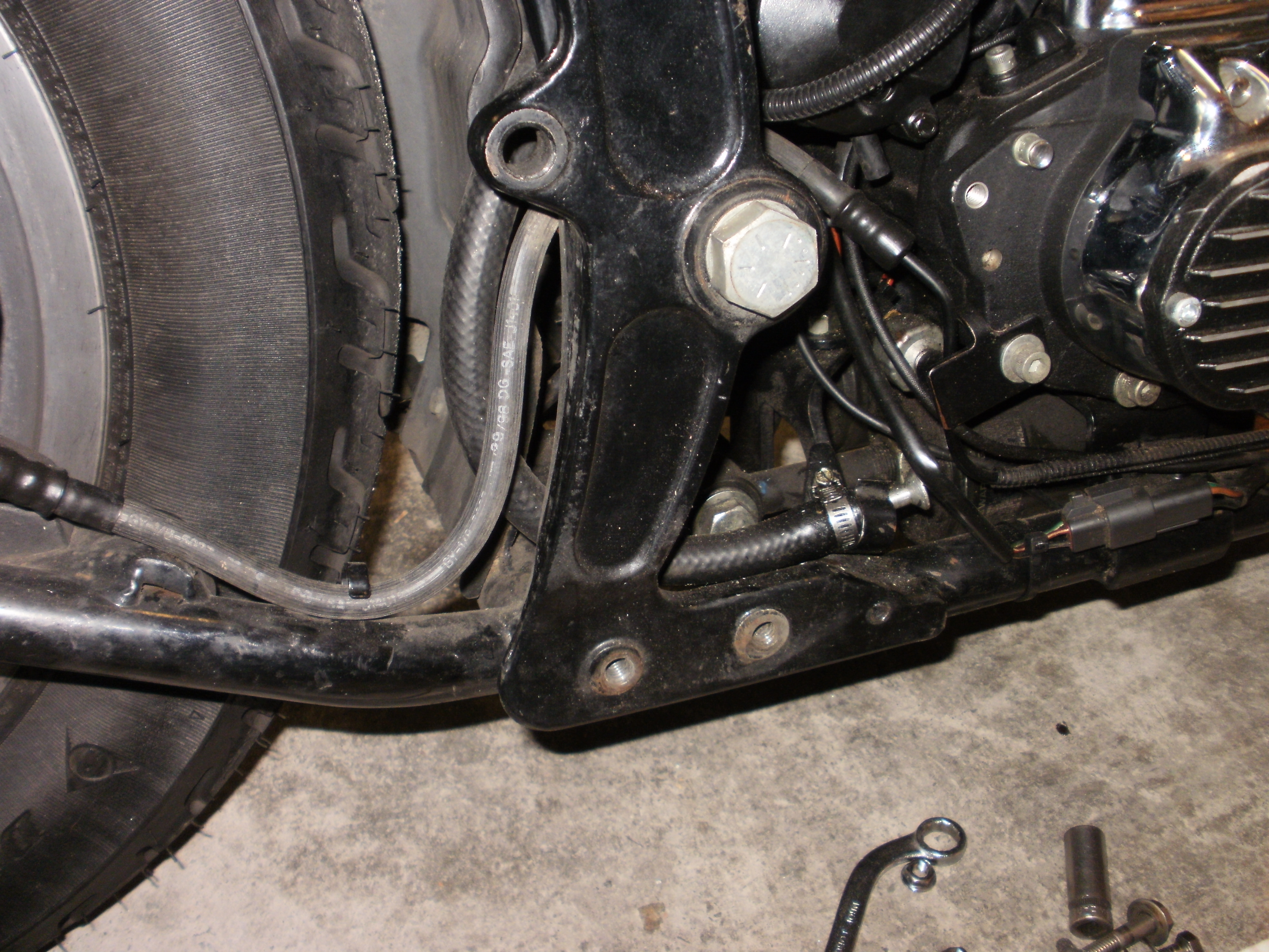

Amazing to me the number of views this post has about mounting a Harley TLE sidecar to a Softail has generated with so few replies!!! It seems obvious to me there is some interest in such a project. I am proceeding with the attempt. I must thank Fuzzybeard for his post that he made some years ago that documented his mounting of the same. ( https://www.sidecar.com/mbbs22/forums/thread-view.asp?tid=13518&posts=1&start=1) As I said the front TLE mounts bolt up to the FLST frame fine. I plan on using a mount similar to Fuzzybeards on the rear ( 3/8 thick plate) but plan to bolt on using the Right rear footpeg hole, the Swingarm bolt hole (utilizing a slightly longer bolt to make up for the bracket's thickness of apprx. 3/8 inch) then at the bottom using the 2 or 3 holes in the lower frame tube that the exhaust bracket bolts to. I'll also either have a fabricator make a "U" shaped clevis bracket to weld to the Flat piece for the Heim joint or I may be able to source this from a Hydraulic Cylinder Clevis mount also instead then weld it to the flat plate.
I'll be using a 2 into 1 exhaust instead of my tapered dual mufflers which really opens up the area where the Heim joint bolts to the bracket on the bike.

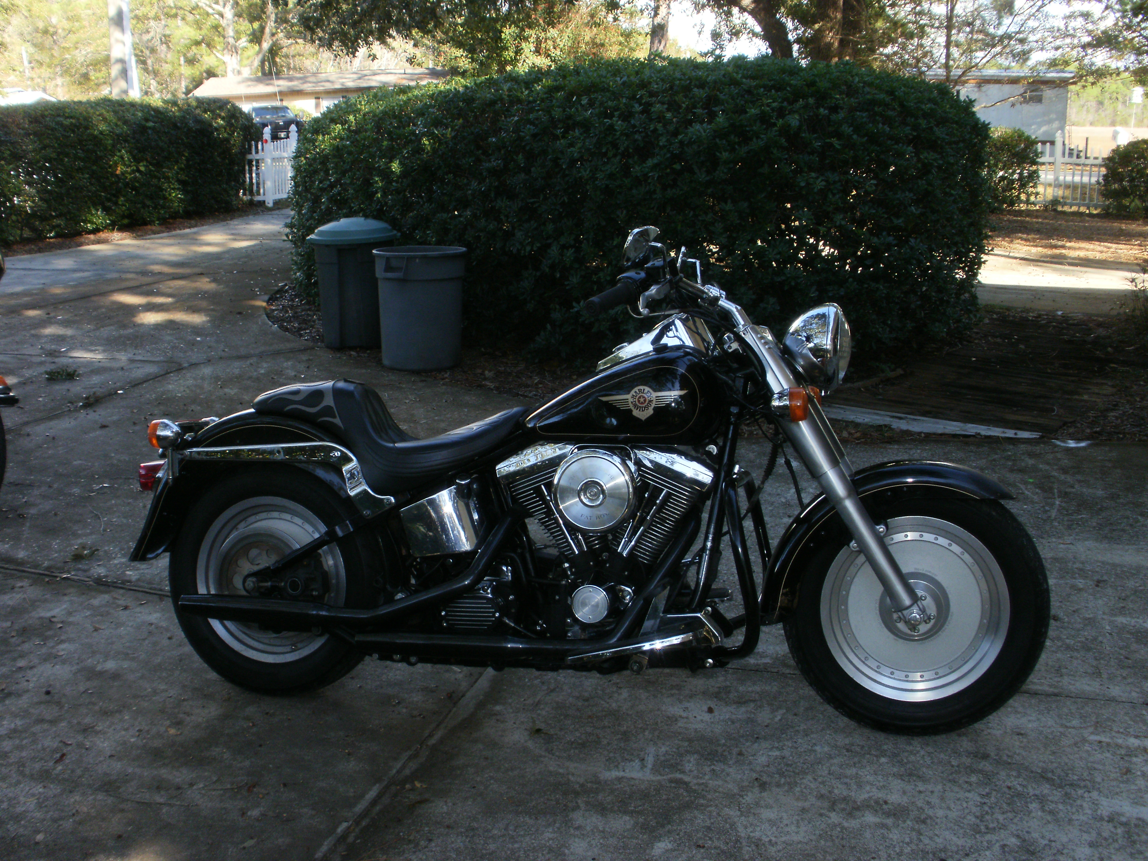

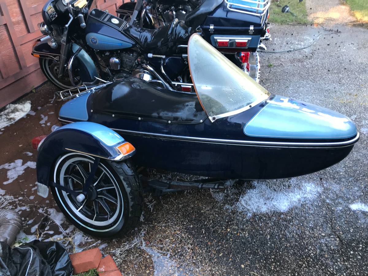

I'll post Picture when I get the bracket made. It will be a while. In the meantime, below is the Sidecar the day I bought it (not my bike in the background)
and the Fatboy I have been working on slowly for a couple of years.

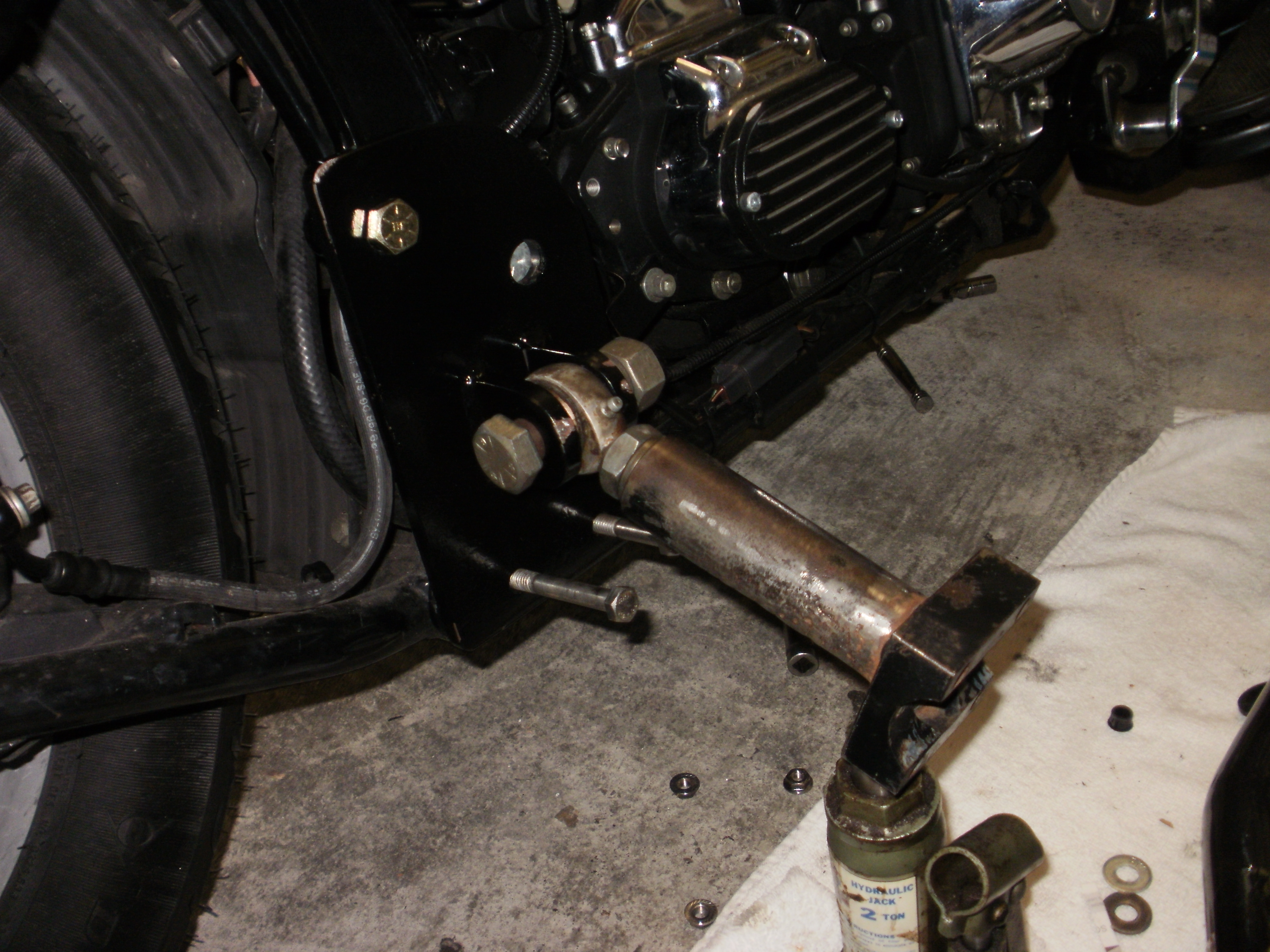

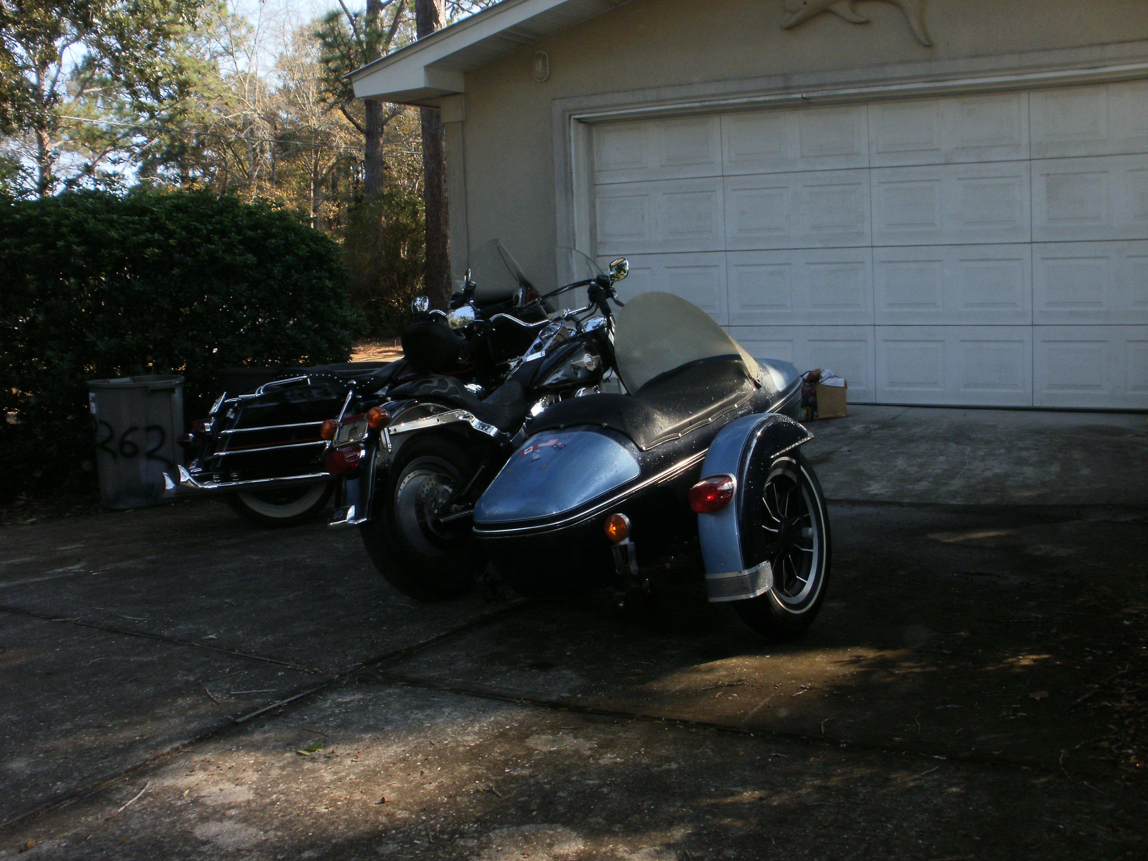

The TLE on a Fatboy project is moving along. Went with 2 into 1 exhaust which opened up the area where the rear mount
will be placed. 3/8 Steel plate, bolted in 4 places, Rear foot peg hole, Swing arm bolt and the 2 at the bottom where the
exhaust bracket bolts to the lower frame rail. I tried to improve just a little on Fuzzybeard's design. Then, weld the 2 ears
on the plate for the Heim joint to bolt to. The bracket is being made now. Hopefully ready in 7-10 days, the bracket that is.
Using stock Harley TLE brackets on the front frame rails.
I only get to work on the bike a couple of days a week so progress is slow but steady.
Early stage of mock up on a cloudy day attached.

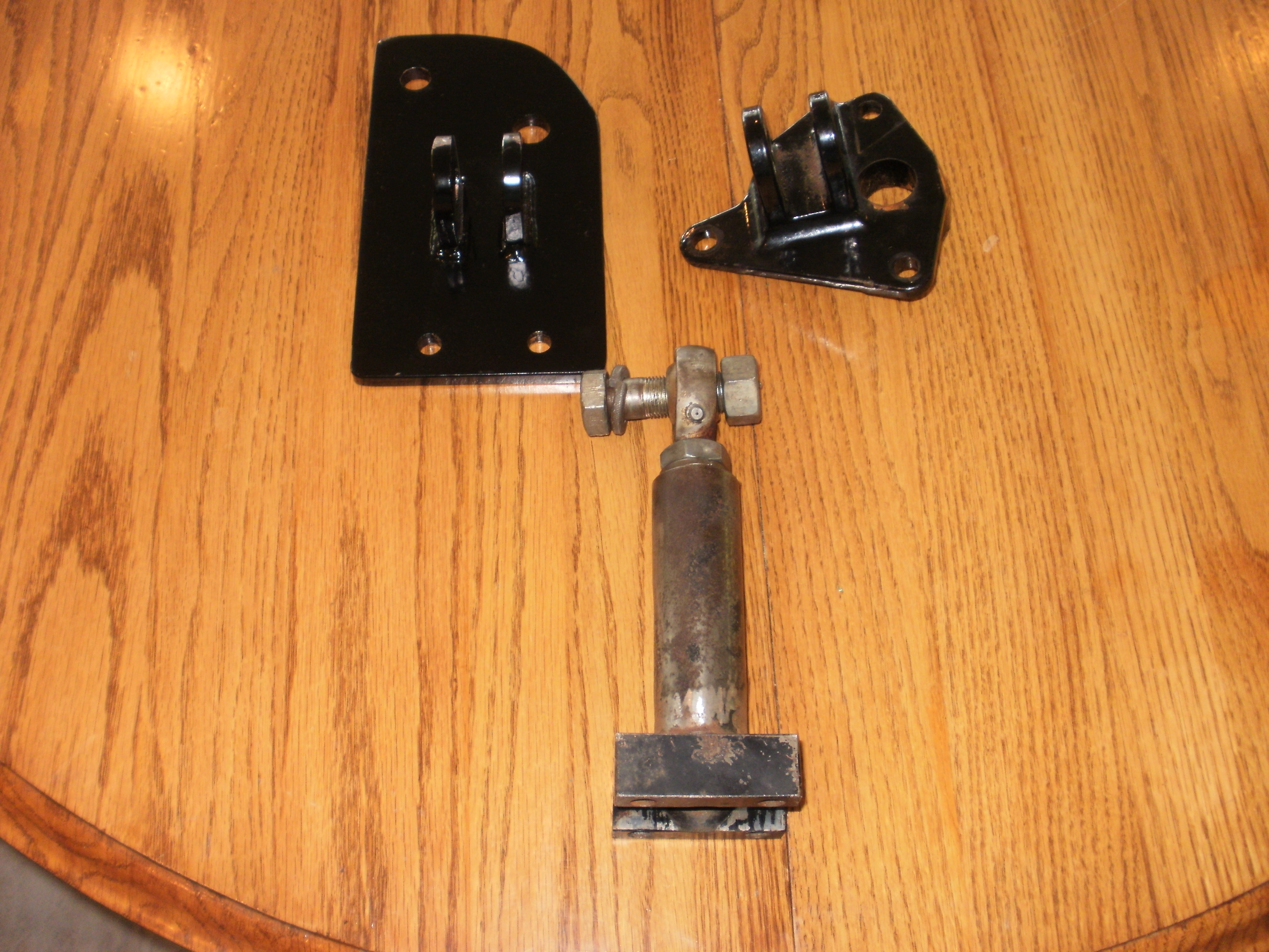

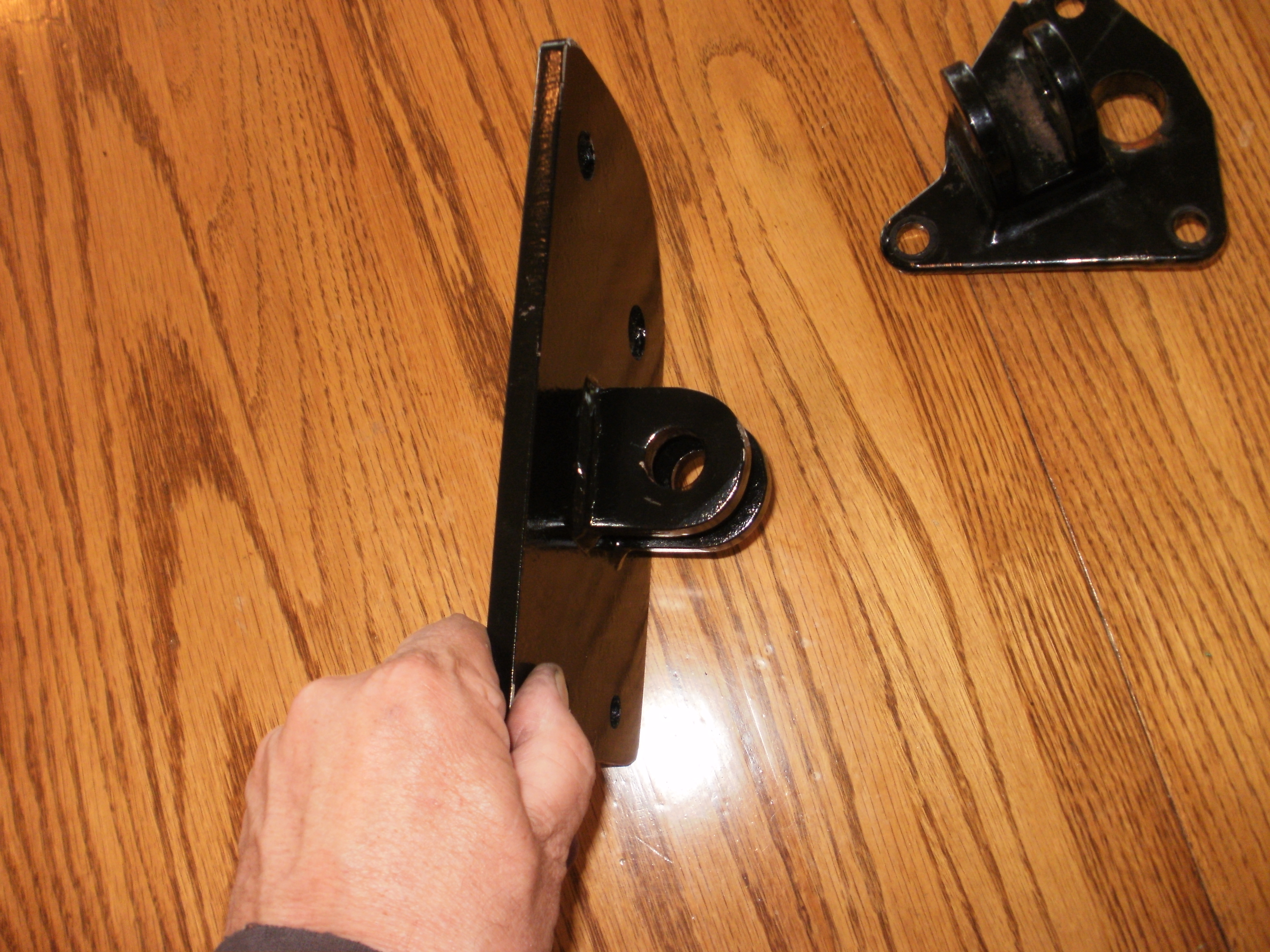

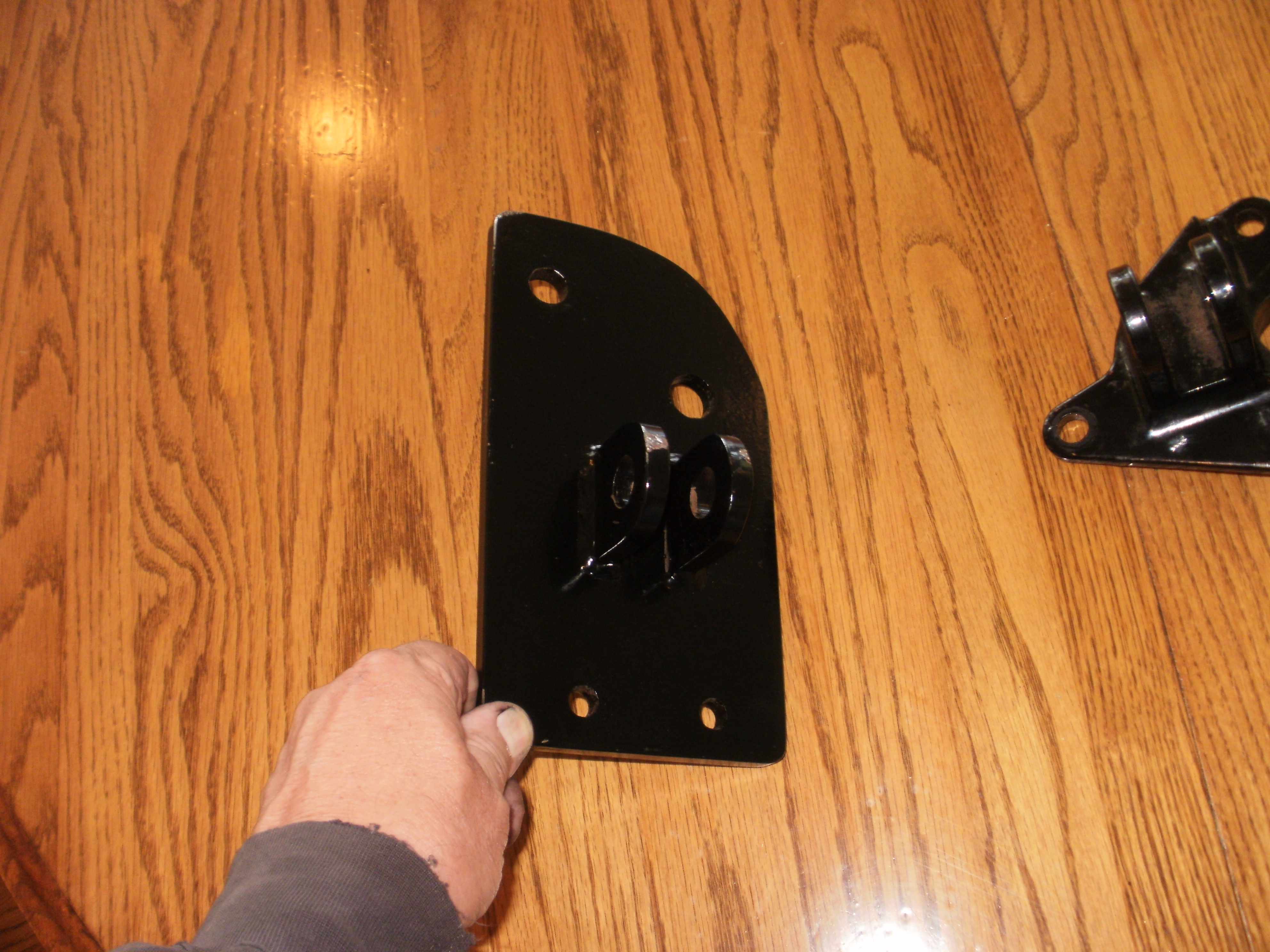

Rear bracket fabricated and turned out great! I'll post pictures of it after tomorrow.
Posted : March 24, 2018 10:30 am
(@williamjack)
Posts: 14
Here are some pix of the new rear bracket. Hard to find fabricators to do these small projects anymore. I think the new larger surface area bracket with 4 mounting posts is stronger than the smaller stock one with 3 mount posts. (both are 3/8 inch steel)
