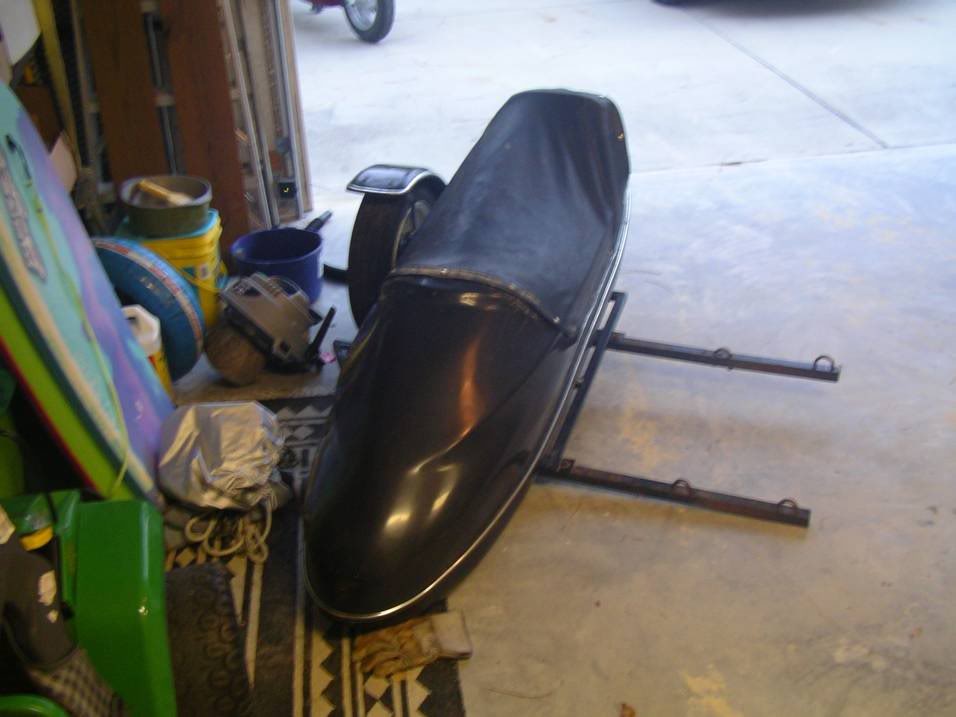

Anyone own one of the texas sidecars or the something like that that goes on a scooter? Just wondering what the measurement of the frame are without the body on it? what the size of the tubuing there used to make it? thanks.

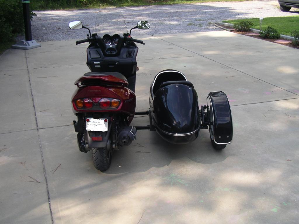

Bob Darden makes a neat set up for scooters for one of his Texas sidecars. He made the first one for Avanell's Burgman. New Burgman mounts came from Hannigan. Both work equally well. J.R.

We had one of the texas rigs on our reflex.
The Helix should be pretty similar.
It mounts very different to most "regular" side cars.
There are 2 approx 2" square tubes (though I recall it may be a little smaller) that use 4 "C" clamps to mount to the lower frame rails of the scooter.
Oh and they are not regular square tubes, they have a flat bar insert inside them on the top to strengthen it.
