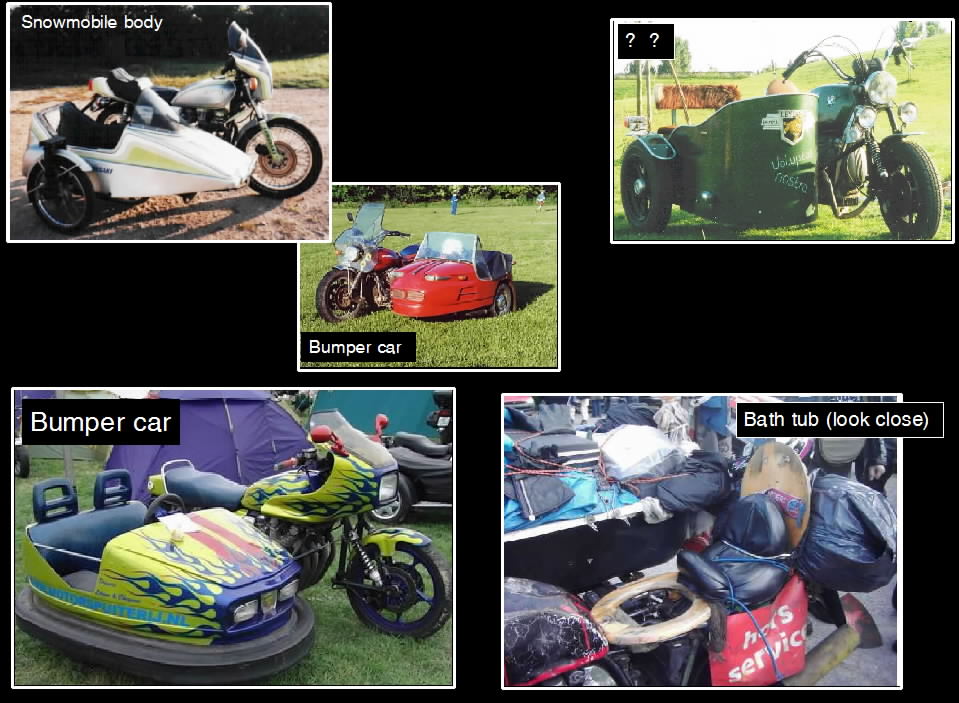

Sidecar bodies can be made from many things.
Have seen them made from two large trash cans welded end to end, two fenders off of a studebaker truck (ugly but clean), one of those tanks for a well (the blue ones), various plywood creations, a bathtub, various carnival rides, drop tanks, all kinds of cargo boxes, etc. One guy cut a truck cap into a bunch of pieces and glassed them back together for a coach type body.
It is fun to begin 'seeing' sidecar bodies as we look around. Be carefull who you share it with as people will look at you kinda funny...but I suppose we do get used to that.
If you are into doing fiberglas work look for sidecar body 'molds'. These can include bathtubs (the cast iron clawfoot tubs make an excellent durable mold. (Do two and connect top and bottom). Car top carriers being plastic can make a mold too but must be braced well.
See attached picture for bumper cars etc.

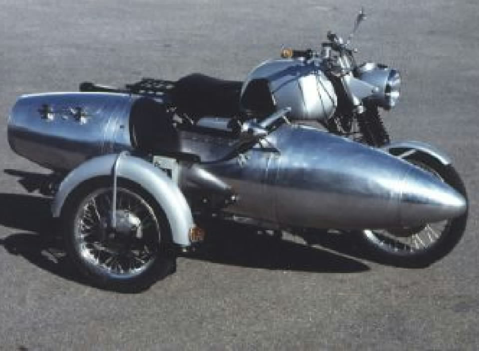

Originally written by Bob Madigan on 12/11/2007 3:50 PM
I've always wanted to mount an old bumper car body on a sidecar chassis, and if you can find an old Air Force drop tank or drogue, well, DAMN!!! Picture it... WOW!
Click here Bob :
http://www.roadrocket.de/1461.html
Posted : December 12, 2007 8:49 pm

When you look at some of the pictures previously posted notice that the end is cut off to shorten the drop tank. I am guessing that the diameter is what would be important and the lenght of the original tank could then be modified in need be.
