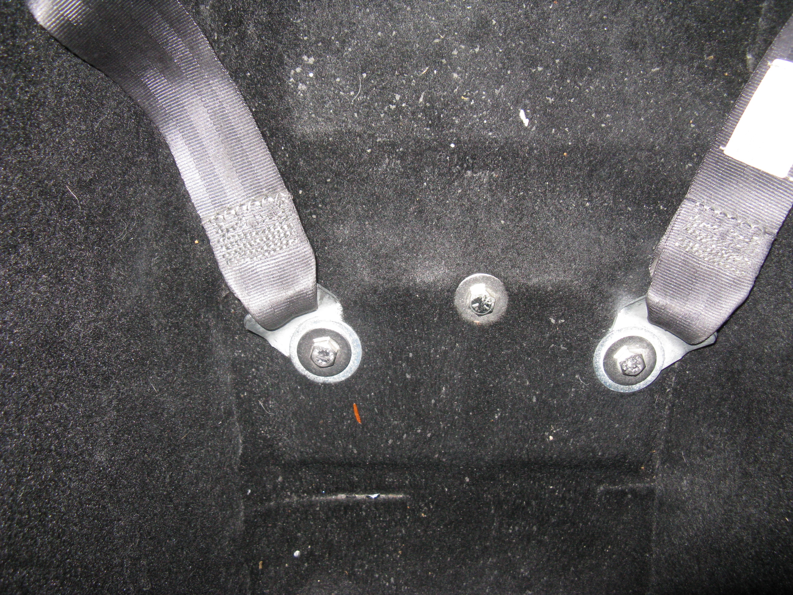

I have brought a 01' Ultra with H-D sidecar, I brought it so my little kids can ride with me. I need to install a safety seatbelt, who makes them?

There is no safety belt made specifically for a sidecar. They aren't a legal requirement.
You can buy seatbelts at any auto store. There are already three bolts retaining the rear of the tub inside of the trunk on a TLE sidecar. They are reinforced with wood strips inside of the area where the bolts go through. I would use the outer two bolts to secure your seat belt and then pull them forward under the seat back.
If you drill the tub forward of that area, it won't be as strong.

Thanks for the prompt reply and advice.
I appreciate if you could post pics whenever you have time to do so.

Here is a photo of my TLE seat belt attachment.
