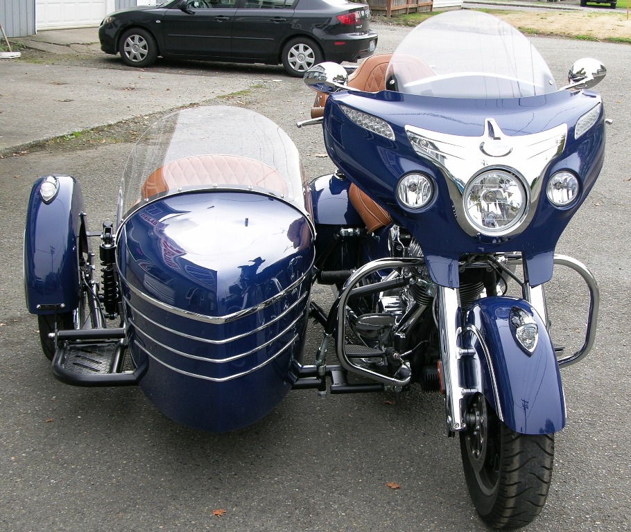

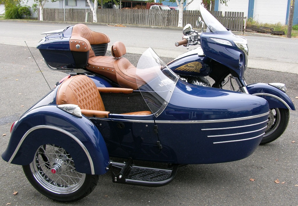

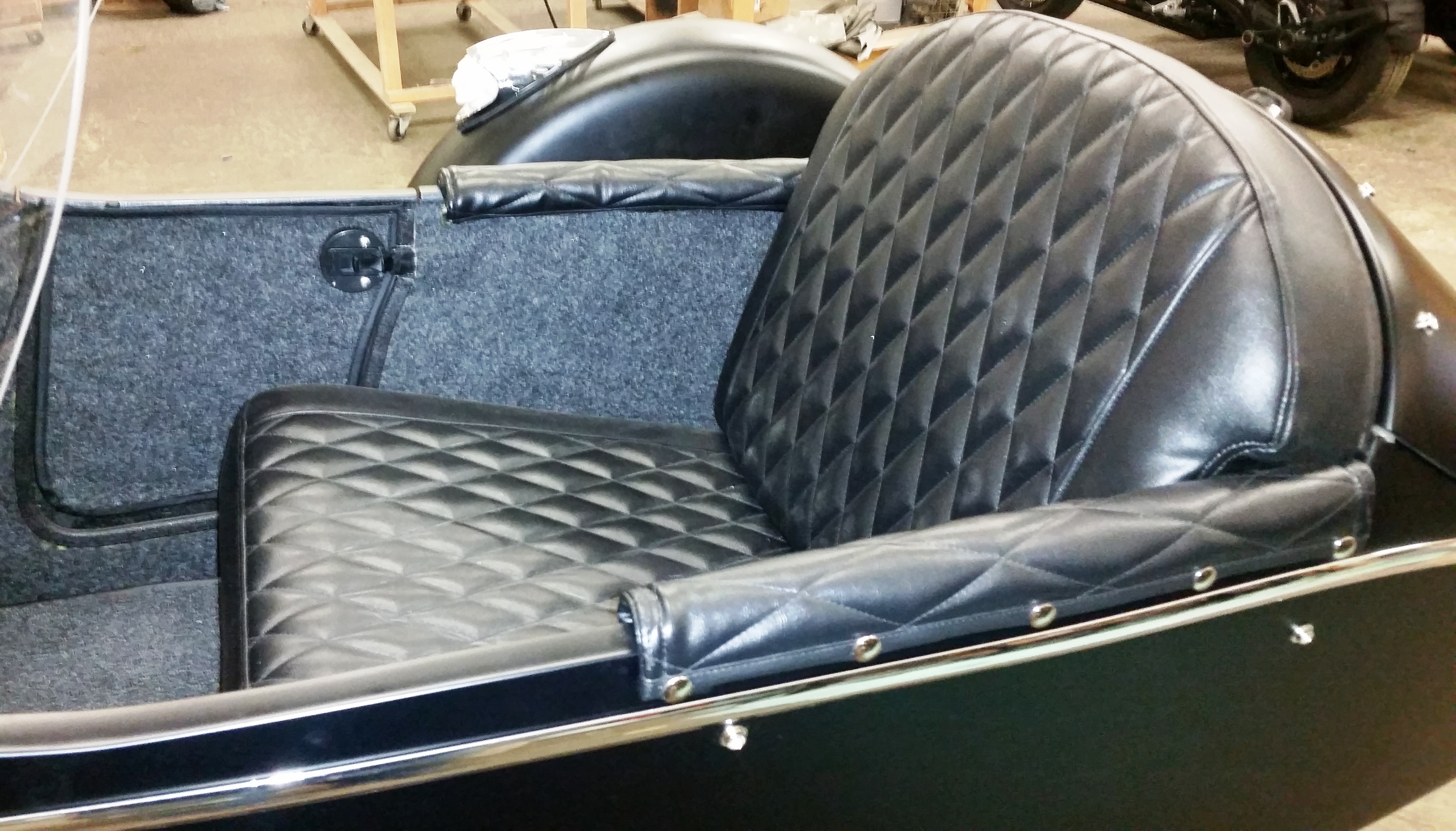

We have a new sidecar called the Tomahawk and the Tomahawk SE. These two sidecars are modeled off of the 1940's Indian Princes sidecar but are about 20% larger as the new Indian's are larger bikes and as a people we are getting larger. The SE comes standard with many items that are options on the base Tomahawk and it also has a door in the side making it easy to get in and out of and the trunk opens from the out side. We designed this sidecar to be very easy to install. There is only one small discrete hole to cut in the plastic, the mounts go on the bike in under an hour. The attachment parts from the sidecar to the bike pre set your wheel lead. It comes with a plug and play wiring harness so that there is no splicing of wires. We have matched the upholstery style and colors as best we can, when an order is placed we need to know the color of the seat and the color of the thread used for the stitching. We offer triple tree's to lower the steering effort while you can get by with out them, why would you want to, it is so much nicer to ride with them then with out. I have attached some photo's. More latter in the day of a blue bike we just finished and took photo's of last night, we have yet to down load and edit the photo's
