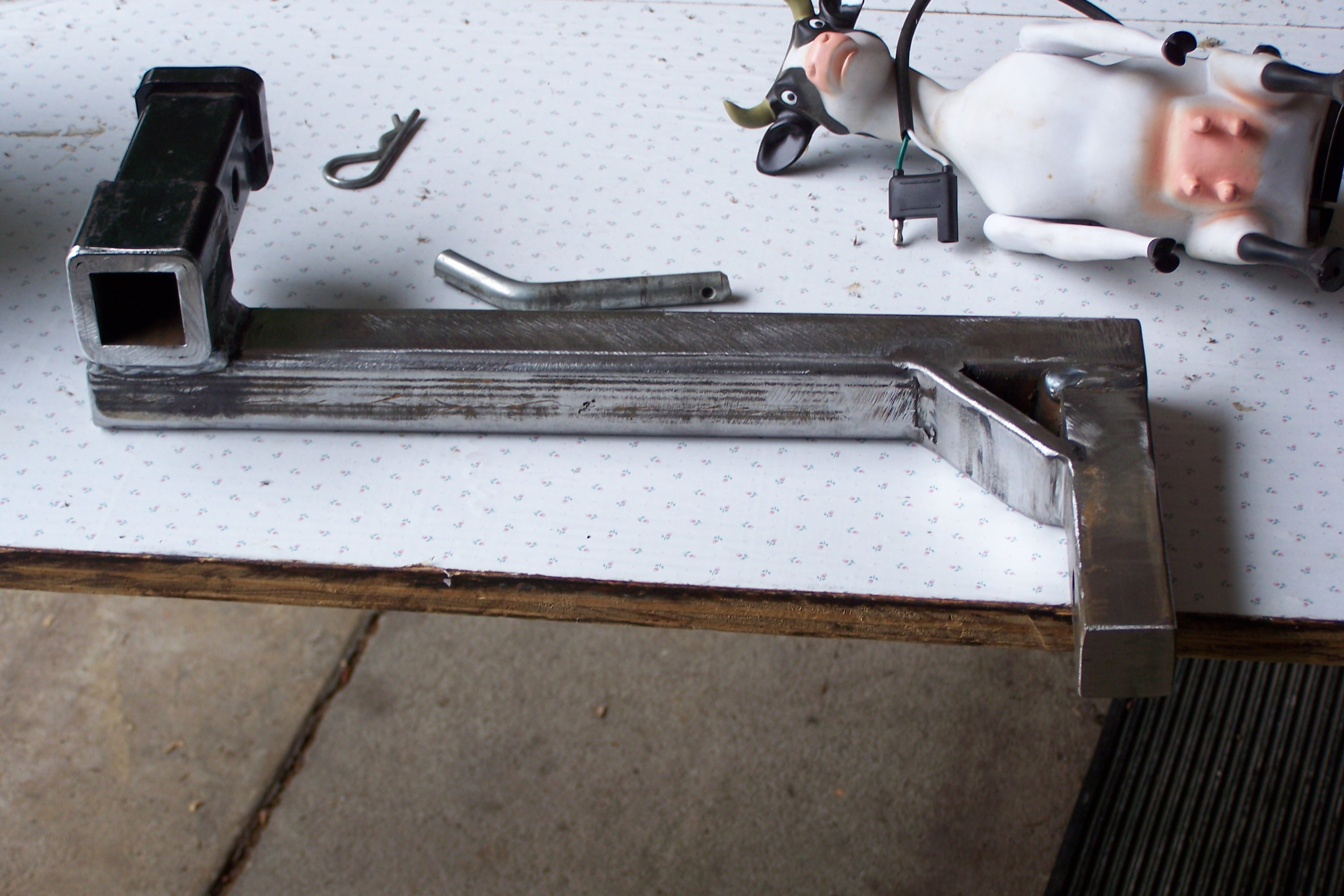

At the last SKUNK Rally, a gent had a receiver hitch on his Goldwing. He simply made an insert with a 90 degree bend to the right about 10 inches long. I am having a local machine shop weld one up as I type. I should have it tomorrow. I'l post a photo when it arrives
Posted : June 19, 2012 11:25 am
It seems to me that the 10" offset would put some side stress on the rear bike wheel. The sidecar already puts that load on the rear wheel making them wear quickly. I don't know how little or much the tread life will be affected with the offset but there will be some affect.
Posted : June 19, 2012 11:57 am
Hack'n - 6/19/2012 4:57 PM It seems to me that the 10" offset would put some side stress on the rear bike wheel. The sidecar already puts that load on the rear wheel making them wear quickly. I don't know how little or much the tread life will be affected with the offset but there will be some affect. Lonnie

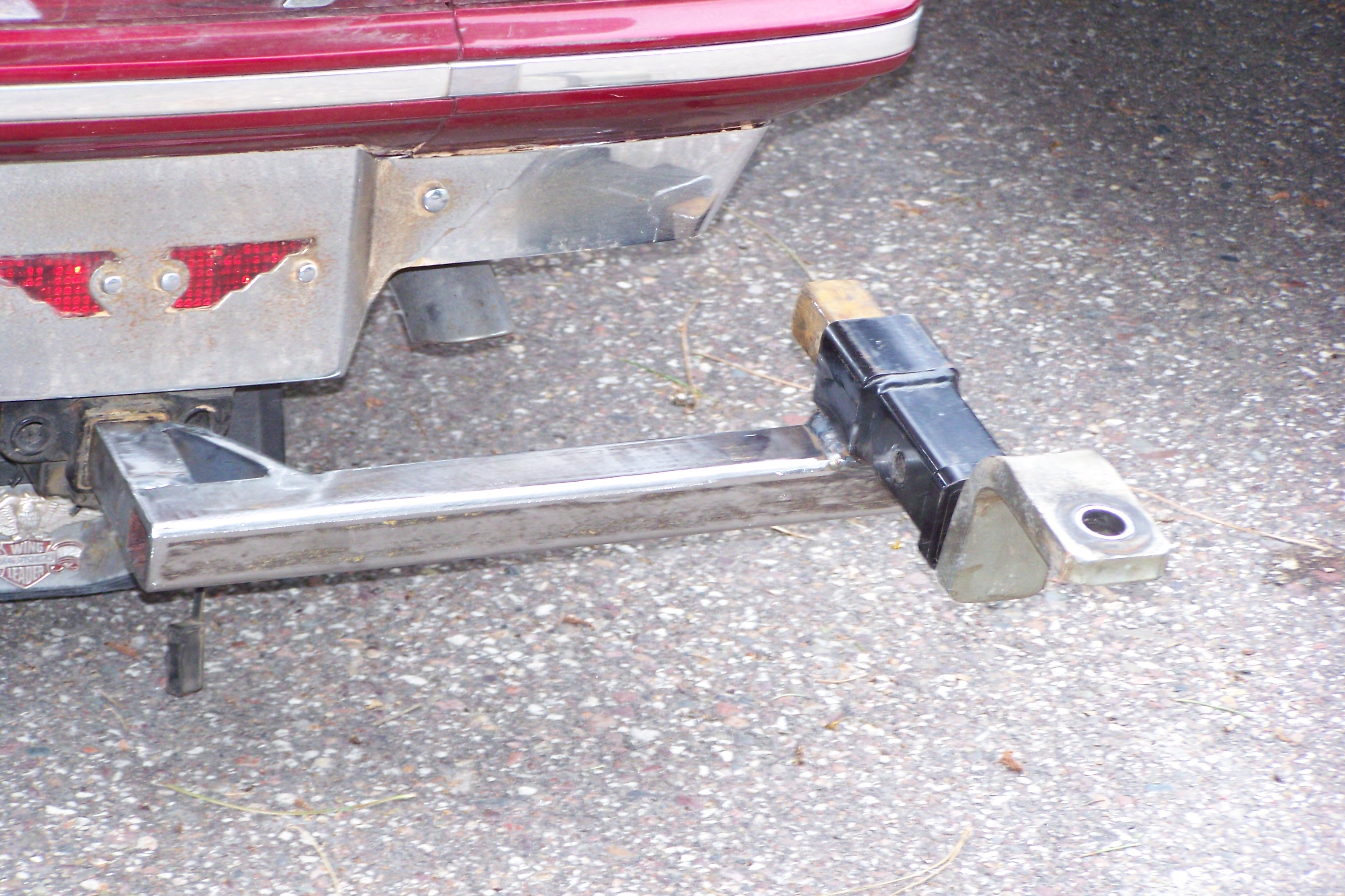

I can't imagine it being any different than the added stress of having the hitch and weight added to the sidecar mounts. Here is the finished project. We actually made it longer than originally planned for two reasons.
1. It now allows me to mount a Yakima two bicycle rack without bikes sticking out to the left.
2. If we find a flexingt issue, we now clear the saddlebag and can run a support up to the subframe if needed.
I just spent 20 minutes in the twisties with the big trailer and it feels great. I will keep an eye on the car tire however.

What kind of bike? This one has a HitchDoc, but they no longer offer one for the 1500. One of my prerequisites is to get the trailer's left tire to follow in the same track as the motorcycle tires. My last three rigs all had an offset hitch of one means or another to that end. I've not found tire wear to be a problem, but I run a car tire. My experience may not be the same as someone running a bike tire.

Mine is offset 13 1/2 inches center to center.

All we did was create a replacement for the hitch that moves the coupler 13 1/2 inches to the right. I chose that distance, as I wrote above, to get clearance for the bicycle rack and to clear the edge of the saddlebag so I could run a support forward to the subframe if I needed bracing.
There was no science involved. You will just have to do what works for you.
The advantage to a receiver is that I can still pull the trailer with a conventional coupler if I remove the sidecar, and I am not going to tear up my shins when I don't need the trailer.
