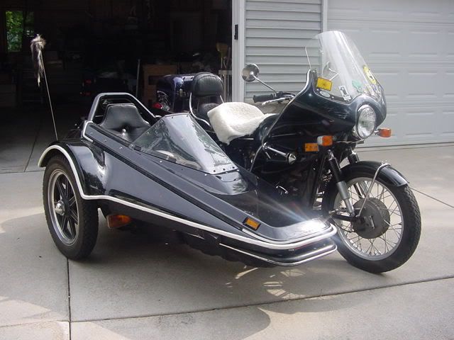

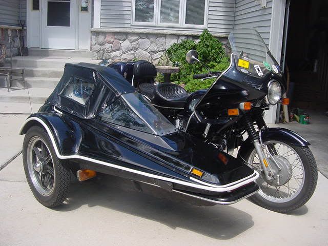

As Tod mentioned...you definately need a subframe, to mount ANY sidecar to all the / bikes..and most other brands also, for strengthening and ease of mounting.
I have a 73 LWB /5 with a subframe and earles fork mod...great!
I had a Terraplane mounted to it and now a MV FII flipnose.
