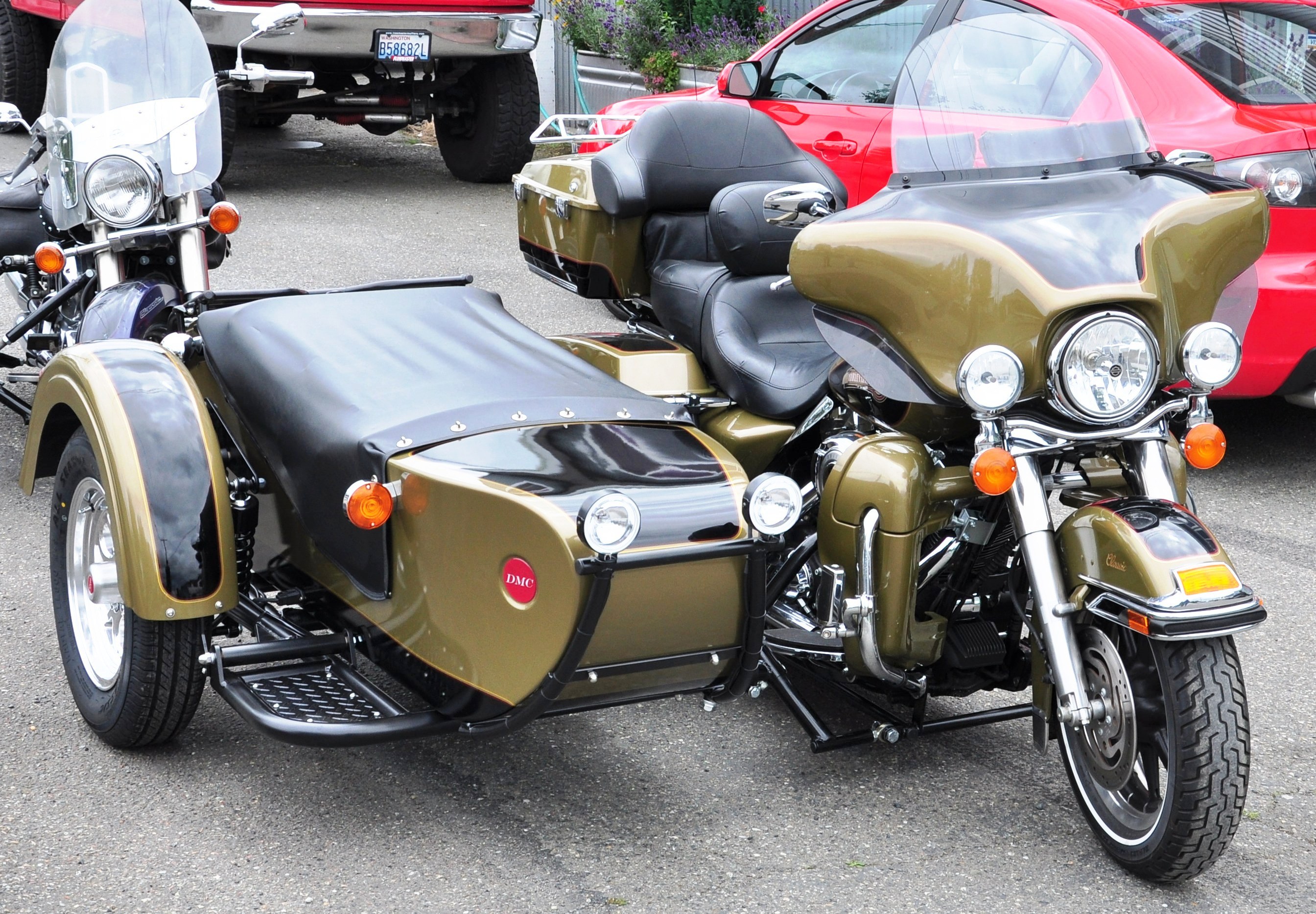

If you are looking used, make sure that it either comes with the proper mounts for your bike or that you can get the proper mounts. Any of the USA manufacture's can supply you with proper bike specific NOT universal mounting hardware for their sidecars and will sell you a sidecar that is strong and heavy enough for your bike. It can be tricky finding hardware for a Harley brand sidecar. Keep in mind if you do go with a Harley sidecar that its frame design was pretty much obsolete by the start of WW2. Up until the last Harley sidecar ever built they never got around to adding any suspension at all! Yes the body is on un-dampened leaf springs but the wheel has no suspension. Also make sure that your passenger will be able to get in and out of the sidecar. Some sidecars are very hard to get in and out of. Harley sidecars and some others (including some of our sidecars) are not easy to get in and out of as you must step over the side and then slide behind the windshield to get into them. One nice thing to have is a trunk that opens from the out side, not all companies build sidecars with external opening trunks. Some of our sidecars you remove the seat back (like Harley) others have the external opening trunk. If you want a brake (I always recommend a brake) make sure that the sidecar comes with a brake or a brake can be added where as you may never need a brake, if it keeps you out of the emergency room even once it was worth the cost and effort. While we are a long ways from you should you get out this way we have a 1978 FLT that we are installing a sidecar on that will be here all winter as there is to much snow where he lives to get it home before spring time.
We make 12 models of sidecars, One of the most popular for your bike is our M72CX which of course comes with proper bike specific mounts for your bike. I have attached a photo.
