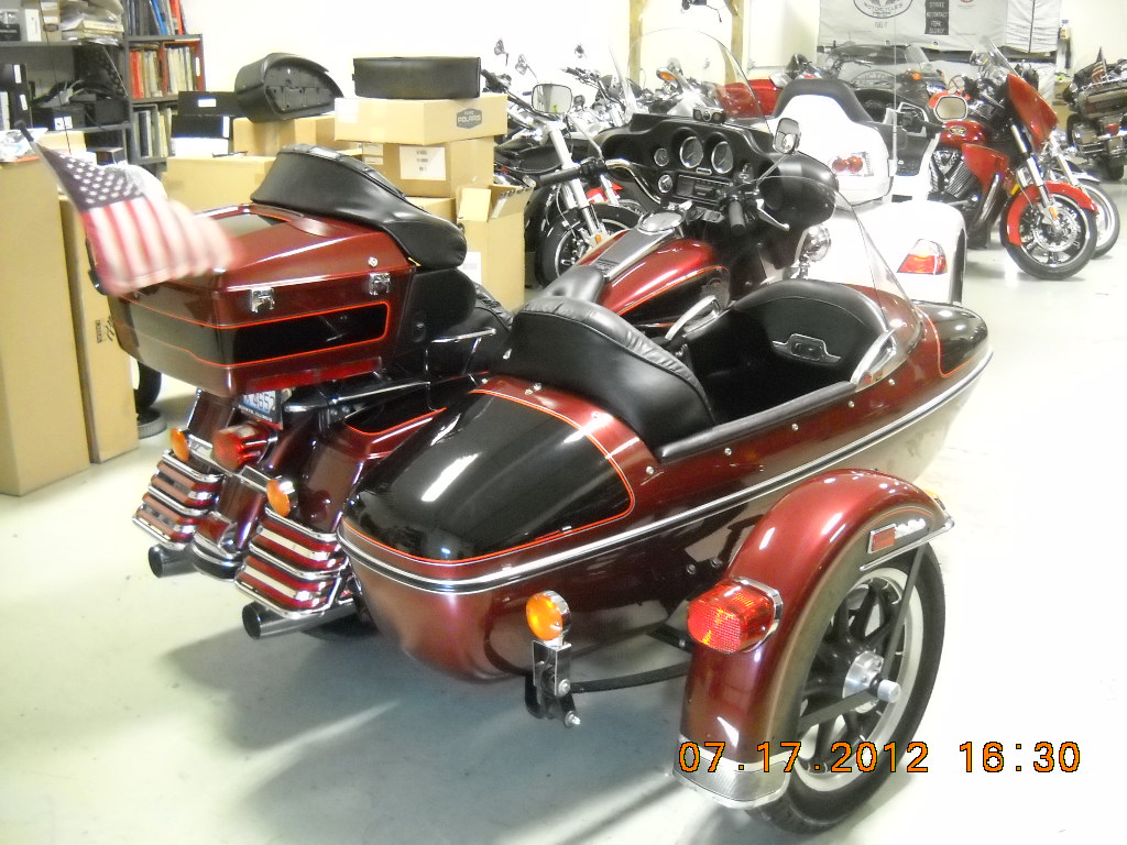

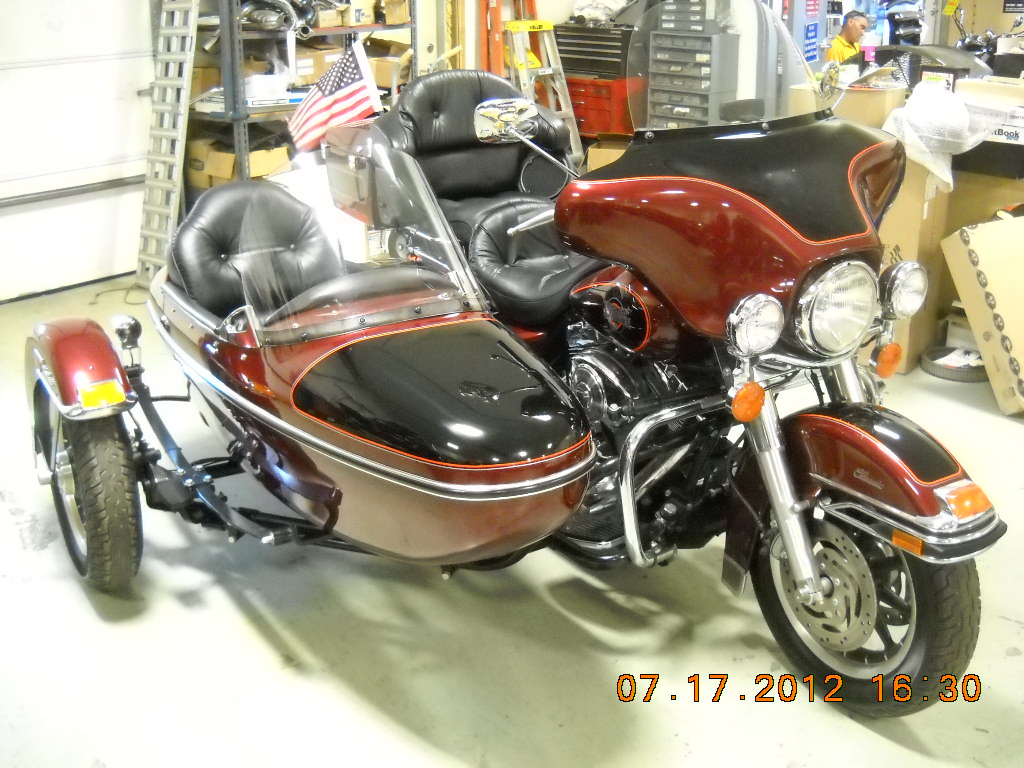

Here are a few pics

Nice looking rig, enjoy it!
May just be the pic, but the head on shoot looks like the bike is leaned in a bit, that would account for the steady pull. As mentioned above, check the alignment and lean angle.

I wonderd that since my other rig had visible lean out and tracked true. This one looks a little leaned in. I did 200 miles yesterday and my rt palm is sore from keeping constant pressure. I hope the dealer will adjust it since I just got it. Otherwise I will get the manual and figure it out.
