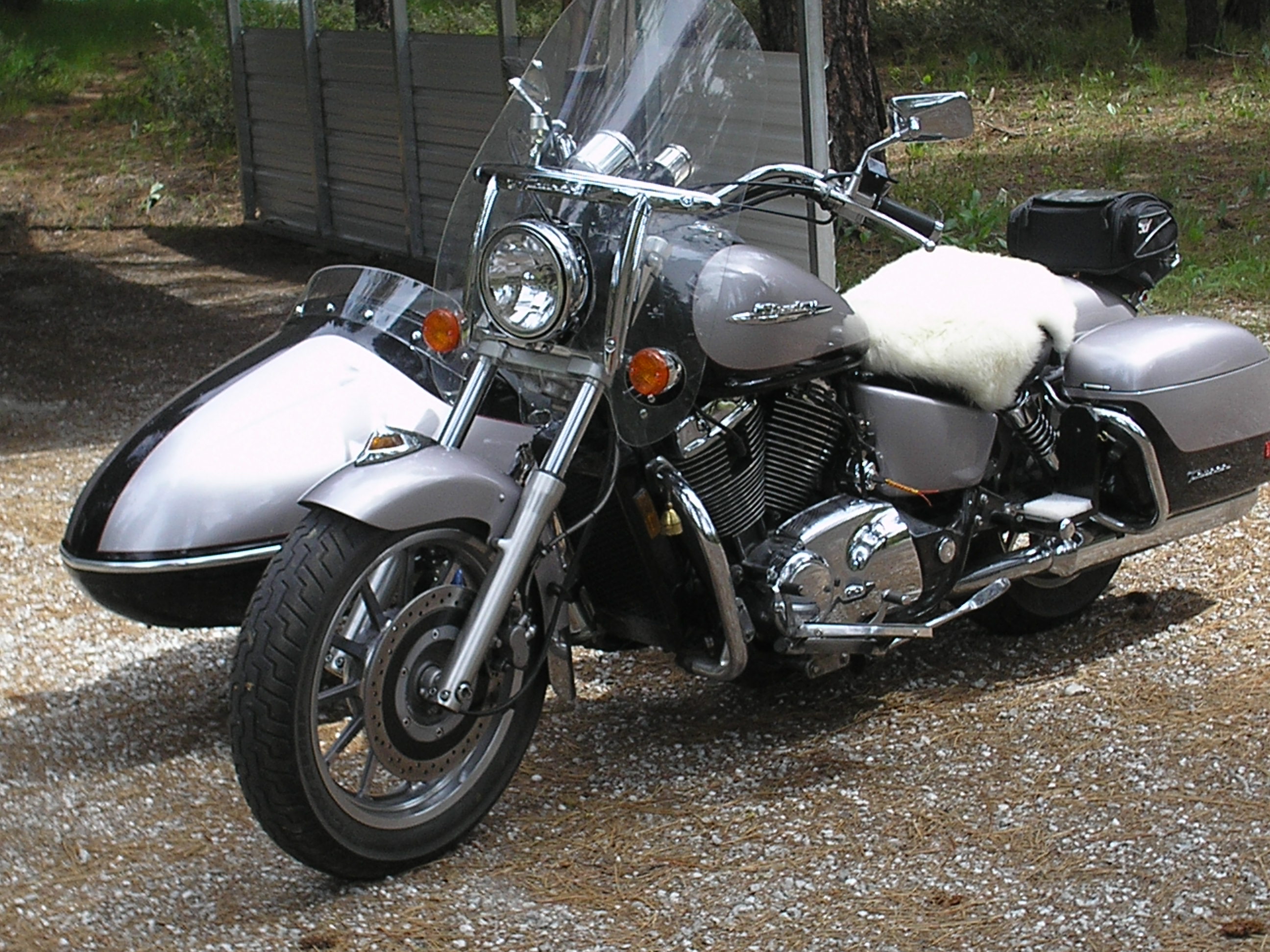

your Shadow 750 will have to work very hard to maintain freeway speeds, I have a 1100 Shadow and that's about right for maintaining and still have a passing reserve. To make it enjoyable I suggest a larger displacement bike
This one is for sale.
