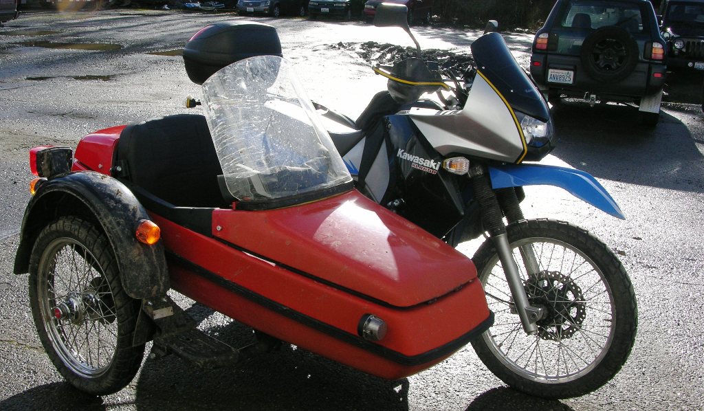

Another thing to consider, how and where are you going to ride. If it is long distance touring, rule out the Ural. Are you saying on pavement or going off pavement? Highway use or round town? One rig you can set up your self more or less on the "cheap" that will do EVERTY thing you ask of it adequately but not really all that well would be to go with a Kawasaki KLR 650 with the Sputnik sidecar we offer. You can get good KLR's in the $2500-3500 range used (new for not a whole lot more) and the Sputnik complete with mounts is only $3495. Once she out grows it (assuming she ever does) you can usually recover most if not all of what you spent to assemble the rig. I usually keep one or two around (none now) for my employee's to play with and learn on before I allow them to ride the expensive rigs.

Jay, you seem to have some great sidecars. I would just have to get a bike to go with one. I was wondering if the KLR 650 would have enough power for the mountains with the wife in the hack. We have some steep grades and strong winds here. I mean the side roads and not the highways. But then I am sure that you have been to Colorado and know what I am talking about.

The KLR never has an over abundance of power but the Ural is only 100cc larger and a lot heavier as such the KLR / Sputnik rig will be faster. As to head winds and altitude if you want to be able to pass you would need a very large bike. However this is a toy and you are more then likely only out for a day joy ride. If there are strong head winds you will not want to be out riding in them any ways as head winds no matter the bike beat you up and wear you down. Altitude in Colorado you can not get away from however you also do not need to be able to pass everything on the road either, you are out for a joy ride, not in a rush so if on some of the long hills you have to drop in behind a semi and go slow, at the end of the day you more then likely will not have been on the road much longer then if you had the power to pass them and you may have seen more of the scenery by going slower. Years ago we had friends who took a trip to Alaska together, the couple that had a Harley would end up waiting for the other couple who had a Honda CB750A (automatic and SLOW) they had a heavy sidecar and were towing a trailer. When they would meet back up the couple with the Honda would ask if they had seen this or that, More often then not they had totally missed things as they flew right by. Bigger is not always better. This is a toy, smaller light weight bikes can be a lot of fun and go places you would not want to take a big heavy bike. If you did not say you were looking to go for short rides up into the mountains and instead were telling me you wanted to go on long distance rides then the answers would be totally different. I like the KLR as they are fairly cheap, reliable, lots of aftermarket parts for them and do pretty much every thing you ask of them. They do not do anything all that great, but they do every thing. They are kind like the Swiss army knife of bikes. Like the knife there are a lot of better knifes on the market for specific duties but little that does as much. The KLR is also light enough with an up right seating position and wider bars that most people do not modify the steering (we do make a leading link front end for these) As to the Sputnik sidecar, they are not great sidecars. What they are, are great sidecars FOR THE MONEY. they like the KLR do everything "OK" but nothing great. They are also cheap enough that should the time come to sell you are not going to take a huge hit on price. The KLR Sputnik would give you a chance for not a whole lot of money to see how you are actually using the motorcycle sidecar rather then how you think you are going to use it. It could turn out in a year or two that you have figured out that you want to go a totally different way but at least at that point you will know for sure your needs.

Jay, I was thinking that something around 800cc+ would maybe be better. I am sure that you probably are right about the 650cc, but I would feel more comfortable with a bit more power. I could be wrong and would have to test one out to see. I appreciate your help! Thank you!
