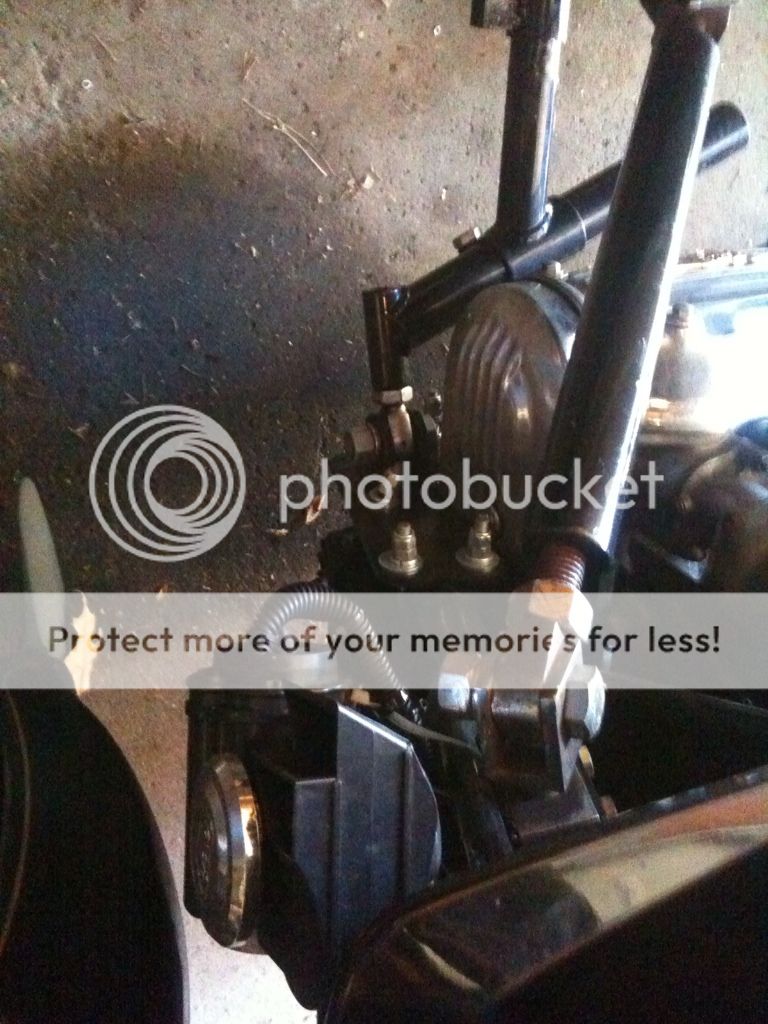

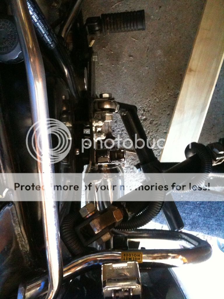

I'm not sure how well this pic will show the attachment points, but here goes.
Photobucket Pictures, Images and Photos
The upper rear is not shown. It attaches to the bike's farme near the top of the sattlebag guard.
The rear lower Connects to a Vetter clevis plate with a hiem joint a few inched forward of the rear foot peg
The front lower connects to a Vetter clevis plate slightly below and forward of the belt cover
The front upper attaches to the bike's frame tight up to the cross bar at the top of the radiator.
As Jay mentioned, it's critical that the lower hiem joints are equi-distant above the ground. The car's frame and the bike should form a hinge just like a door. And as with a door, if the hinge pins aren't aligned, then the door will "twist" when you try to close it. With a sidecar, that twist results I'd an altered toe-in.

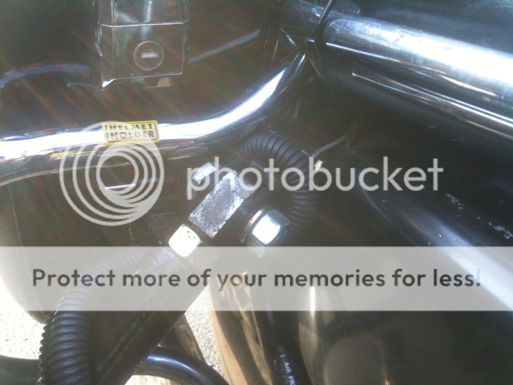

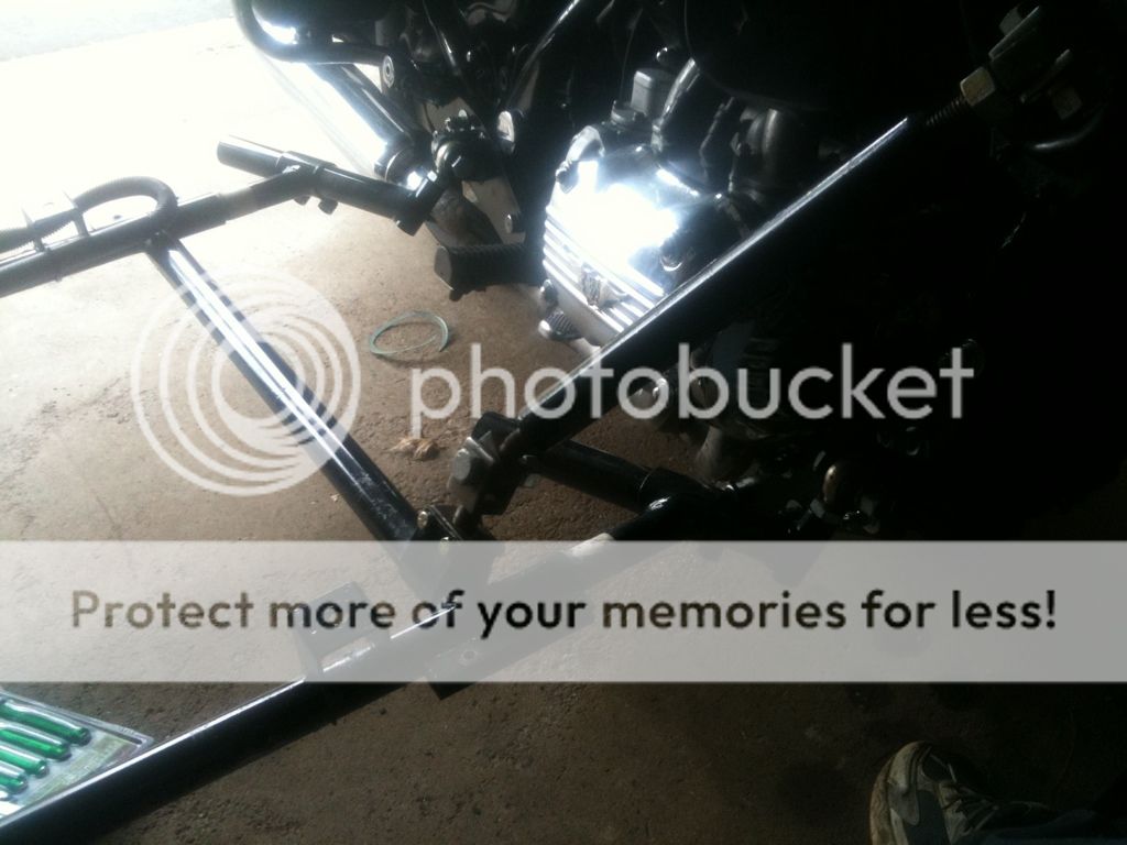

I found some more pics. I'm editing from work where I can't actually SEE Photobucket pics, so I hope these show up OK. If not, I'll fix 'em when I get home tonight.
Upper rear
Rear mounts from above
Front mounts from above
