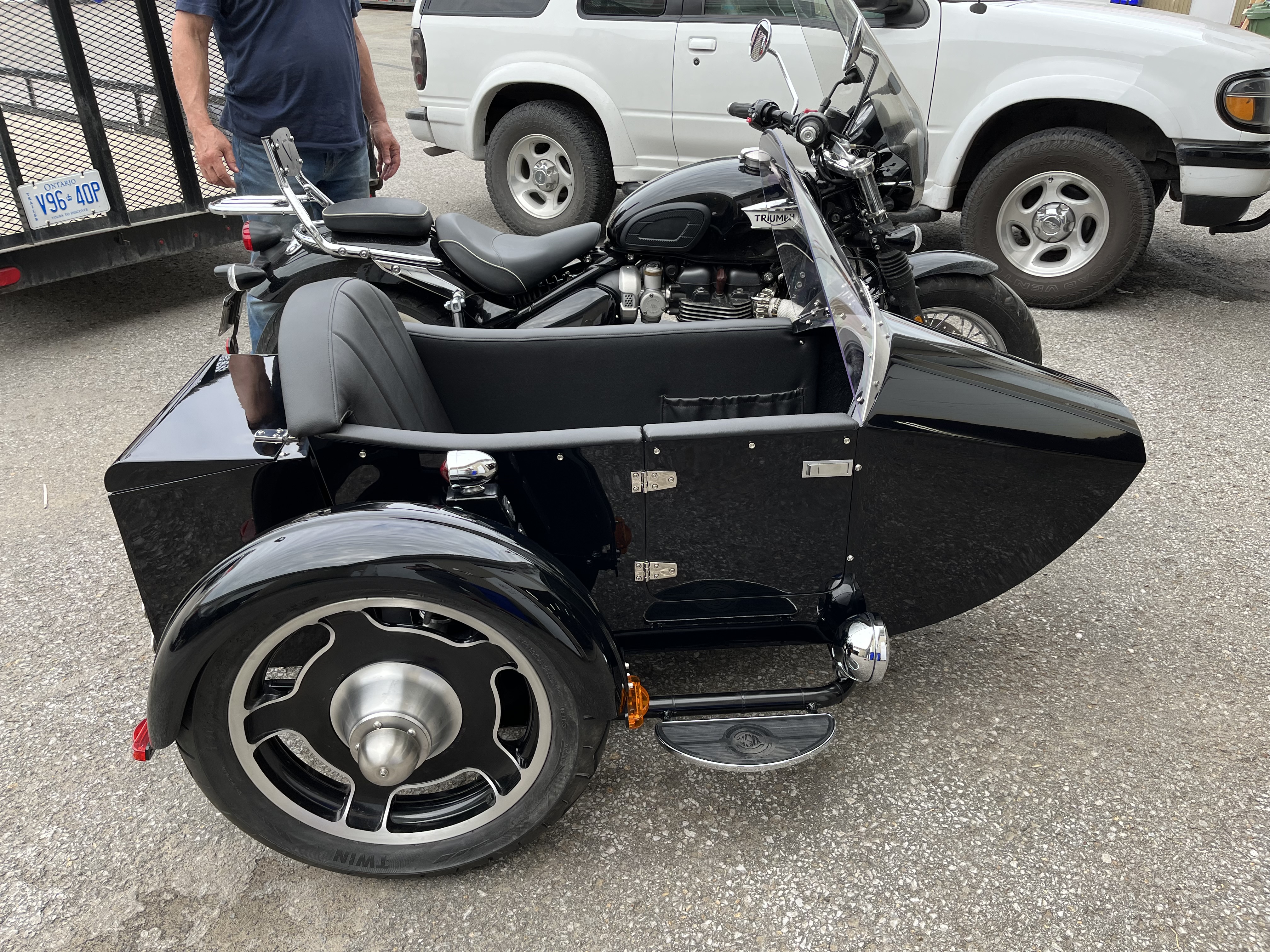

Something weird is happening and we can’t figure out why. My partner and I both ride the same rig, a 2018 Triumph T-120 with a Trans-Moto car (Canadian), professionally installed. He is 5 foot 10” and I am 5 foot 4” and we are about the same weight give or take 10 pounds. Riding with two (one on the bike, one in the car) is fine, the expected shake when accelerating from a stop, otherwise no issues. When he rides solo, there is an tremendous shake in the bars at 20 KM which gets worse as the speed increases resulting in an almost terrifying tankslapper. When I ride solo, there is nothing at that speed, although a slight shake at 40 KM, very slight, and it goes away when I accelerate. A damper is installed and changing the adjustment seems to make no difference. Could it be a geometry (physical build/height) issue? has anyone experienced this before? Any suggestions for a fix?

I notice two things in that singular picture you posted...
# 1: The front end of that Triumph appears to be STOCK, with no modifications at all, other than you states it had a steering dampener.  If in fact that front end is still stock, with no reduction of the original TRAIL, that is a problem, that CAN be fixed. Having a stock front end adds to steering difficulty, and adds to head shake, both of which can be fixed by reducing the TRAIL so that the axle of the front wheel is "approx" 2.5 inches, or 60mm forward of the original location. Several ways of doing that....
# 2: It appears that the sidecar wheel has very little lead compared to the bike's rear wheel. Generally....it is recommended that the sidecar wheel be a bit more forward than the motorcycle rear wheel. I can see it is not as far BACK as the motorcycle rear tire, but IMO that is not much lead....meaning...IMO it should be more forward than it is.
Much easier to address item # 1....than to address item # 2.

Thank you for the response. Good noticing about the stock front end and the position of the sidecar in relation to the motorcycle. We will get some more pictures posted.
In the meantime, we did a some testing today.
1) Specifically, I, the short one of the two of us, am 6 pounds lighter than my partner so say the scales.
2) we added weight to the seat of the sidecar. We started with 50 pounds and each took it for a ride. For my partner, the shake at 20 KM/hr was almost gone; the very slight shake at 40 KM for me was totally gone. We increased the weight to 70 pounds and shake no more, albeit the expected. We are both smiling wide.
Thank you again for your suggestions. More to come.

Well, I have an explanation for why the extra weight reduced the headshake but let me the first to say that I don't like my own explanation! LOL
If you lower the bike's frame in the rear by using a shorter shock, or a softer spring, or by loading it up with weight (making it "squat"), this will act to reduce trail because the angle of the forks changes.
But for that to happen with only 70 lbs of ballast?  Seems unlikely.  But maybe.

Aby, as you stated, you added weight to the seat of the SIDECAR...and the vast majority of sidecar owners find that added weight helps them. Many find ways to keep permanent weight in the sidecar, but it is just as easy to add a 50 lb, or 80 lb bag of sand, like the sand tubes...in a bag.
Okay, you found a "bandaid" to remove or reduce the head shake, but if you want to make it even better, and more permanent, give serious consideration to reducing the trail on the front end of each bike.
Those of us on these forums are well educated and well versed in the different methods of reducing trail on bikes, and whilst there are several different ways to do it, it really comes down to how many dollars you have to spend...to make sense of what you are doing.
The least expensive way will cost you approx. $ 300.00. The next step up will cost you approx $ 1,200.00. And the most expensive way will cost you approx $ 4,500.00. Now, reality.....the best way is also the most expensive way, which is having a set of Leading Links built for the bike. It will handle like a dream, much easier to steer, better driveability, and that will last the life of the bike.
But not everyone can afford to put out $ 4,500.00 for a Leading Link front end.
My personal recommendation, if the dollars won't allow you to spend that combined $ 4,500.00 for a Leading Link front end custom built for you.....is to buy a SET of trail reducing Triple Trees (we know people that make them), and install them yourselves onto the bike.
