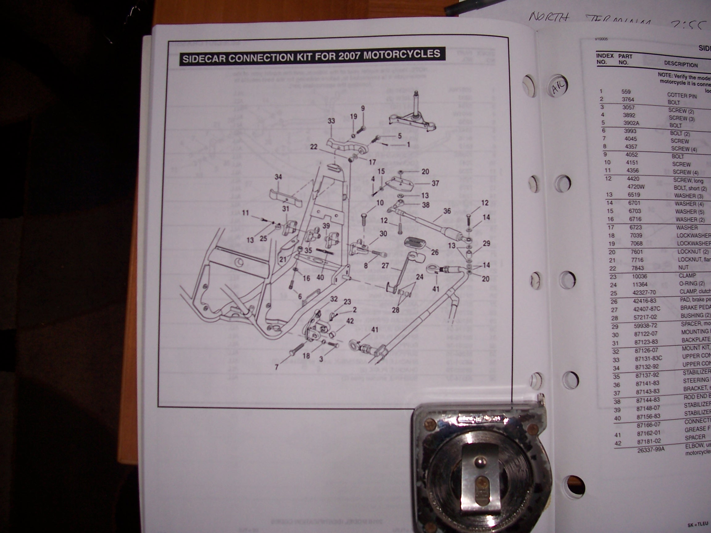

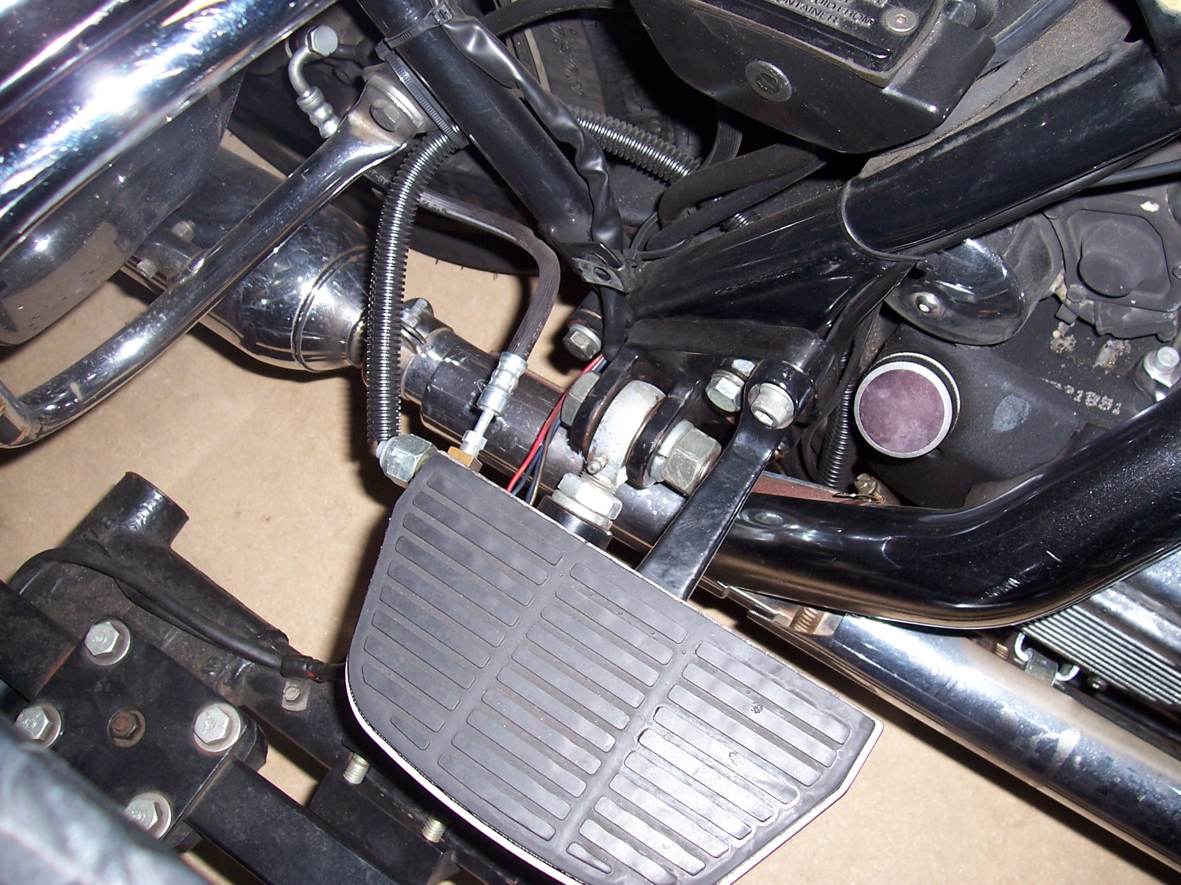

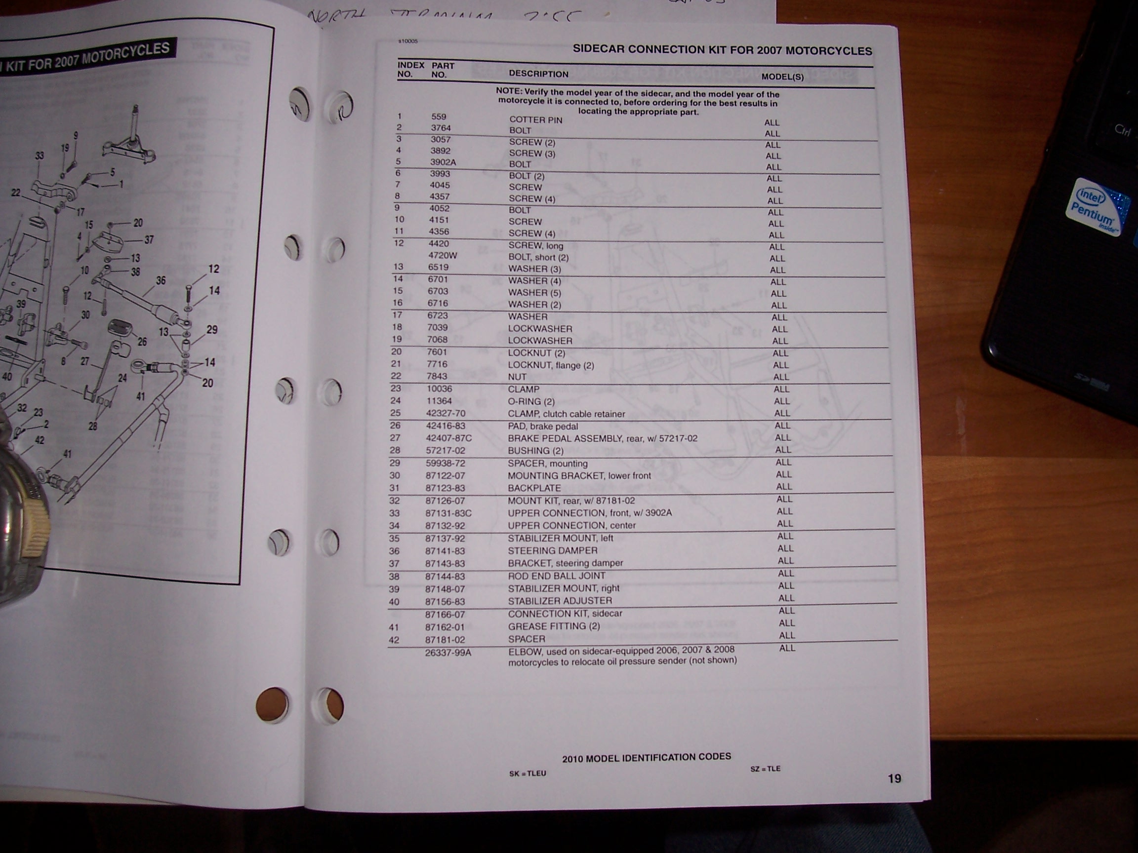

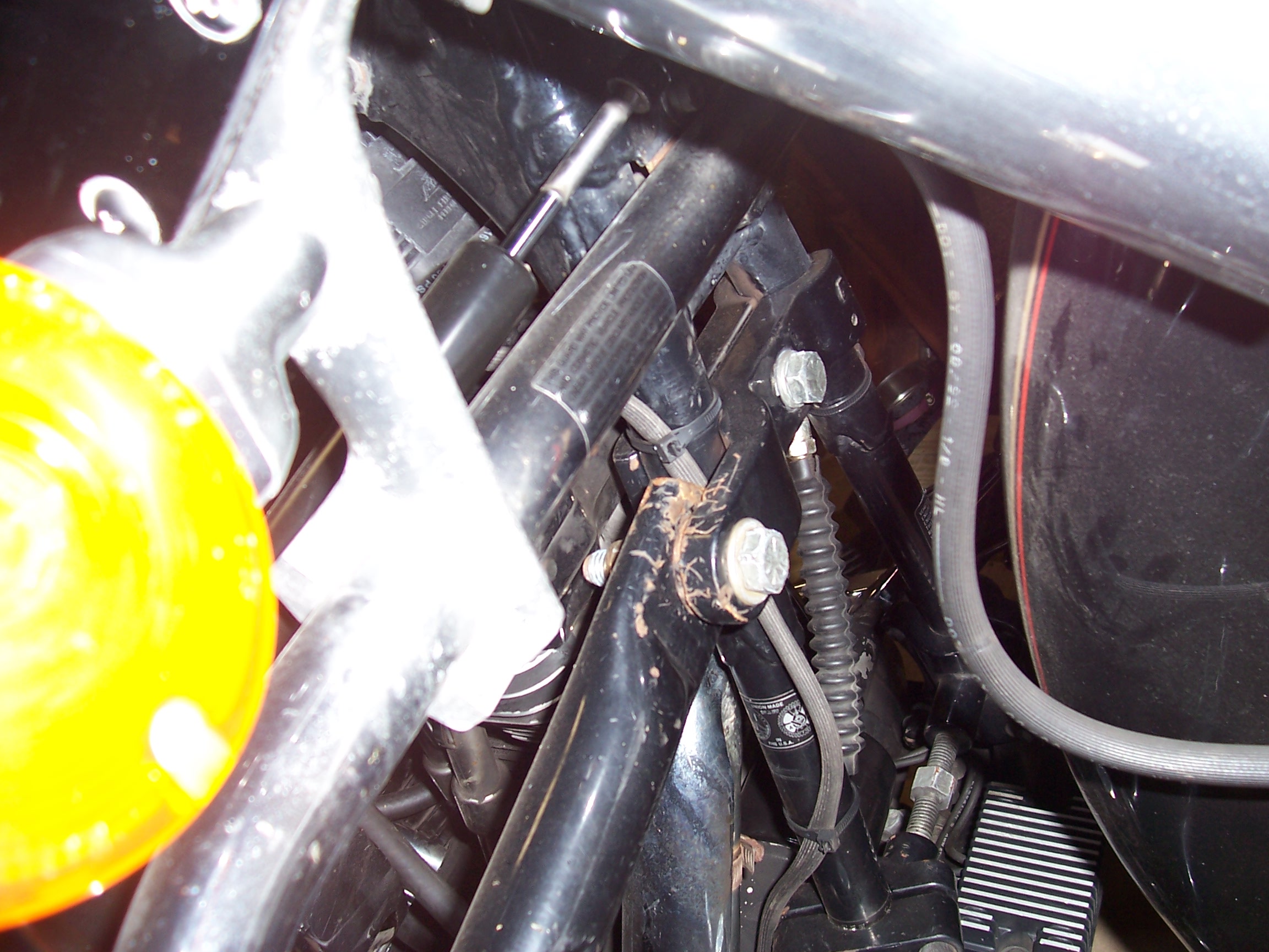

Mine need some cleaning and touch up paint but here are some pictures of standard Harley mounts on my 1993 Tour Glide. The first picture is the upper front mount. You can also see the front lower mount at the bottom of the picture. The lower front mount consists of two clamps on the down tubes joined by a threaded rod with a clevis on the right side clamp. The second picture is the rear mount. This part replaces the existing rear passenger footboard bracket. The next picture is the connection kit drawing from a sidecar service manual, its a little newer than what you need but the picture represents the parts well. The parts list won't be all the exact part numbers for a 95. The picture looks bad here but if you download it or open it you should be able to read it.

The attached PDF file will give you more information about the standard Harley mounts, it should be correct for a 1995.
