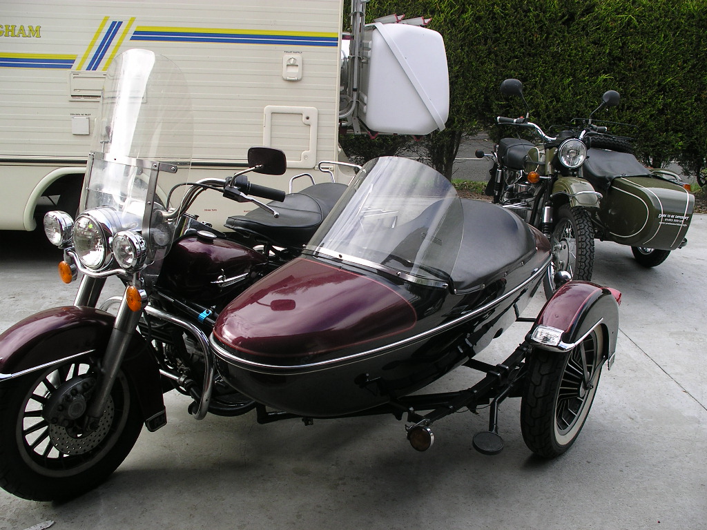

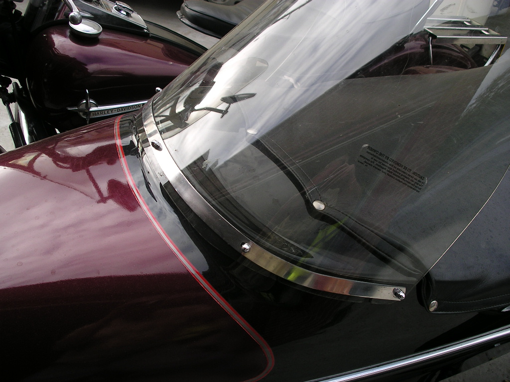

Hi i had the same trouble previous owner had cut the original windshield down, i obtained a screen for a tle & re drilled to fit works ok just needs a wider trim but old trim is ok if you dont draw attention to it. i'l try & post a picky later. Hank

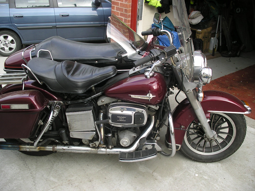

as promised some pics, you can see on the close up that the tle screen sits lower on the tub i was going to trim it but i think it's ok, centre hole is ok so i got a pal to sit inside & drill outward as i held screen in position. Hank

no such thing as left hand harley hack that was a serious cut & weld project. i wish i had had the forsight to run a thread like wngnut

well, well, u have one very "unique" rig then! u done good, it looks factory to me. but u know, most sidecar rigs r unique! people r always doing something different with their rigs, something that u hardly ever see anywhere else. a very small minority in the motorcycle world.
btw, i had an old road-king windshield that i cut and redrilled for a hack shield (just today. it is good to know that i can use a late model windshield for my hack tho.
