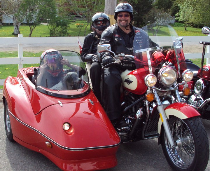

I finally got it figured out and It's very cool . I know what to expect from a rig now and I can still do the highway at 65MPH with reasonable comfort. I actually commute to work on some days 75 km one way . It doesn't like stop and go traffic in the heat but It manages due to the liquid cooling. As you can see almost the whole family goes including the dog. Thats like an 800lb load!
Posted : July 12, 2011 6:25 am

No... the window is perfect height and the passenger hardly gets any wind at all. See perfectly
Posted : July 12, 2011 9:57 am
