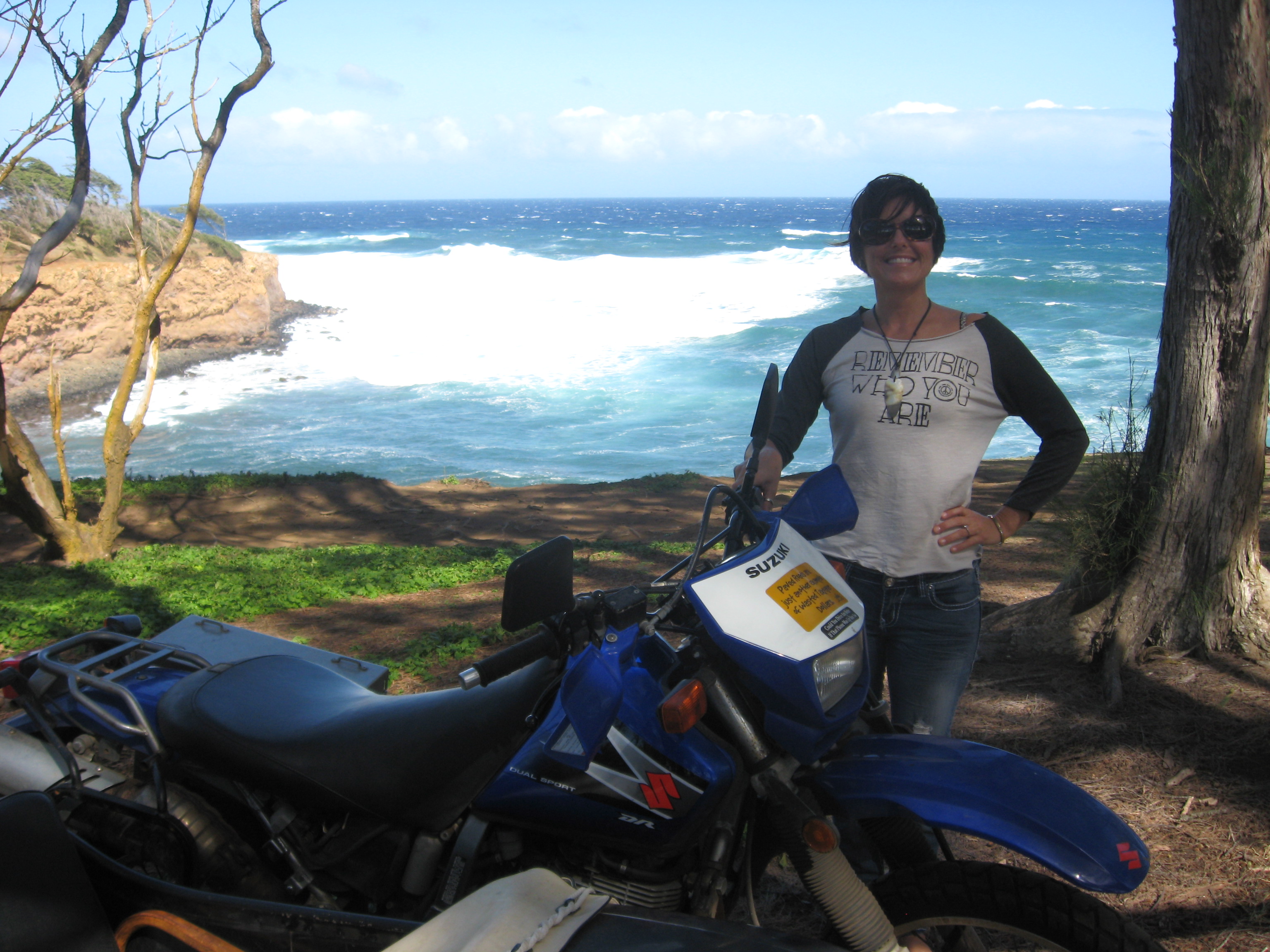

Having just put on the third front tire and fourth rear tire, I decided to lower the final drive again.
I had been running 15X48 for two years having used 15X46 before that. I had noticed that on an up hill in the rough, really rough, I had been slipping the clutch a bit more than I liked. I just put 15X49 on with new chain of course, and for the shakedown took a pretty girl down to the lighthouse waterfront.
That one more tooth made a lot of difference in tractability. The problem is that on these grounds there are a lot of places where very slow is needed to prevent grounding on sharp lave rock. The 15X49 offers this slow speed with a lot less clutch slip.
It allows me to enjoy these trips a bit more.
