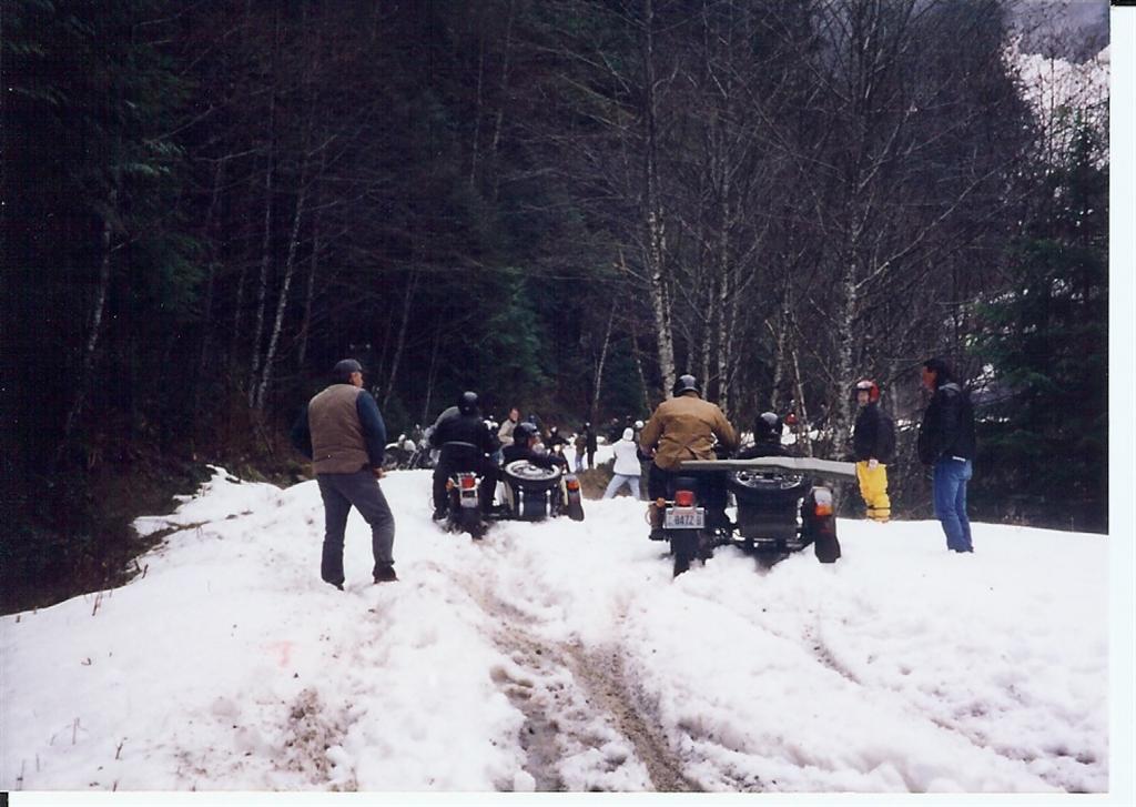

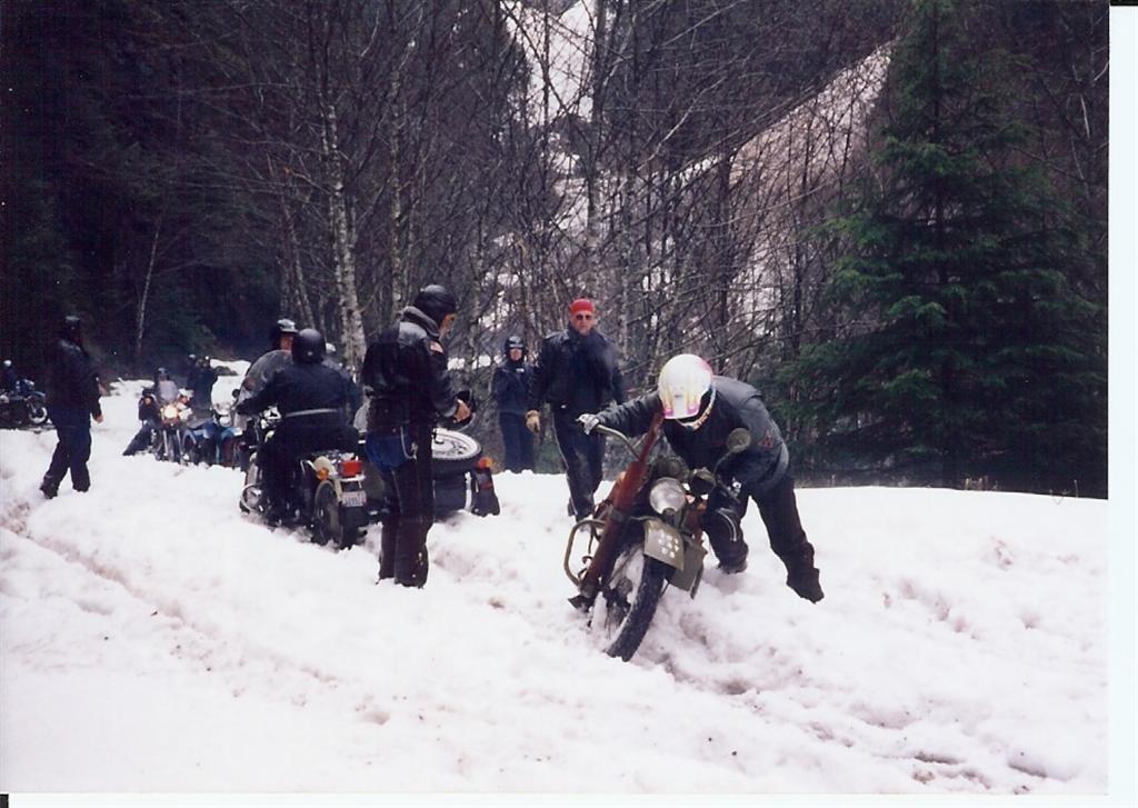

I found that the 2 wheel drive URALs,Dneprs and CJs weren't necessarily the best option during the 1998/99 Bonehead Enduro in the Washington Cascades (Oldest Entry at 66 years).
My XJ650 Maxim Yamaha/URAL rig got farther up in the deep snow than any of the 2WD rigs that had full knobby tires. They just plowed in and dug themselves into a high centered position while we just blew over the top with more horsepower.
Drove a '50 Panhead/URAL rig the next time, it didn't do as well in the snow.
