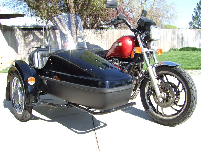

Take a look in some of my albums. Hack'n's Hacks
Here's 2 I have for sale at present.
