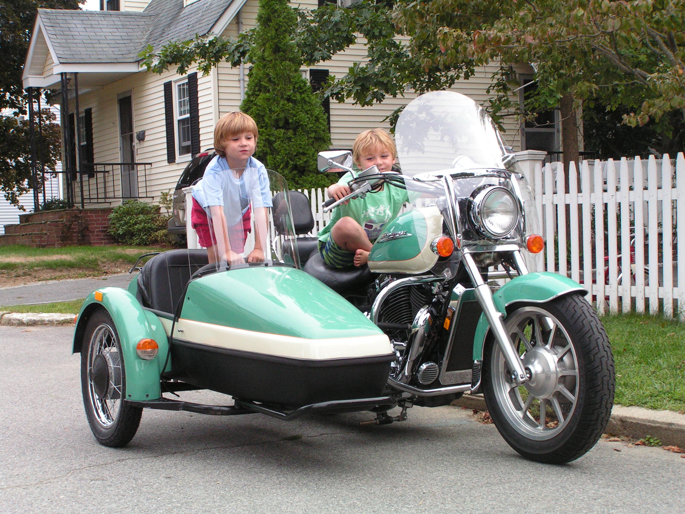

I ended up buying 2, 50# bags of cement mix. They're nice and heavy as well as compact. I wrapped them up nicely with heavy-duty trash bags and duct tape. I also bought an assortment of barbell weights and wrapped them up so they are nice and soft. I had my first ever ride with a sidecar this past weekend...just around the block a # of times. I plan on practicing this weekend in a large paking lot, then I'm good-to-go! What a great feeling it is! Thanks for all the help. I'll post some pics when I can figure out how to do it...I had some problems.
Dave
Posted : September 14, 2010 7:29 am
🙂 Nice looking rig; and the kids look healthy too!
