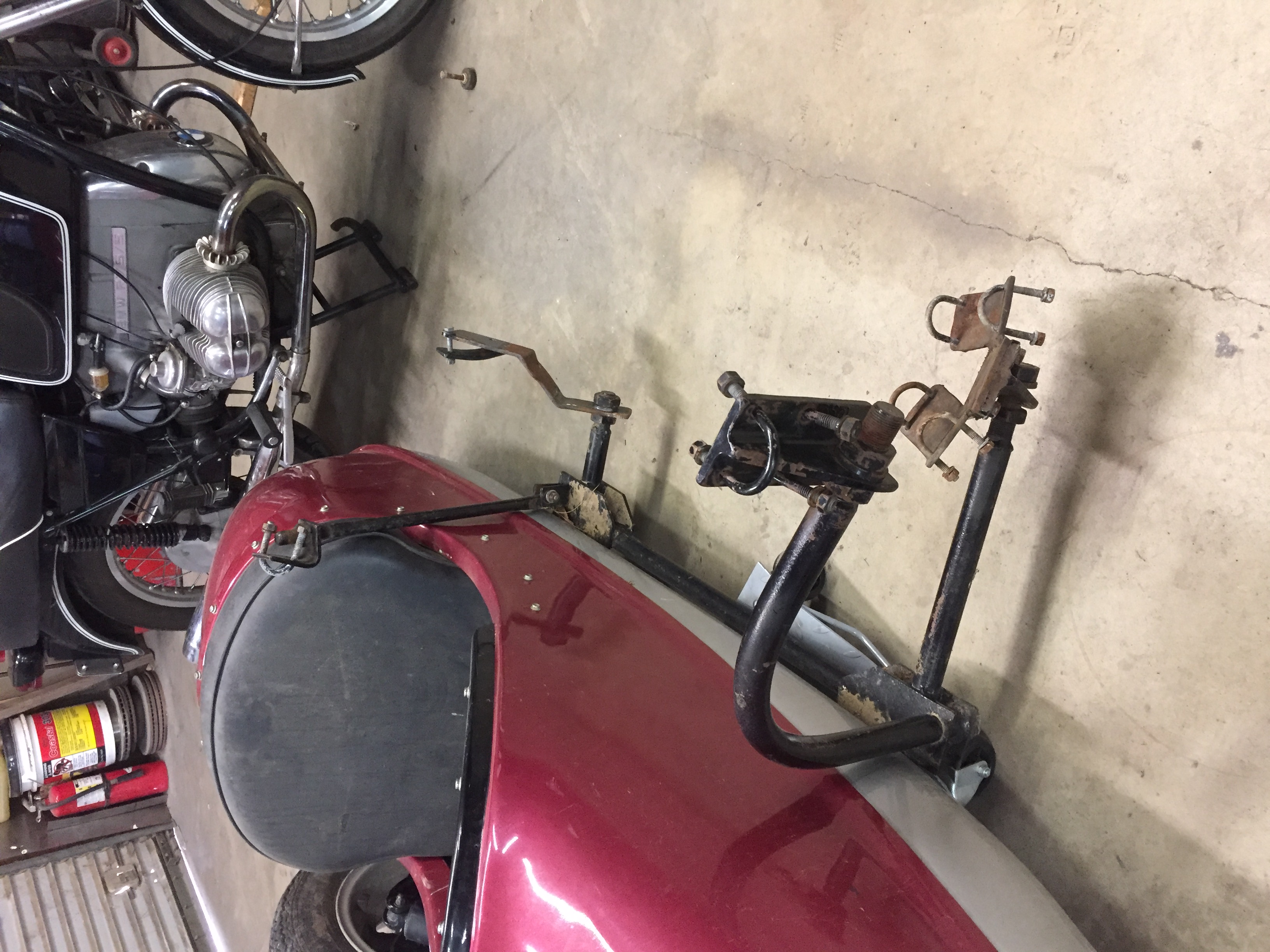

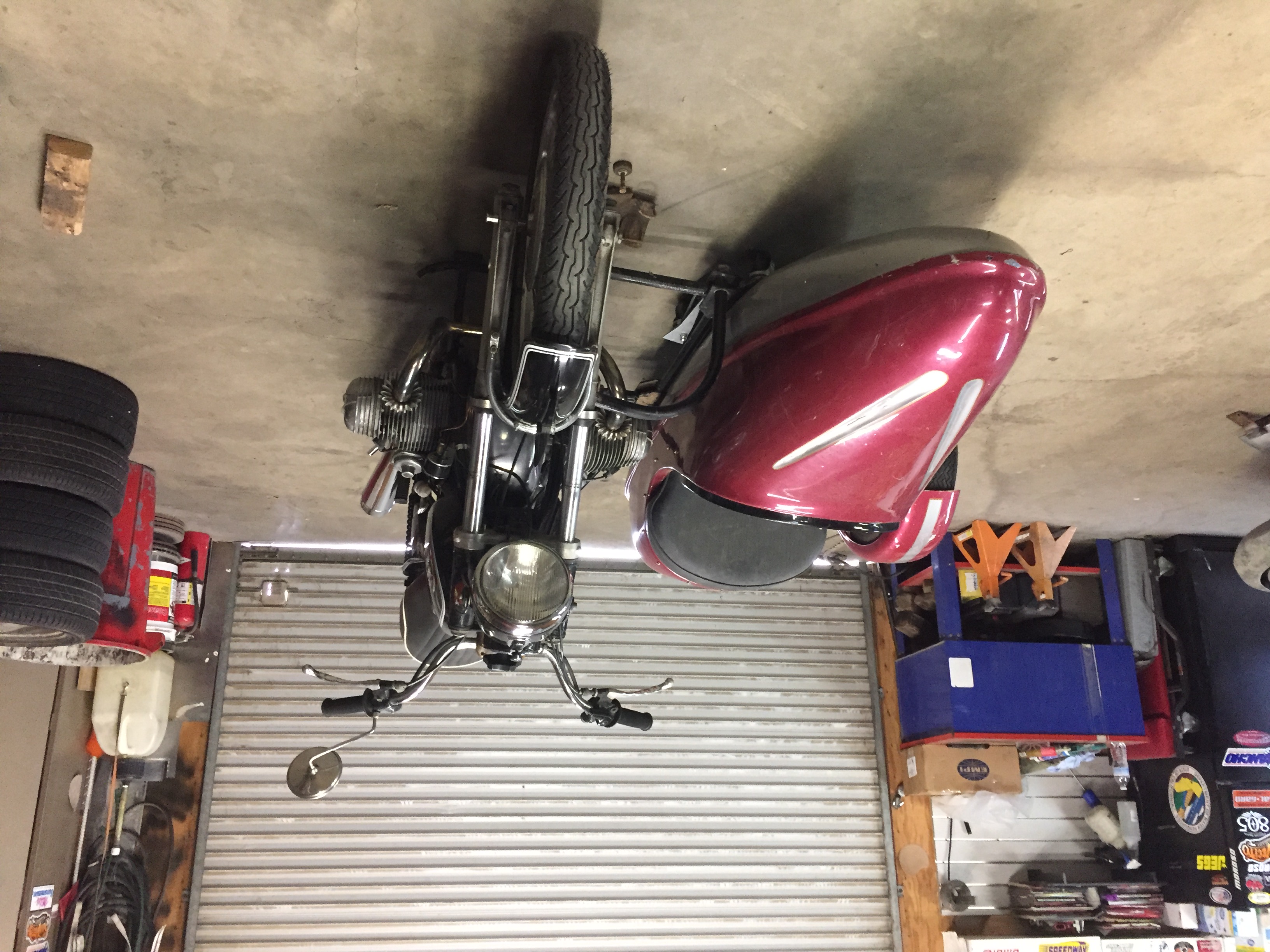

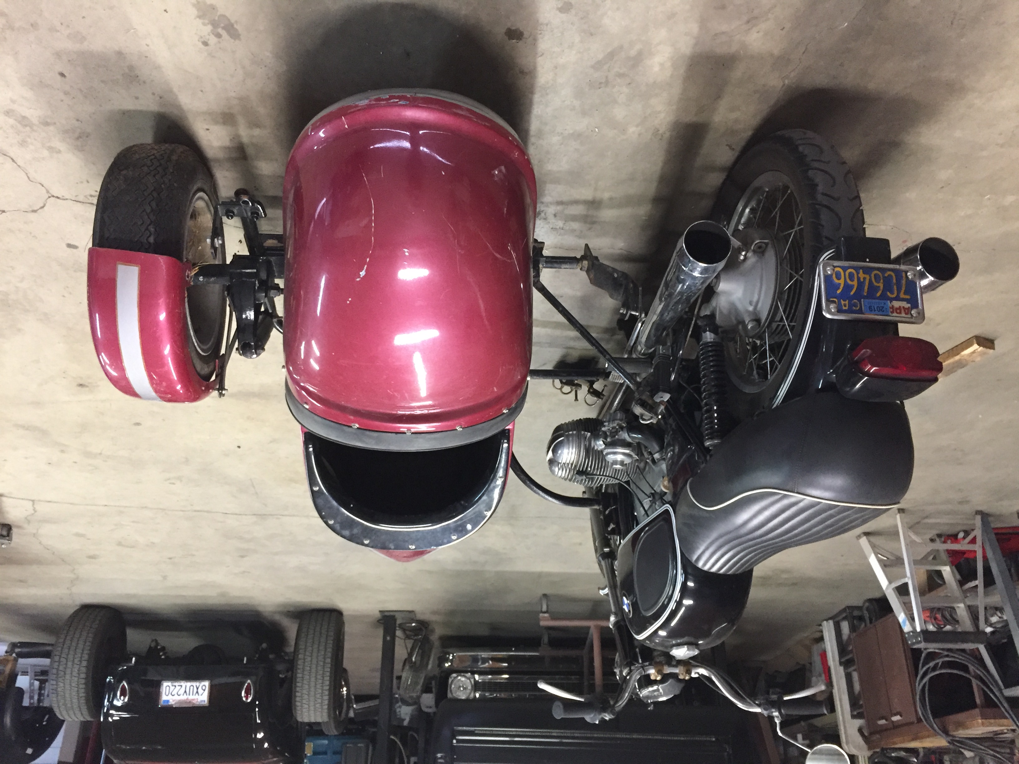

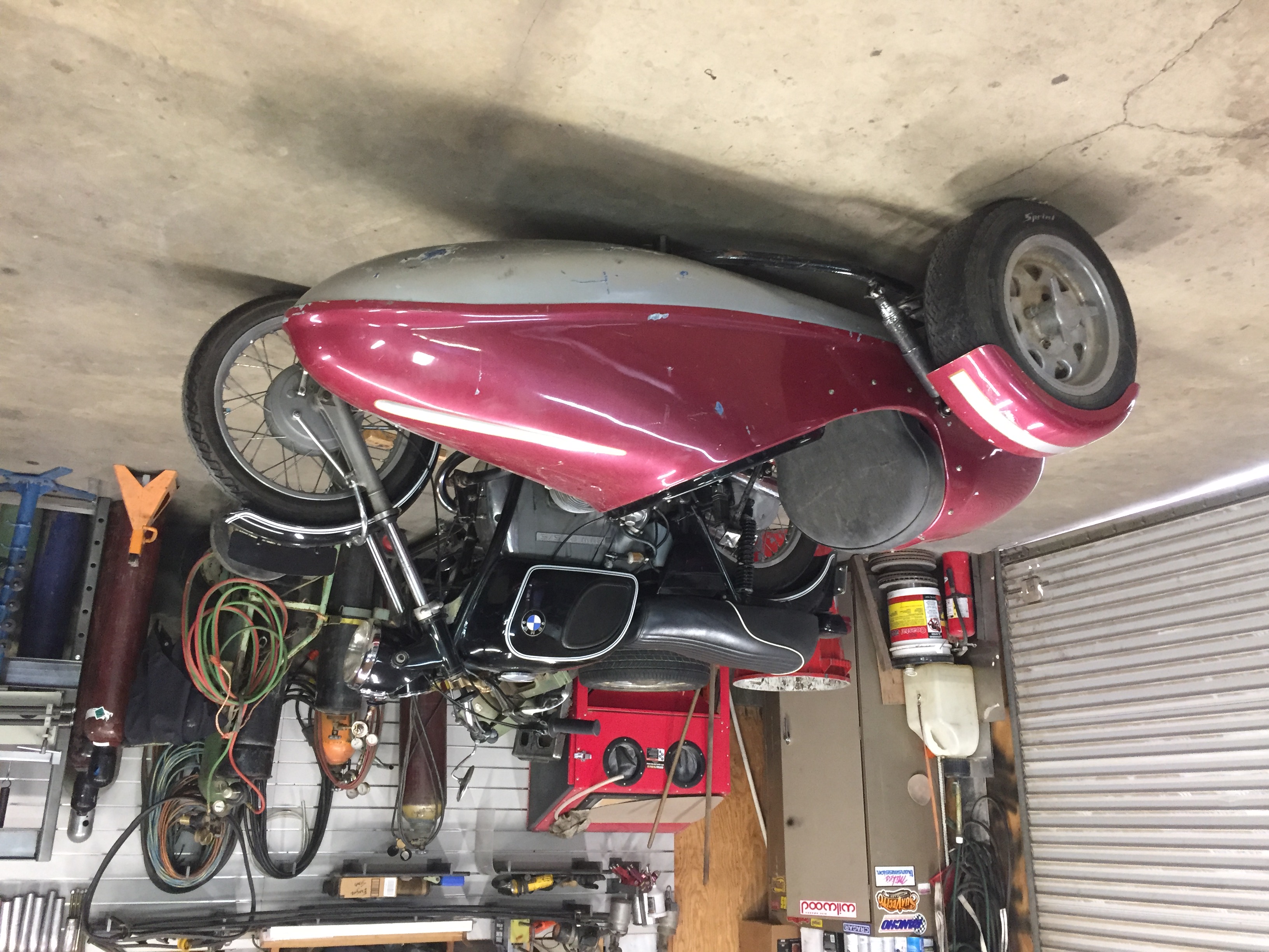

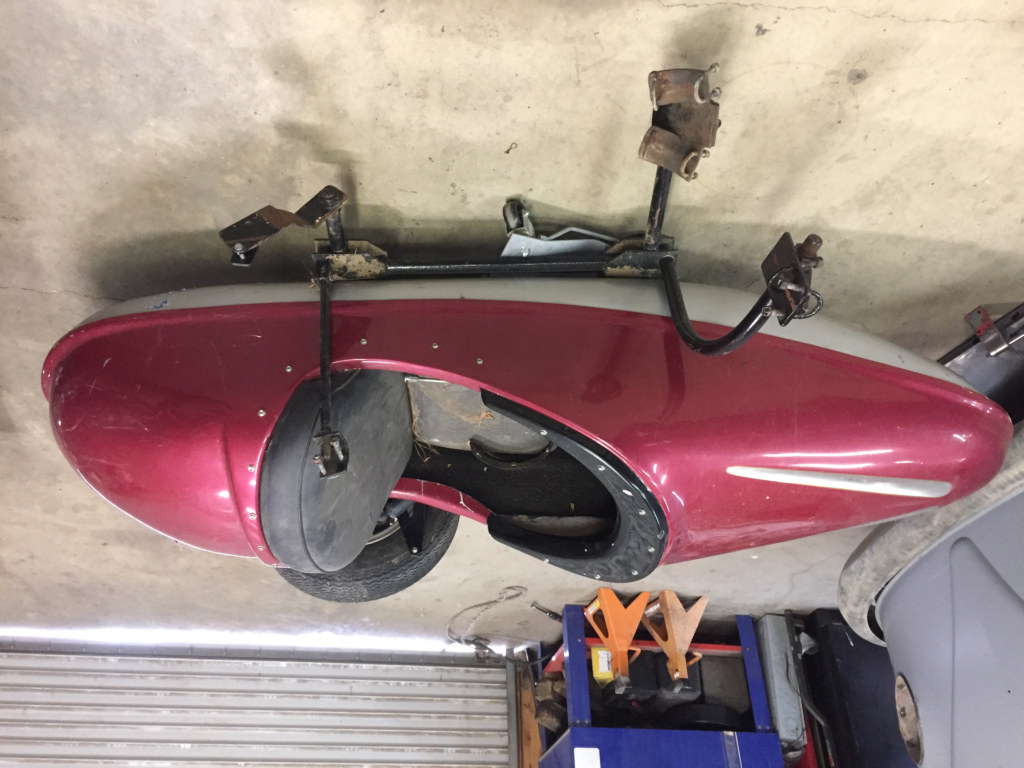

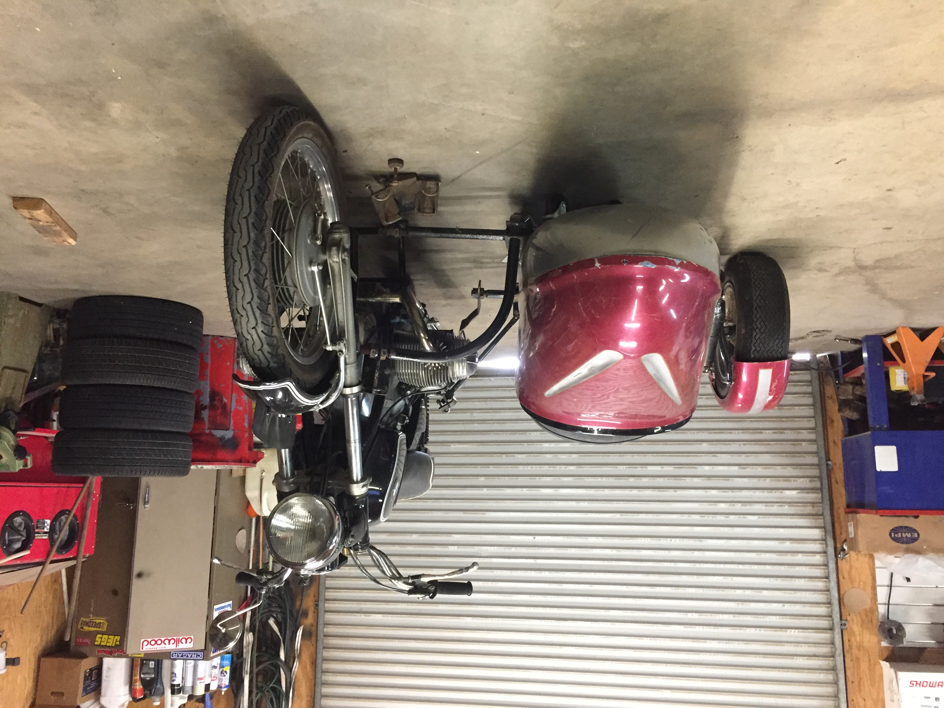

Good day to all, new to sidecars and this forum. I picked up what looks to be set up for a Harley Davidson. I have researched sidecars the last few days but can’t find anything that resembles this thing. There is no ID tag that I can find, only stampings are on two plates that say USS (guessing its the steel companies casting). I’m thinking about mounting it to my 71 R75/5. Research has shown that a subframe is needed as the factory frame walls are not thick enough to support the SC. I’ve been to dmcsidecars website and see that they make a kit but haven’t been able to find pictures.
Any input on the manufacturer or bike configuration is greatly appreciated.
I’m not 100% on mounting this thing, if someone is interested in a purchase or trade, I’m open to that.
Mainly looking to gain information and knowledge so I can make the best decision I. Regards to this build.

Hi Mike:
Yes - you will need a subframe. It will involve bolts or members of some sort that tie both sides of the frame with the top mounts - both front and back. The important thing is that your bottom two mounts be the same distance from the ground. I didn't have that piece of information when I mounted a Watsonian GP to my '86 R90/6. Every time I made an adjustment on the top two members it changed the toe-in.
As I recall I tied the front and rear bottom motor mounts together with a piece of 1/4" flat bar and used a similar piece of material that U-bolted across the rear frame tubes behind the battery box (or was it through the battery box) As I recall I had to relocate the bike battery. On the upper front I U-bolted similar stock across the front frame downtubes. That mounting was done in the early 1990's so my memory is fuzzy on the details.
I don't have a firm idea on the sidecar although it looks like a Swallow - made in England. It will be a good weight match for the R75 but you will benefit from a lower gearing in the rear of the Beemer.
Welcome to the forum. You will find a lot of good usable advice here. Membership in the USCA - who sponsors this Forum is always an option.

Mike,
I'm not expert but I believe that it is an "International" but to be fair that design has been "splashed" several times and there are several variants. Either way good luck with your project.
Posted : May 7, 2018 5:52 am
The sidecar is an international as Al stated. We can help with the needed sub frames for your /5. Do not attempt to use "univeral" type clamps for two reasons, one, your down tube is oval, not round and second the frame tubes are your bike are a lot thinner then you would think they would be. These frames are known to fail when just clamps are used.
