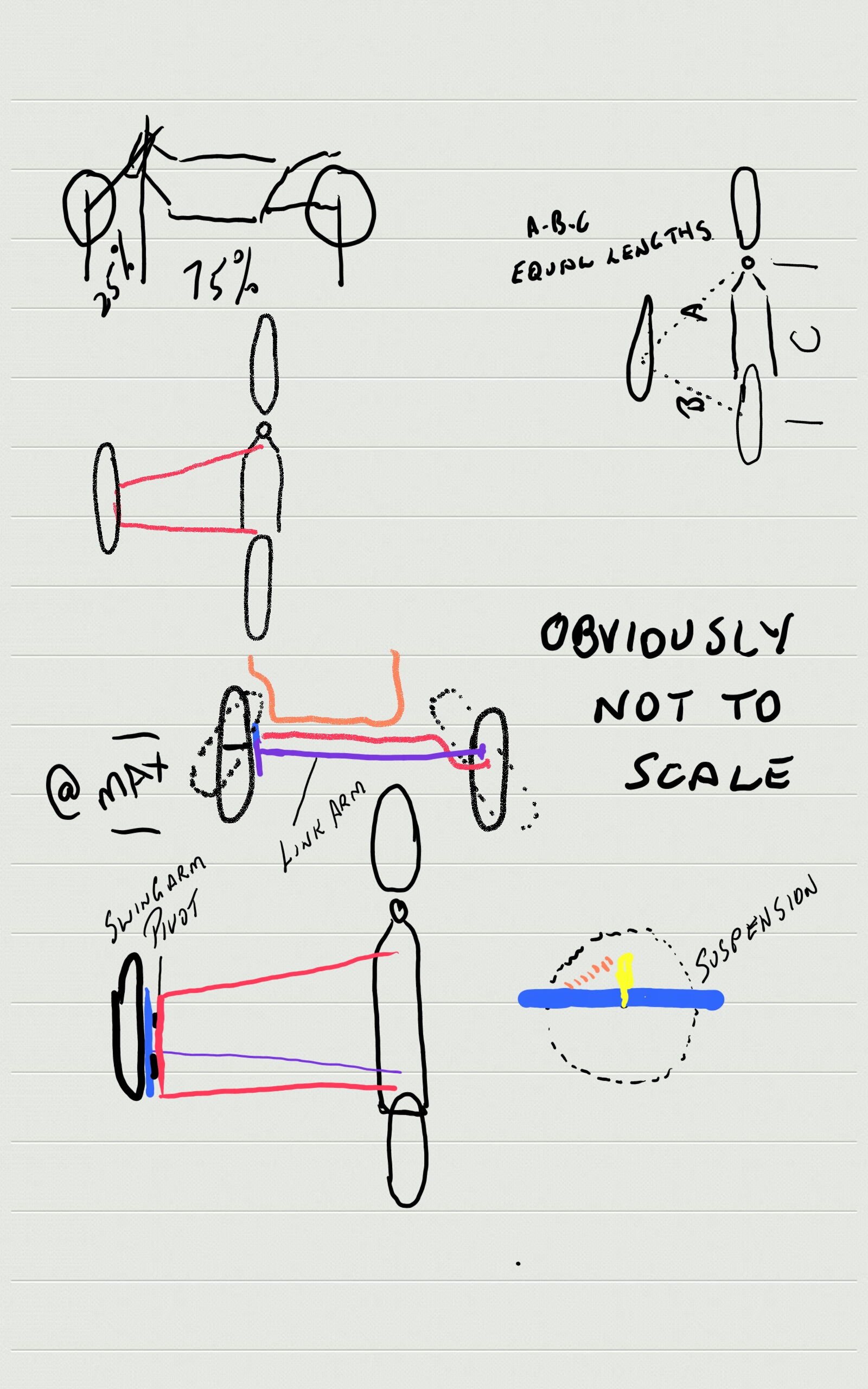

here,s the final design, in my head anyway,
I,m sticking with the triangle, having moved the front point back to the head stem to rear wheel measure point, mainly to stay in Australian build standards parameters concerning machine widths
have dropped the leading link, till the outfit is built and tested at least,
I will be using a 19" wheel for the chair, so pivot point heights will be worked off that,
and will be incorporating the trapezoid into the front pivot point to push/pull the front of the unit into the corners

Geof, a scematic drawn by hand would clear up a lot as we have had here quite often.

I re-read your original post.
Sounds like a mix of unison leaner and hybrid leaner.
> the bike will lean as per normal as will the chair wheel,
This sounds like unison leaner unless only the chair wheel leans not the chair itself. (Not sure this will still be called unsion.. semi-unison maybe?)
This is typical in hybrid leaner design achieved by setting front pivot point higher than rear pivot point.
Then as the motorcycle leans the front of the sidecar moves further than the rear horizontally resulting in yaw motion of the sidecar.
I did this when I built hybrid leaner out of XS750 and Velorex 562.
Posted : June 24, 2014 5:27 am
The proper name I have since found out , is a parallel leaner
The outfit will have a double swing arm if that makes sense, an arm that will move up and down for the suspension built into the swing arm that will pivot with the bike, that will make the Tyre lean.
the bike and chair wheel lean as one via a link arm fixed at a point under the bike and a point on the outer swing arm, the chassis and tub will sit the same height as the axles and not move Have done some very rough drawings, just got to get them on here somehow.

Take a photo (if too big make less pixels with a photo modification program).
Enter into edit your post and at the lower left corner of the edit screen you find add-remove an attachment, follow the instructions and done.
Good luck, Works well with a computer, should work with several telephone software, accourding to Murfey's law doesn't work with my telephone...
Posted : June 24, 2014 5:53 pm
Try this
Posted : June 24, 2014 6:09 pm
Try this,, I apologise, I,m not an engineers drawer
