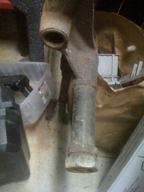

Here's the pic of the frame I have so far. I'm not even sure which end it is, but it's what I have so far. I'll post pics of the bike tomorrow when I can get some in the sun.

That's the lower front mount. We need more pictures of the rear end of the frame opposite the portion showing in the picture.

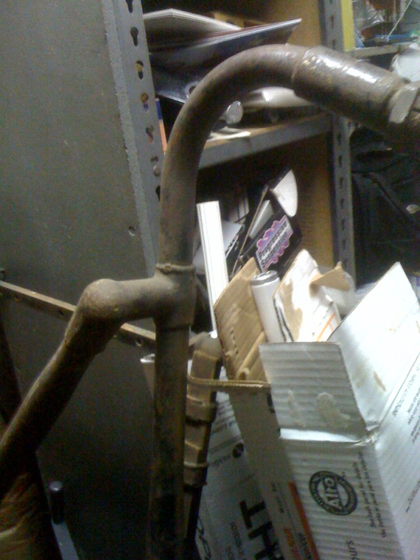

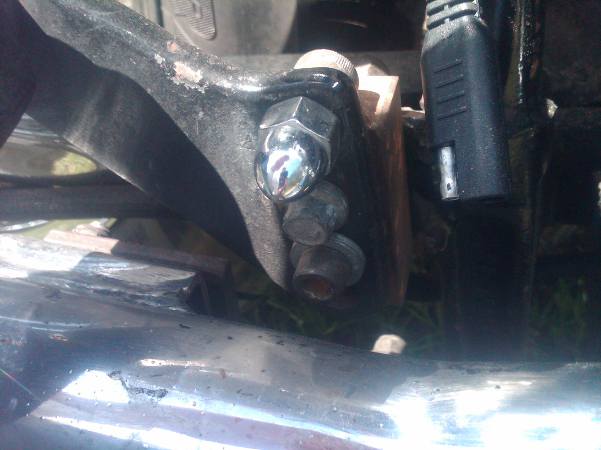

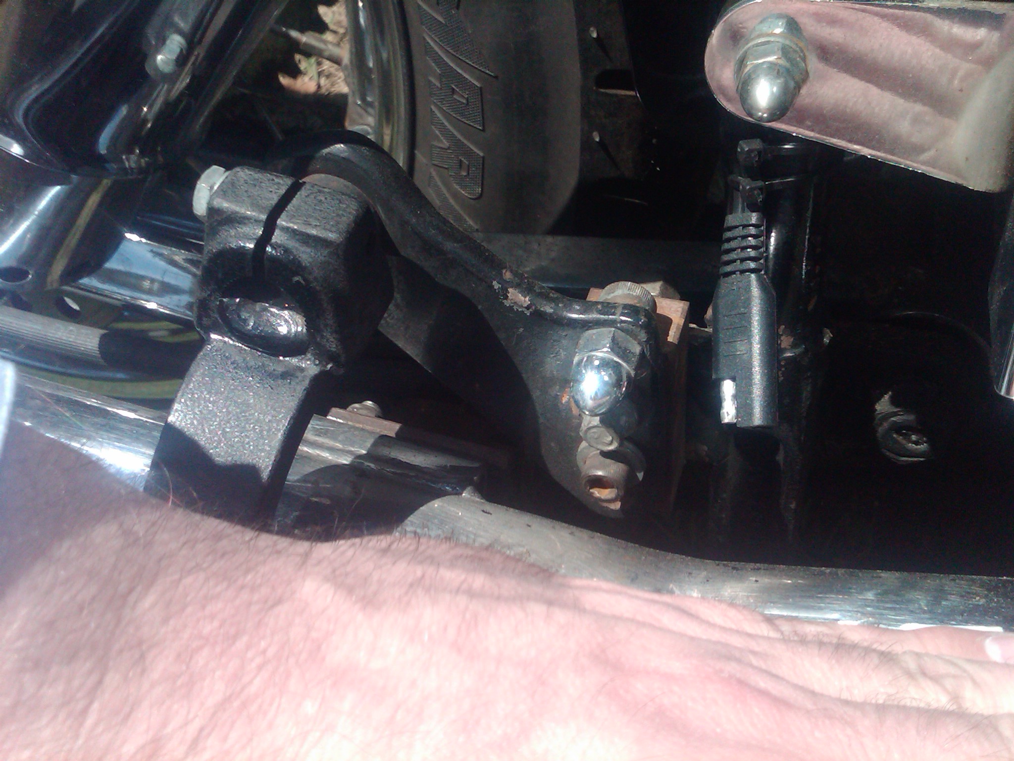

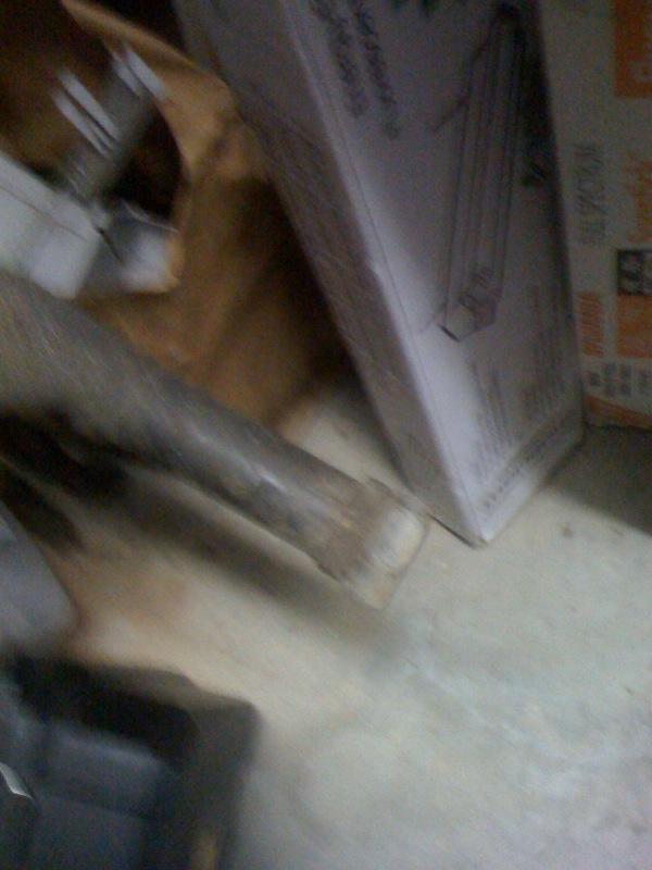

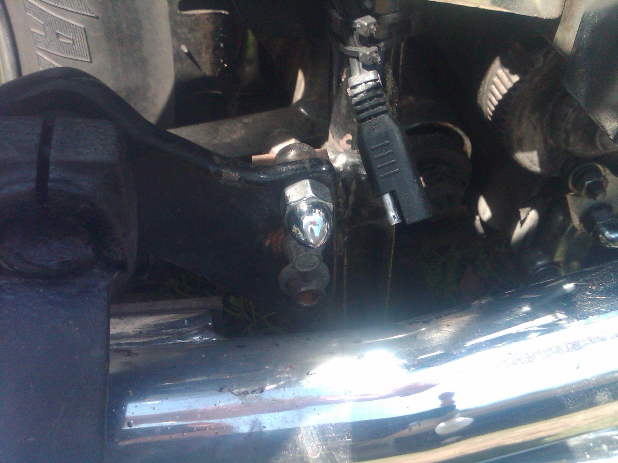

Okay, got the pictures. Sorry about my arm in the pics of my bike, I was trying to block the glare off the chrome. The first two are the rear mount pictures from the seller, the last three are of my bike's rear passenger footpeg mount.

I can hardly tell about the configuration of the frame from the extreme closeup nature of the picture. If I had to guess, the frame appears to be OK but I wouild need a shot of the whole rear of the frame to be certain.
The bike frame is good. It has the two bolt pad with 3/8-16" holes so you are good to go there if you can locate the 1980's HD mount with two holes and a large threaded coupling.
That threaded coupling mates with the part of the frame shown in picture two, but as I say, I'm guessing since I can't see the overall frame.
