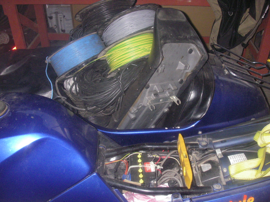

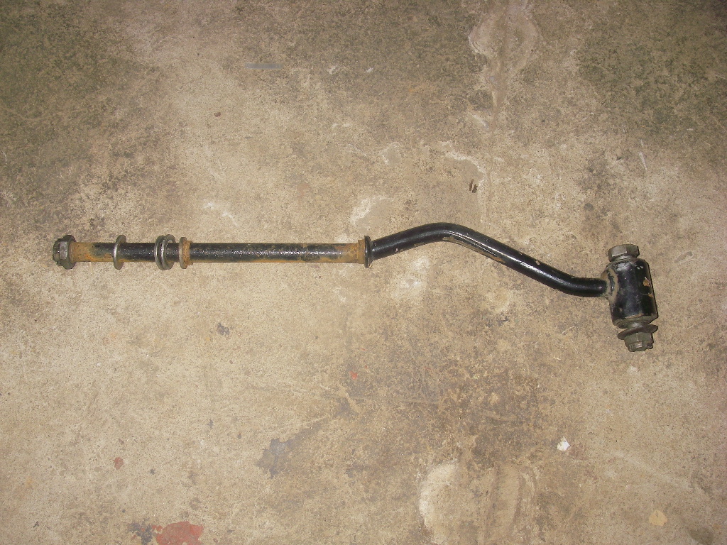

1731,1737,1738= tie down and level out to normal weight riding levels for to get accurate reference measurements / Negra, asking: "when can I ride again?"
1740= the most impressive part of the rig. the main beam that supports most of the sidecar load. As tough as the 15mm sidecar wheel axle!

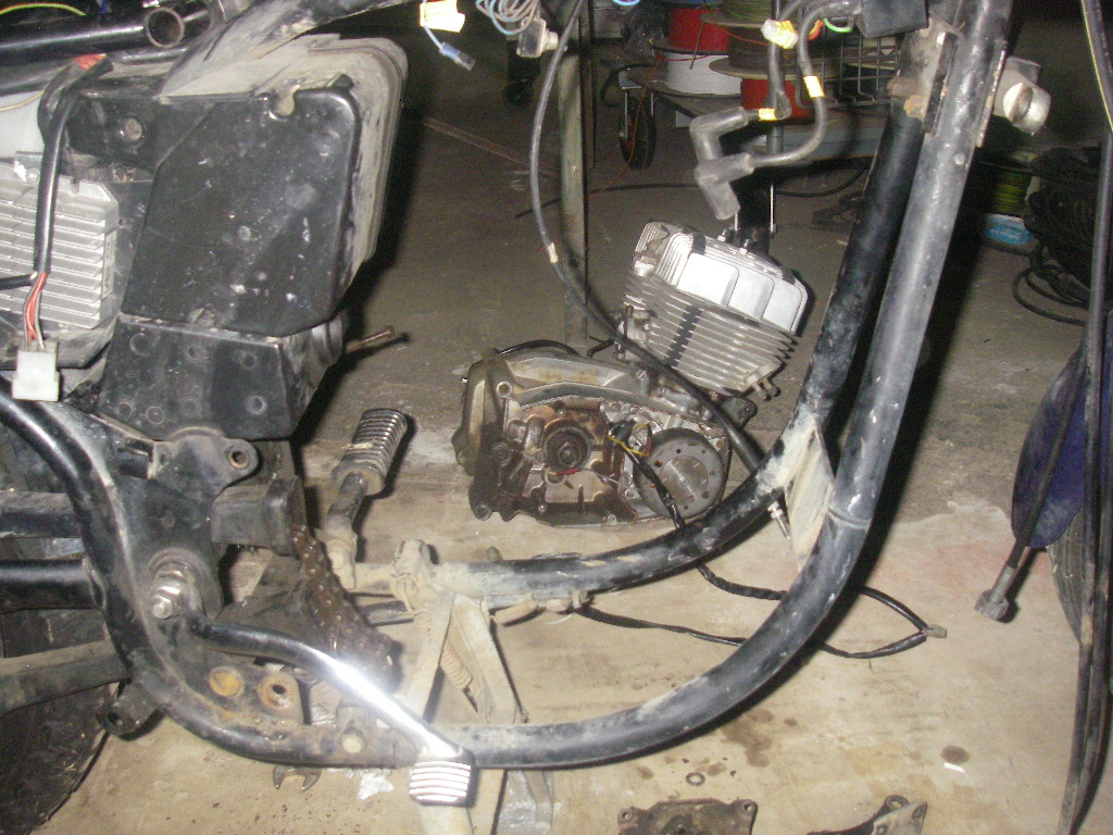

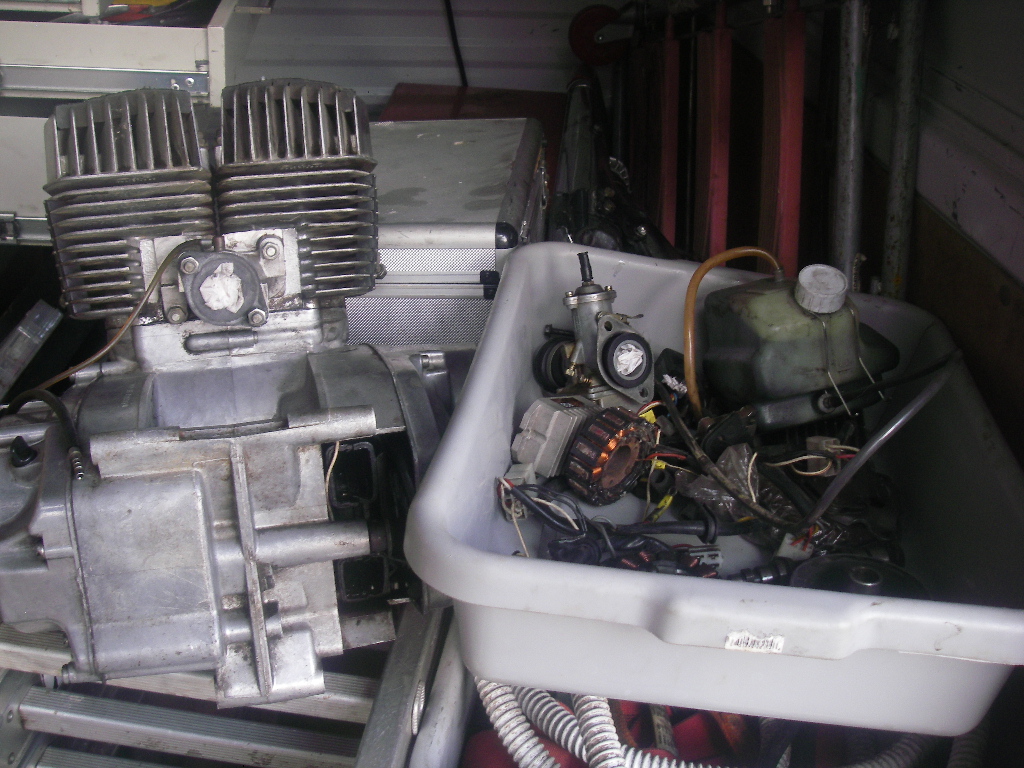

1743= good bye Wendy-engine

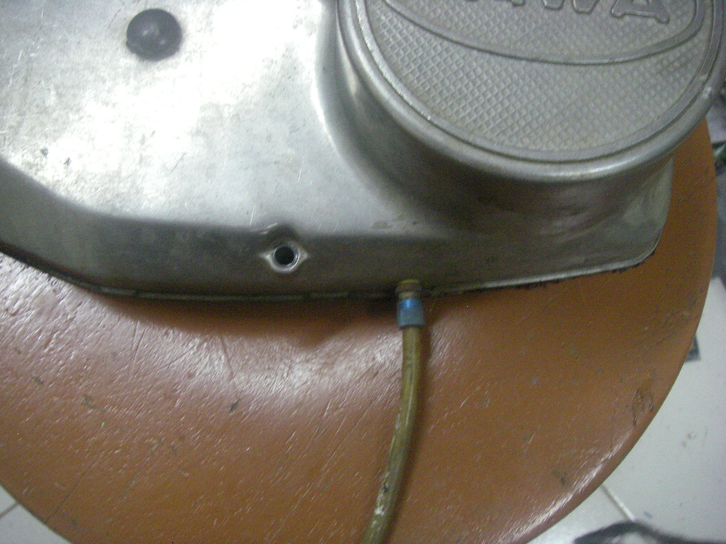

1745= "the" trick for to save ignition coils. Before this breather hose the water when crossing rivers got trapped inside the alternator housing and rot the coils once and again. After this tiny hole and hose the thermal vacuum got broken and when water came in during a river crossing after few miles it was evaporated and out again. With some goretex it would have been perfect. but this hose worked excellent since 2005.

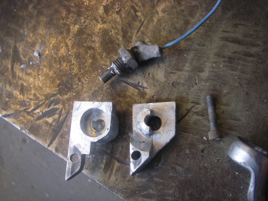

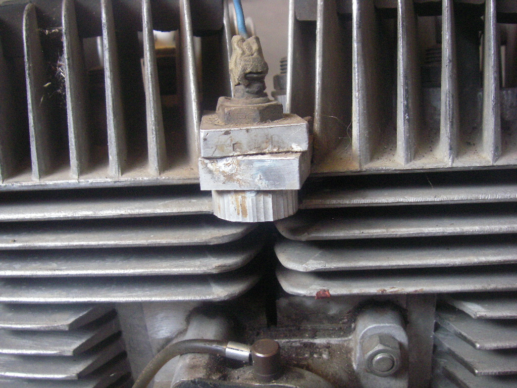

1747,1748= the temperature sensor for the 2 cylinder heads. above 155°C the danger for the pistons was very close. 120-140°C was regular driving temperature. 80-100°C I would get only in rain. The sensor and meter were still from my 1983 CB650 and have at least 140.000 + 36.000 + 25.000km= 201.000km and the last calibration check gave only 3°K max deviation.

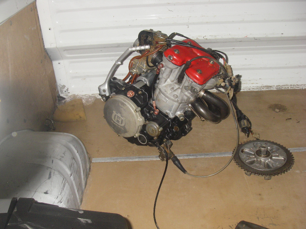

1752= Wendy-engine on her way to serve as spare part donator.

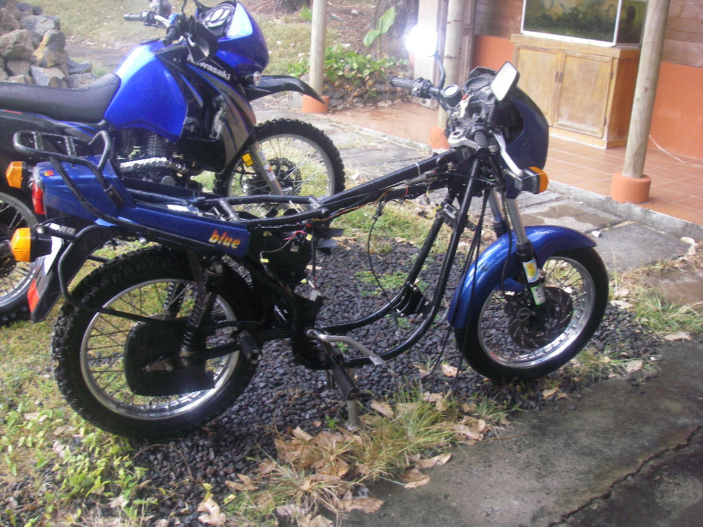

1753= how fragile looks an empty frame!

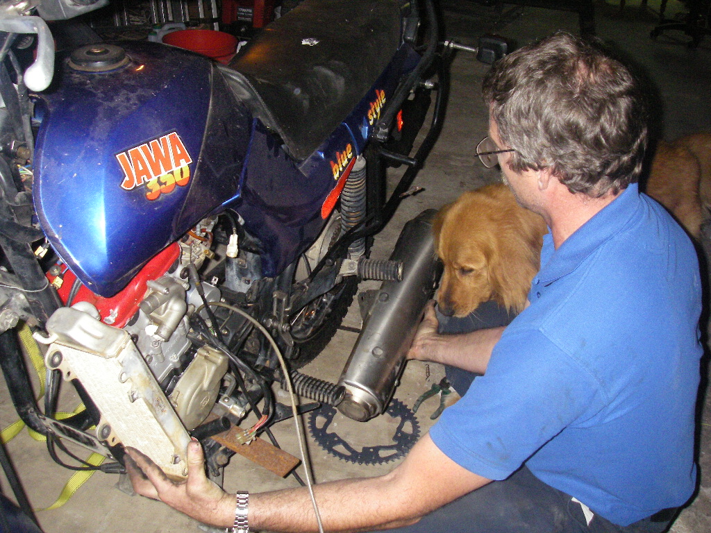

I cut off the first engine base ear and the blind inspector (the Golden Retriever) assured it is the way to go.

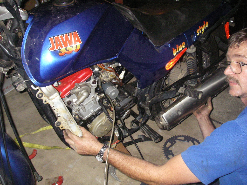

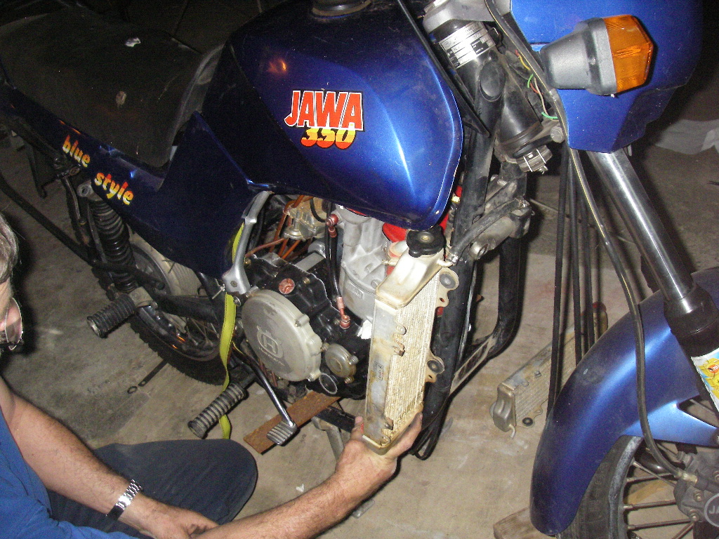

So here are a few pictures off the first fitting test.
Perhaps even the Jawa's air filter box can be reutilized.
The Husquarna engine weights only 36kg including carb = 10kg less then the Jawa engine. If I remember right.
