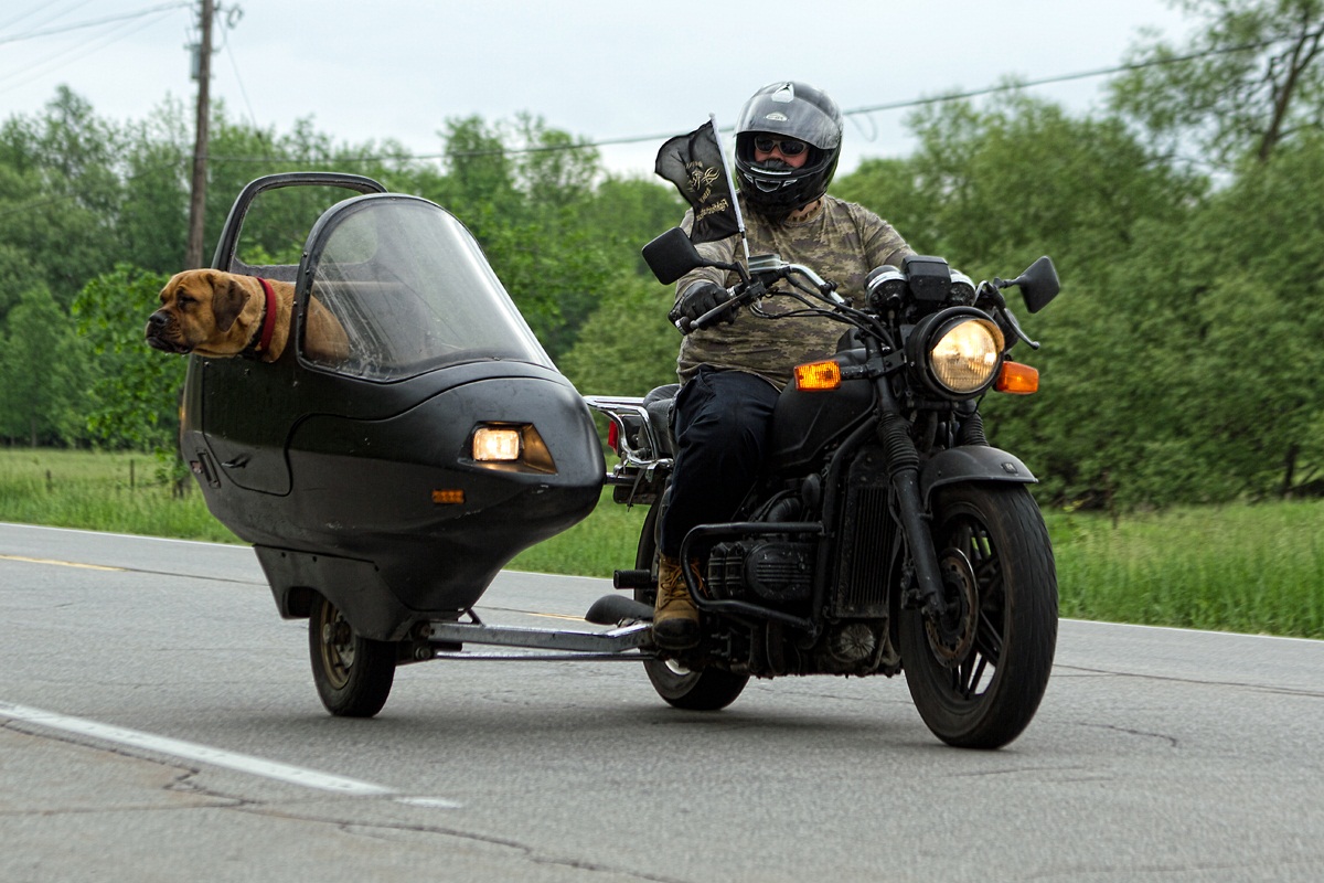

(@Ripster)
Posts: 4
I have a Fleximum attached to my GL 1100 I love this car as does my dog and granddaughters,I can get groceries,beer, travel with my dog (100lb Bullmastiff) she draws alot of attention when we are riding.Mine has 2 seat belts and can take an adult and child between thier legs, it fits my 2 granddaughters(6and 4) perferctly I paid $1500C for mine and had to fabricate a mount, it is very easy to attach to the bike I can attach in 5 mins. Of course I use way more gas when the car is attached and go through tires faster than normal. Also be prepared for a fight if it is windy.
Posted : August 10, 2013 8:32 am

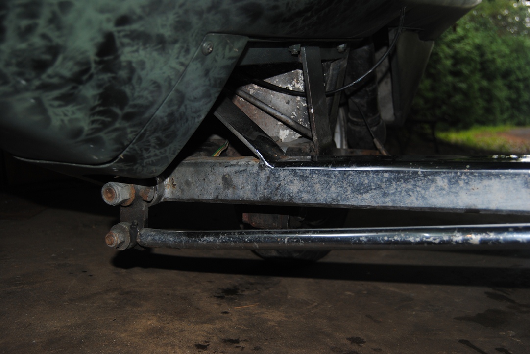

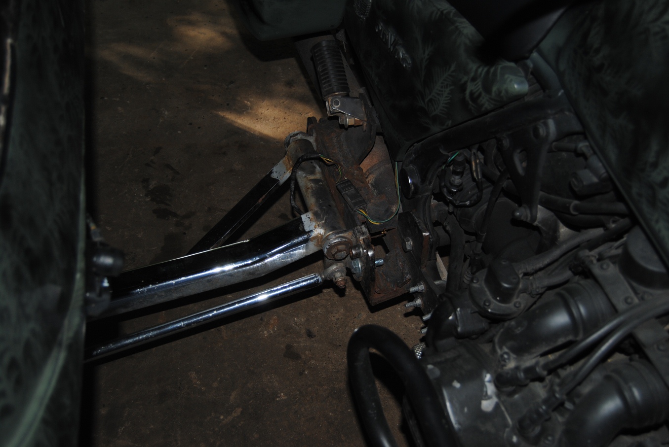

(@Ripster)
Posts: 4
Here are some pics of my linkage, I am interested to see Flamingo's rig,I have seen a few different body designs. they all had the same frame and linkage.
Posted : August 31, 2013 1:06 pm
So that linkage prevents sidecar to rotate in yaw axis, right? (no separate front linkage)
That is attached to the bike (Goldwing?) below the rider foot peg.
Very interesting.
Flexit's chain driven linkage is unique but Fleximum also got very clever design it seems.
I will copy it for my next build (if I ever do it again.)
Posted : September 11, 2013 9:43 am

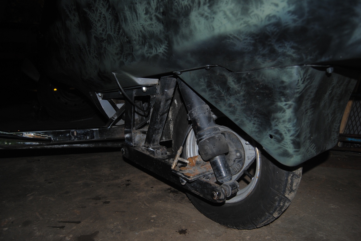

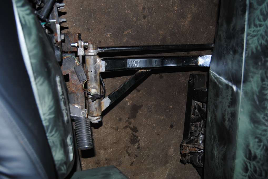

(@Ripster)
Posts: 4
Yes the guy who designed these was a very clever man,I had the car off last week and have some good pics of the sidecar frame ,if anybody is intereted they can contact me for more pics.

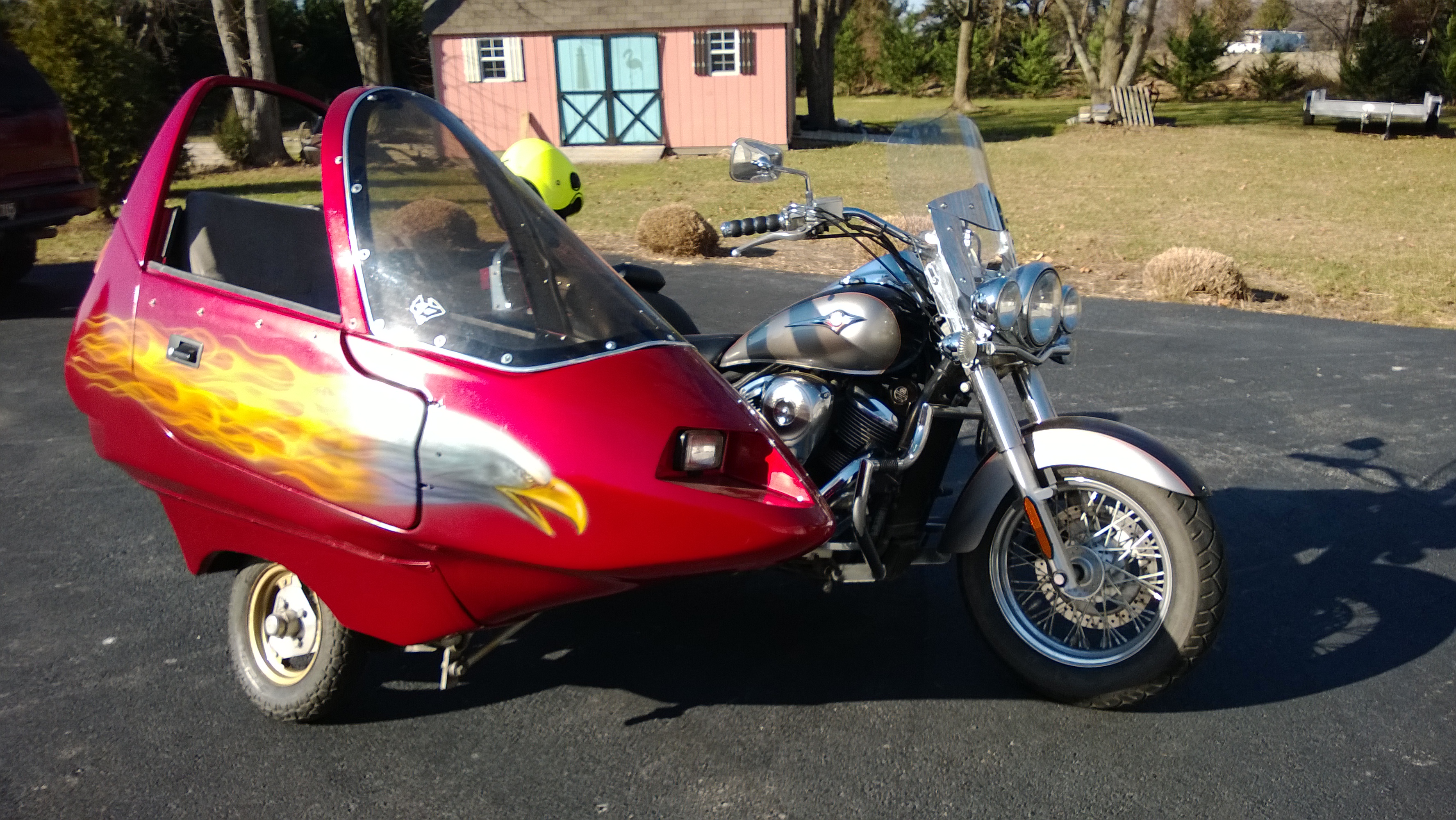

(@Flamingo)
Posts: 7
So, I finally got my rig back a few weeks ago and then the holidays and "polar vortex" hit. I have only been able to get it out a few times. Got a pretty ugly attachment until I can figure out a better one; it works, but I will have to move it back a few inches as it interferes when I put my right foot down; I have to inch up ahead of time and plan accordingly for a stop. It took a little bit of time to get used to the slow speed vibration, but cruising around 45-55 does not seem to be a problem. It's better with a person as I think the weight help. Getting used to cornering came like riding a bike the 2nd time, LOL. I plan to have a lot more rides completed by the time the rally is this year.
I read somewhere that tightening up the steering bearing helps to eliminate some of the slow speed vibration. Any thoughts?
will try to attach pic
Posted : January 11, 2014 2:32 am
(@Flamingo)
Posts: 7
hopefully a pic now
Posted : January 11, 2014 2:50 am
Nice!
Looks more comfortable than Flexit which kinda forces the passenger to lay back.
Unison leaners should not have any low speed vibration.
I had it once and it turned out that there was a play in steering head bearing.
After tightening it up to spec, no vibration.
Posted : January 11, 2014 5:01 am
