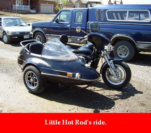

yes, the factory wheel is used, I found the lower profile /60/ size vs the /80/ was easier for suspension height and it didn't rub the body,..I run my hack with no balist weight or with my 5 year old @30 lbs in it , if I ran a full weight adult,...the 5 inch bike ground clearance set up would bottom out regularly as the car was designed for a 9.5inch axel height, but I was unable to mount the car that high on the low bike and keep wheel camber/caster correct, hope it helps, cheers....ps. I also added 2" on the frame to raise the body and relocated the body towards bike by 1.5" putting the tire flush to the fiberglass shel . I found it easier to set the frame and trail, then adjust body mounting to suit clearance, it took some time to get it right as this was my first rig build,

'02 suzi marauder 800cc,

nice ride

no, I unbolted the fiberglass from the tubular frame,..added a 2"x2" square tubing on top of the frame,. then re-bolted the glass down where it suited the wheel well gap with the maximum clearance all around the circumfrance of the tire. It took a bit of time but the results were worth it,..1 handed at 100mph is quite easy on this rig even without a dampener or front end adjustments on a factory rake. ,..car axel is 5 1/2" ahead of the bike's rear axel,...car too far forward or rearward effects handeling set-ups also. ..thanx for the positive comments on the look of my bike & car,..once I paint it I'll be a little more comfortable with it,...rattle-can black was the best I could do,..hehe cheers, crawf. ps. I believe that 155cm = 6 1/8" wide.

as I have heard mentioned here,...check the truck stops as marker lights from big rig trailers may be the same size,..if you remove the whole bulb assembly you could probably set up with a new, small body LED type of custom light..sorry, but I don't have any spares here, as for my windshield,...I fab'd it from a 4X8 sheet of lexan borrowed from work...hehe cheers, crawf.
Posted : March 23, 2008 2:43 pm
I yes a lot of people are making there own wind shields from your picture it loos pretty good. I will most likely end up making my own led tail lights I have a few ideas
